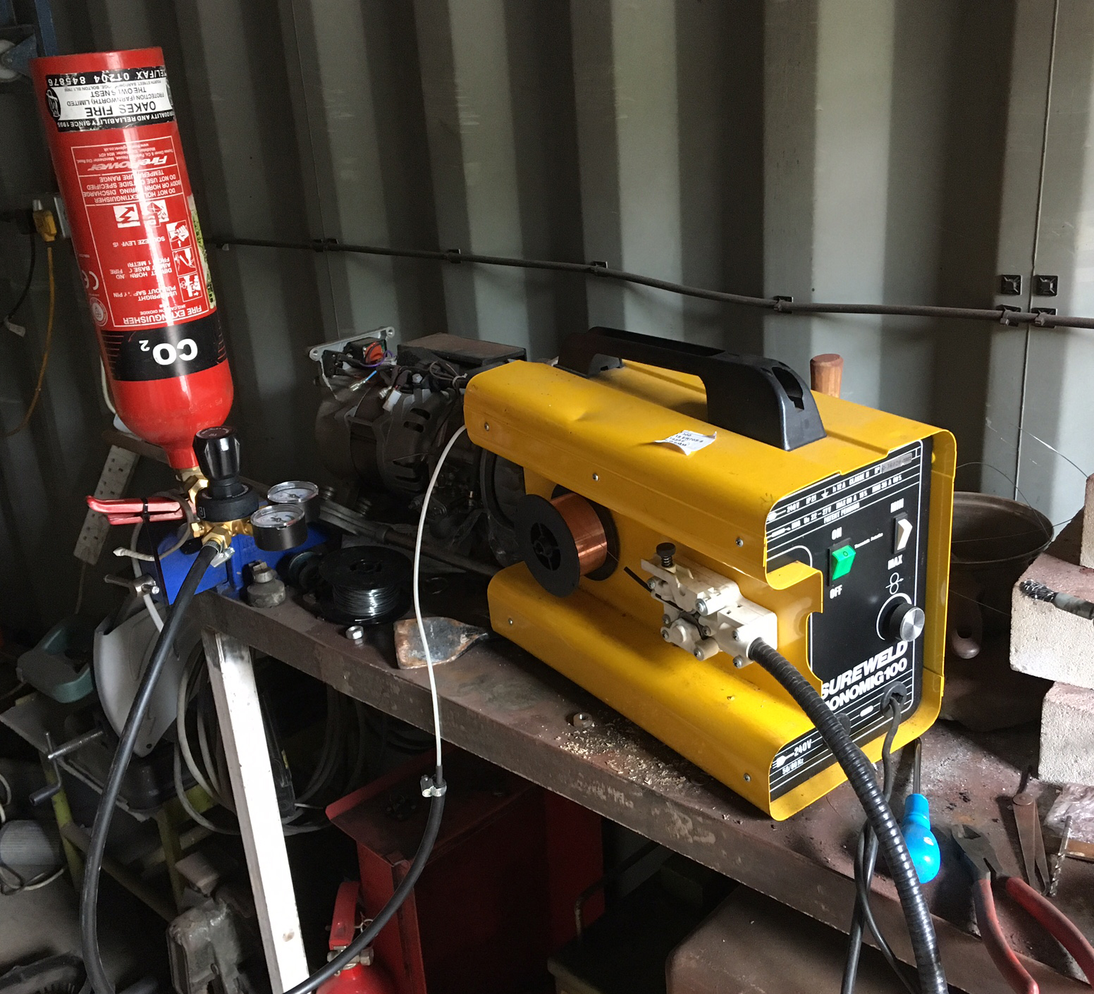

I'm using a C02 extinguisher with a C02 reg. Used it the correct way up and it froze so assume it has a dip tube so started using it upside down but it's still getting very cold although not freezing up but it's affecting the output flow by increasing it when it does get cold.
Running at 10-15lpm but when it gets cold this rises to 25-30lpm.
