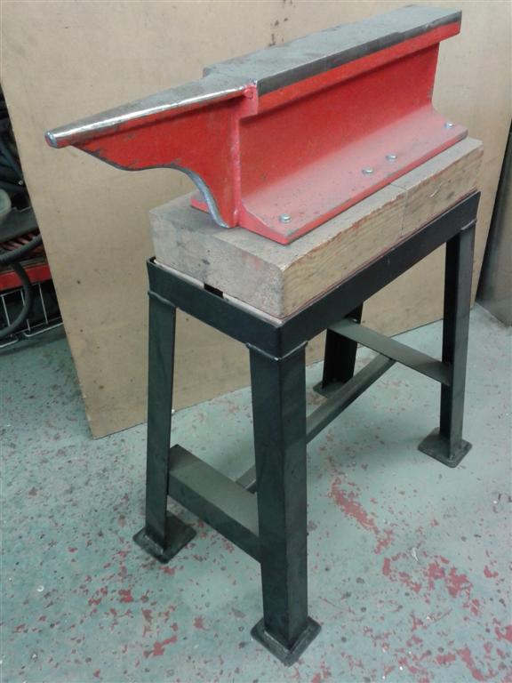

I may have posted a question like this before and the answer was no. But having actually used the anvil, the misshaped horn is a problem. It has a flat!
...and to make it more obvious:
So the idea is to build it up with weld. I pretty much have one of everything but I am guessing stick is best. Also the "best" welding rods I have are 4mm Filarc 56S: https://www.esab.co.uk/gb/en/products/index.cfm?fuseaction=home.product&productCode=410683&tab=4
I don't have the first clue whether or not they may be suitable or even ideal but I have enough of them and a big enough unit (Kemppi Kempotig 250 AC/DC).
First question is, will it work? The horn is cast steel on this anvil (I am pretty sure) so is not cast iron or high carbon. My other question being what to do about pre heat or heat soaking. Does it need to be pre heated and if not will I end up with a lot of stress in the horn. Also, would I need to stop and let it cool every so often?
