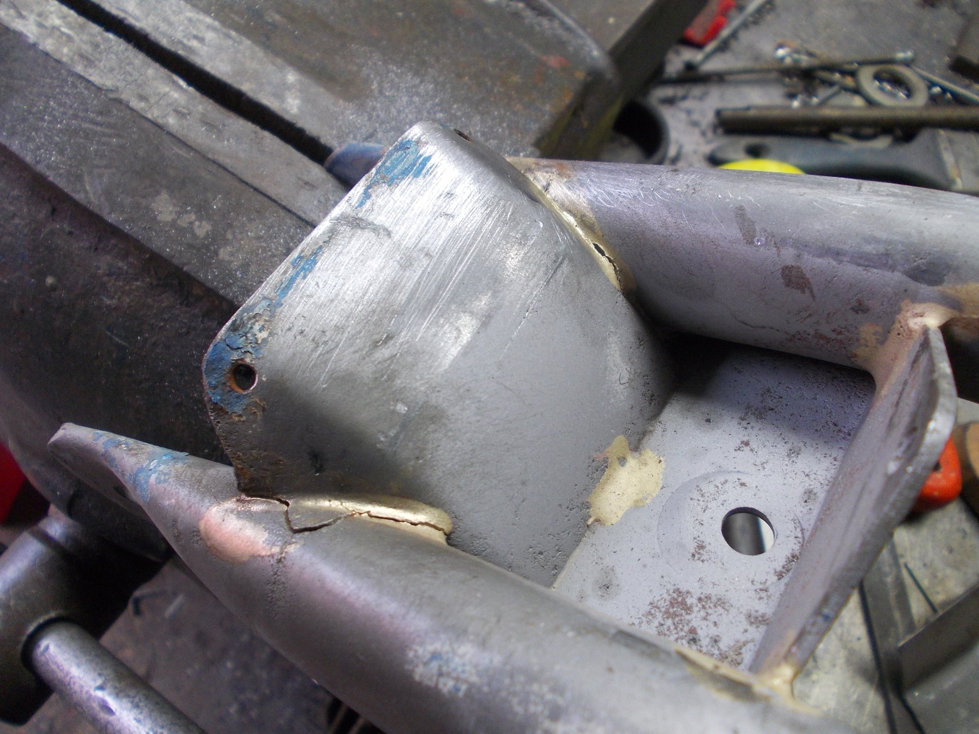

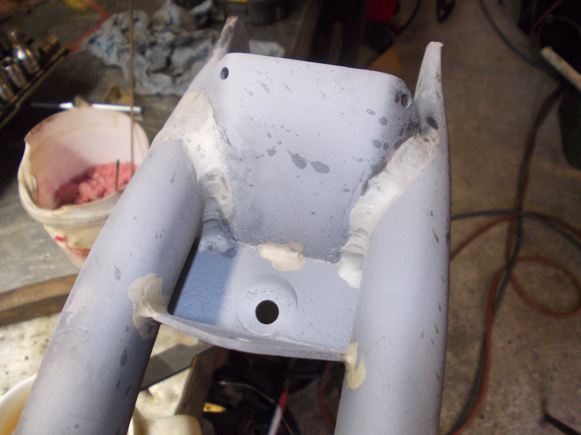

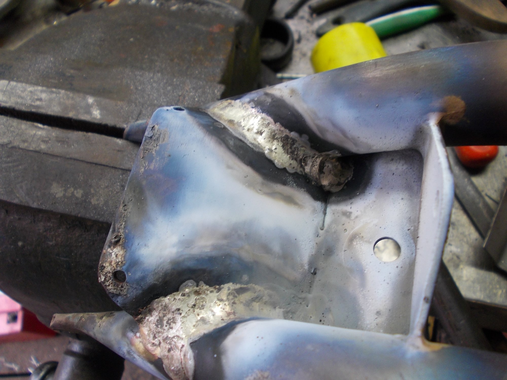

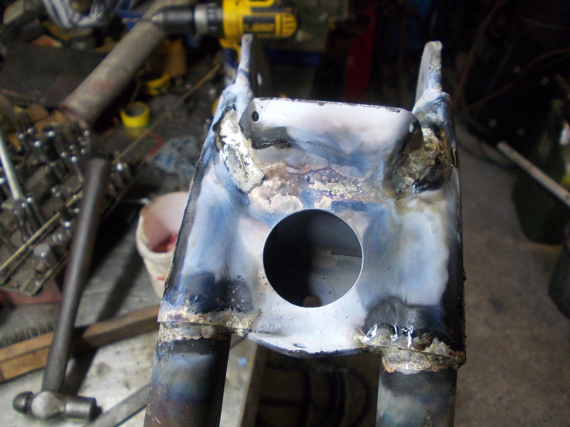

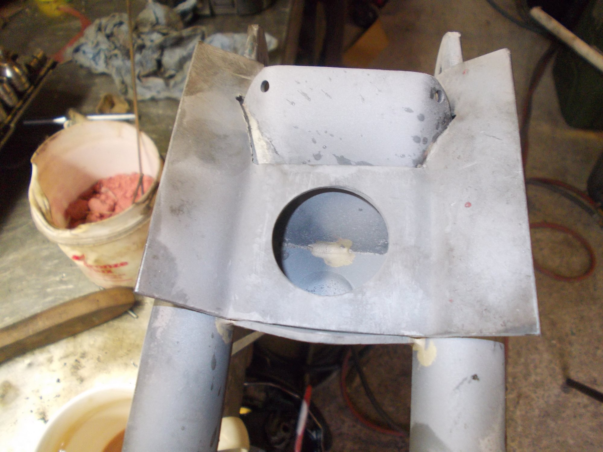

Siff bronze high nickel content for tubular bronze welding got this in to repair a Moulton bike rear fork it's been ages since i done this but it will be strong enough had to fabricate a strengthening plate out of sight on the under side the fatigue crack was well developed.
