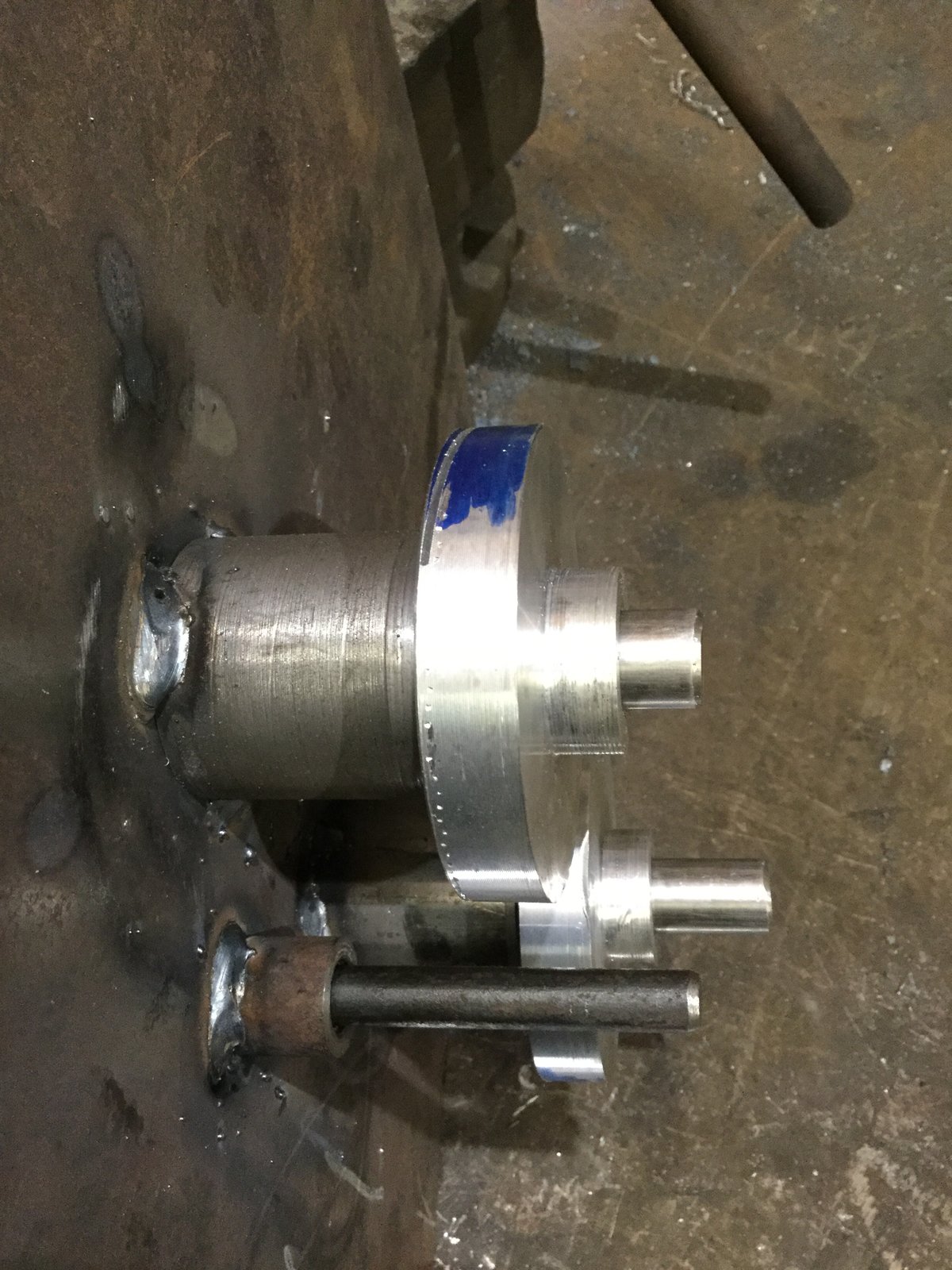

Seen a few of these on youtube and will be needing to do some annealing in the future, so thought i would make one.
It's mostly dictated by what materials i already have in the shed..............3mm sheet, 16mm silver steel, 16mm ID oilite bushes, 3" aluminium round bar.

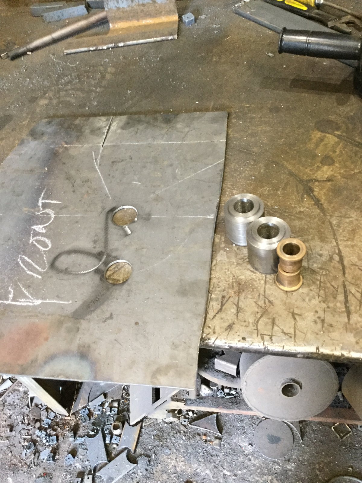

Started with some 3mm sheet.

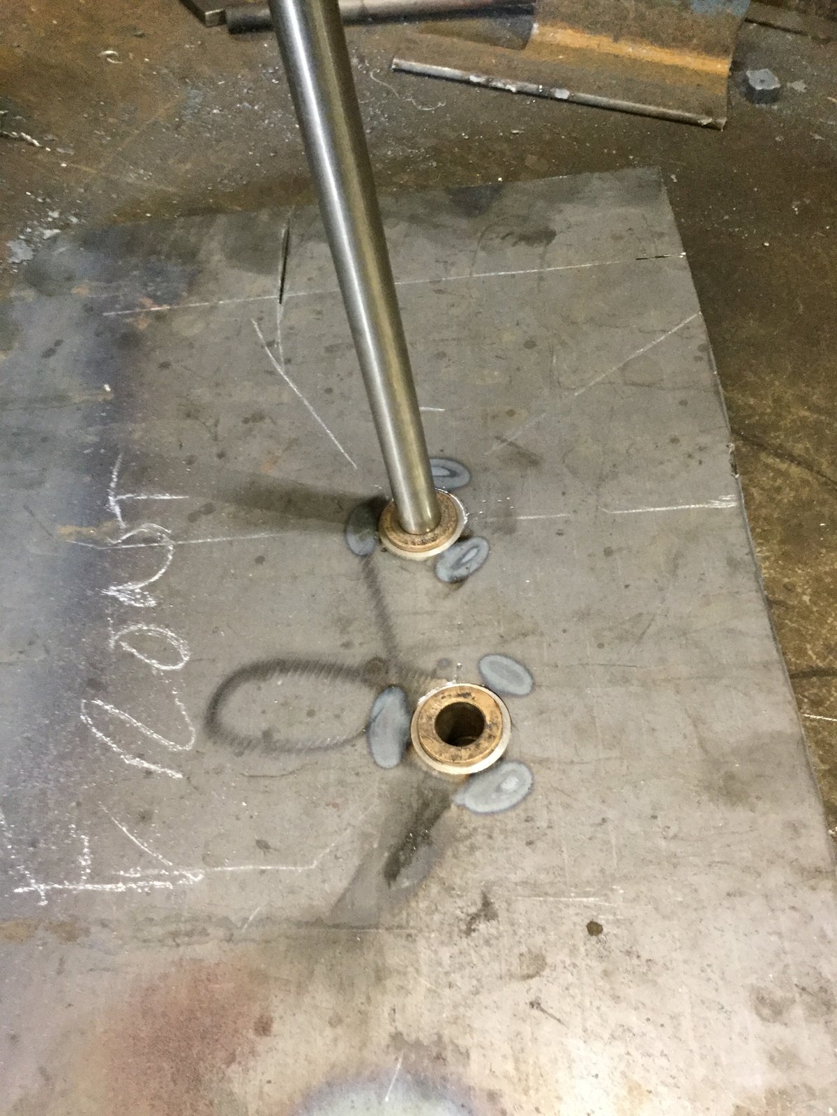

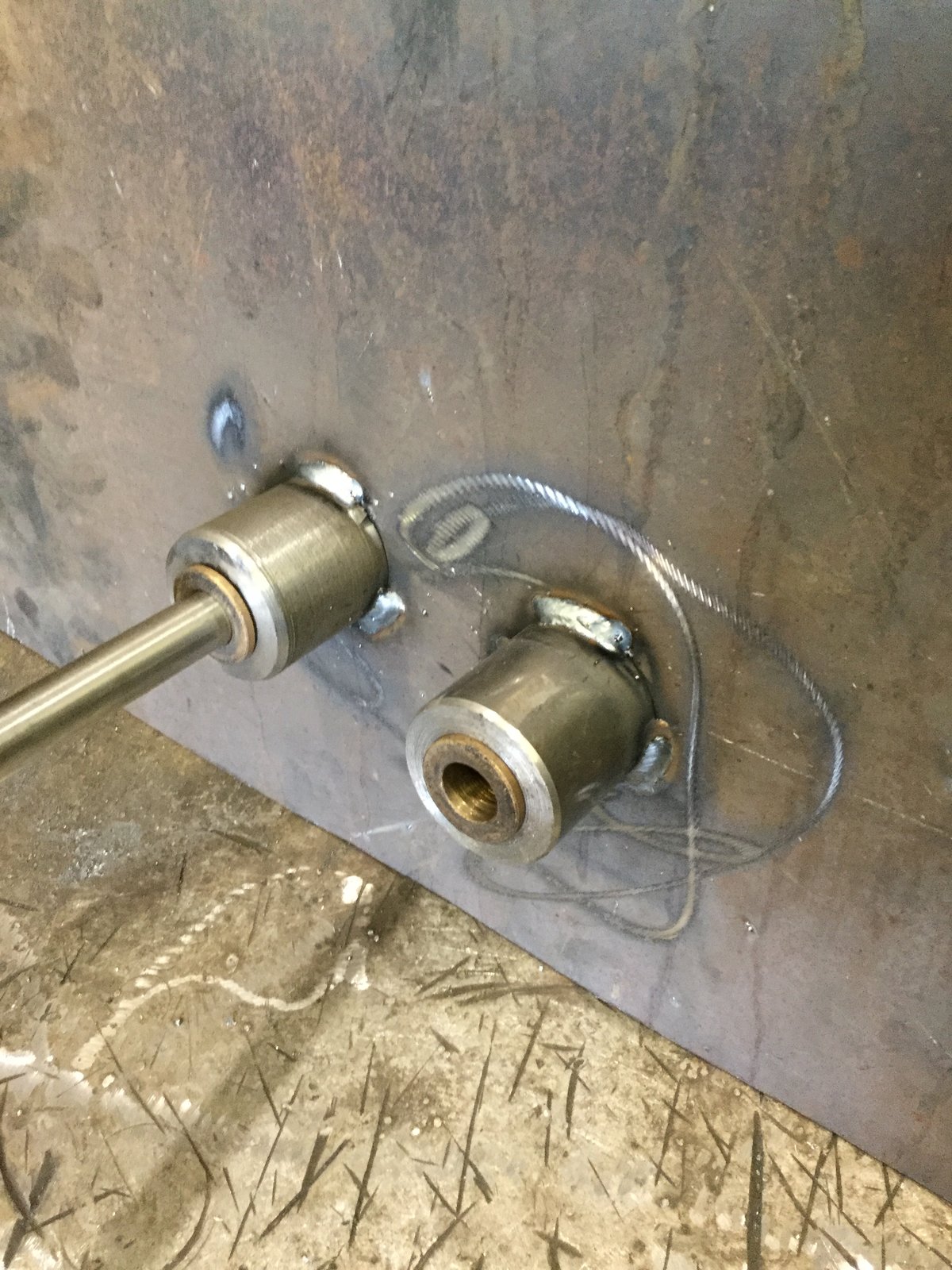

Drilled a few holes and turned some round bits to hold the oilite bushes.
Guessed a bit and drilled the holes at 90mm centres.
Welded the bits in
The oilite bushes are a little loose but will probably be ok.

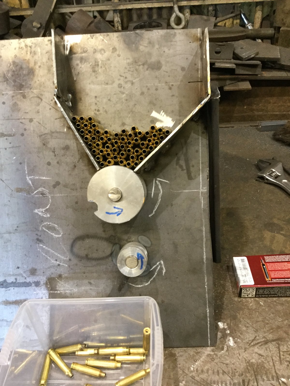

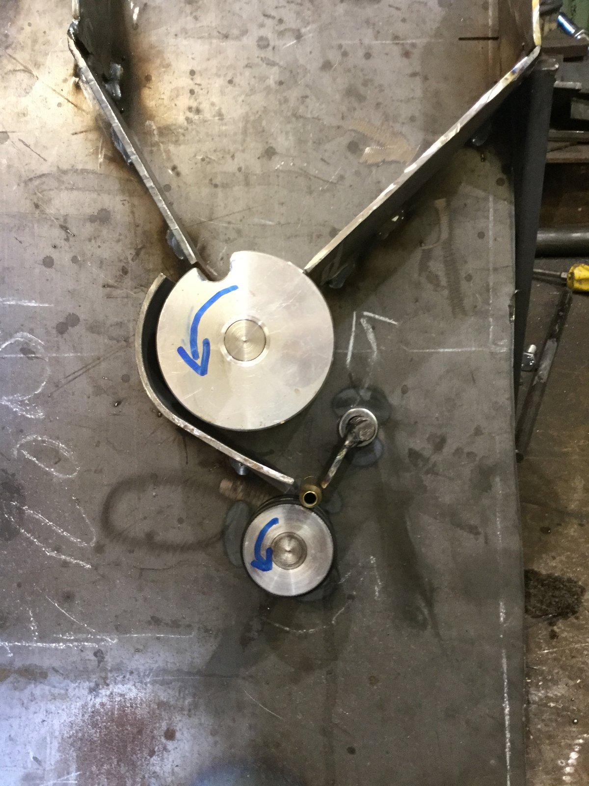

Turned some aluminium rollers and fixed to the shaft with grub screws.
The top one has a cut out to pick up one case.
The bottom one is knurled and i've also cut grooves for o-rings.

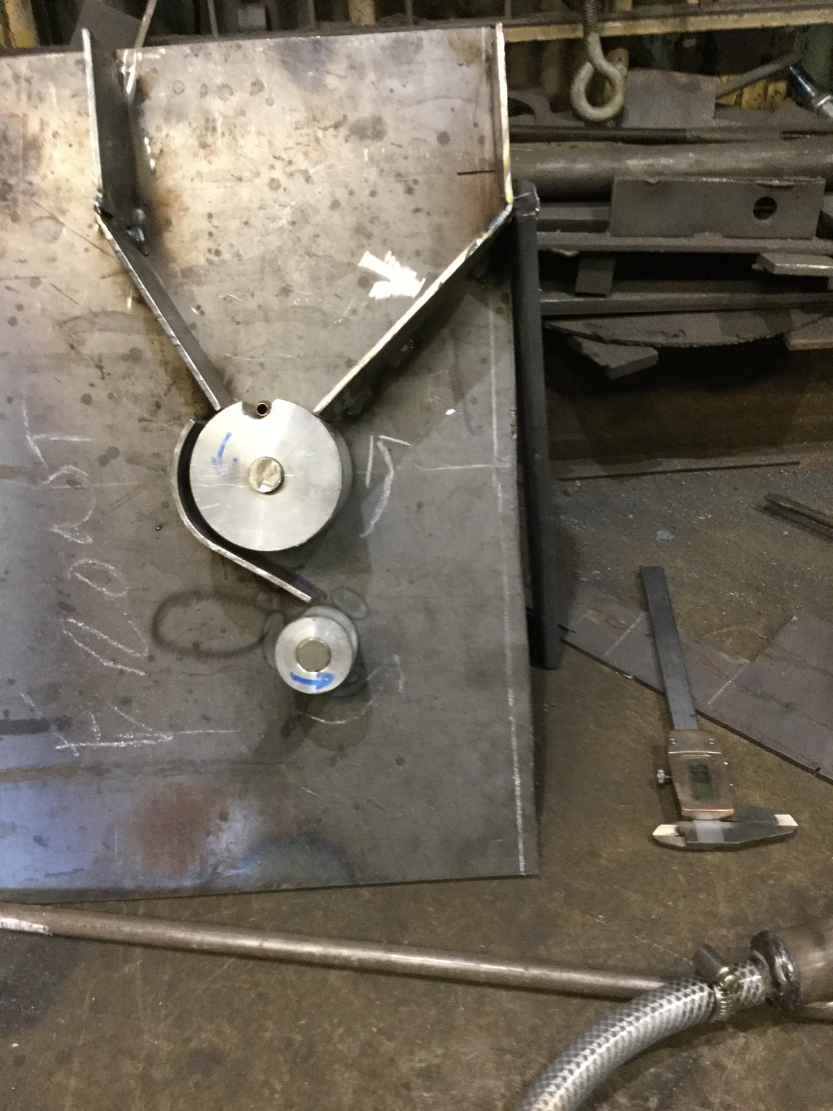

A bit of a hopper out of more 3mm.
A guide out of more 3mm
A "flap" out of 3mm stuck to a 10mm rod.

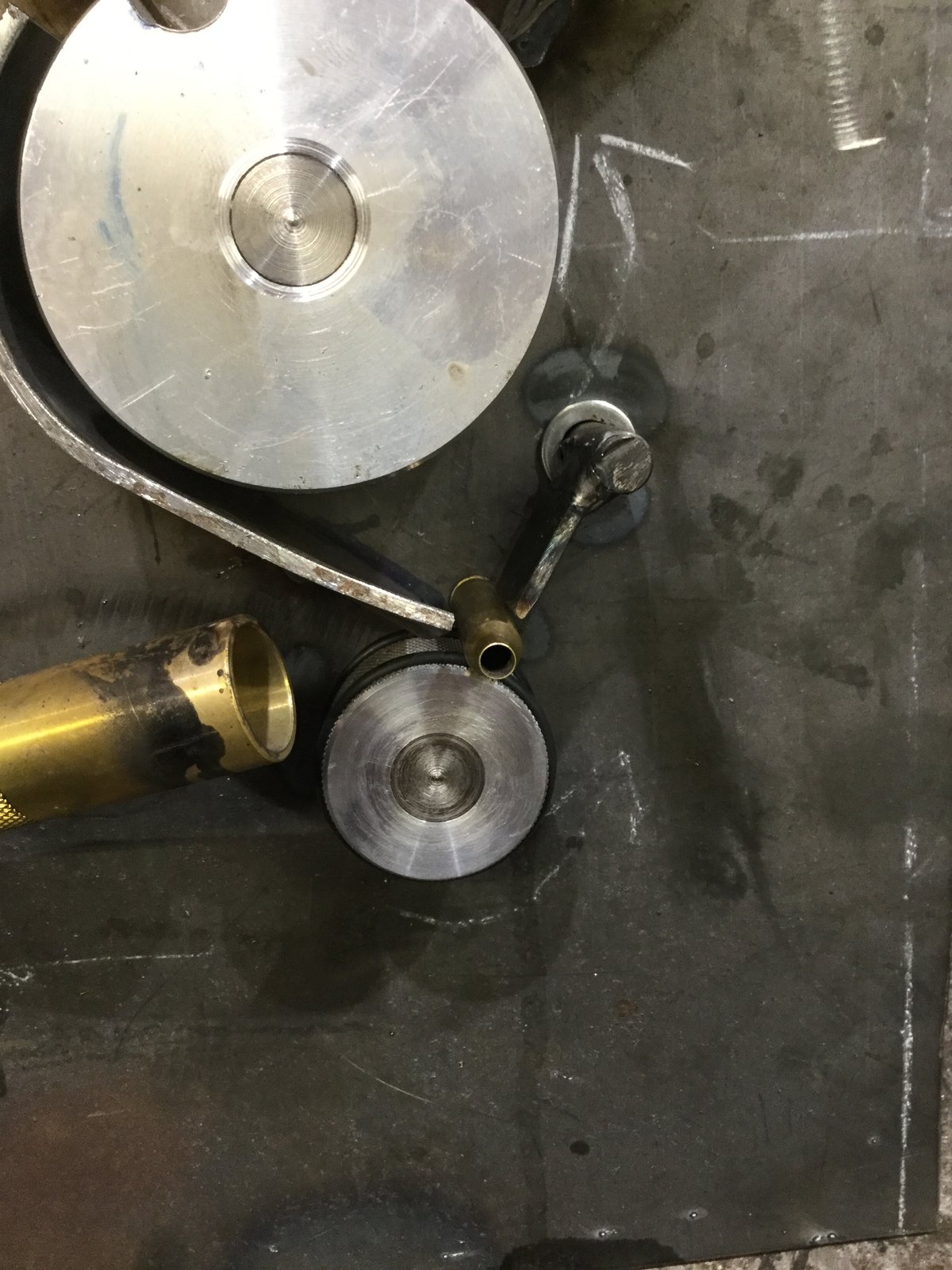

The top roller will be powered and the bottom roller connected to it with a round belt.
The top roller picks up a case from the hopper....Drops it onto the bottom roller which is rotating.
A blow torch is positioned to heat the end of the case. I'll need a smaller torch.
The flap will be timed to the top roller to drop the annealed case just before the next one drops.
