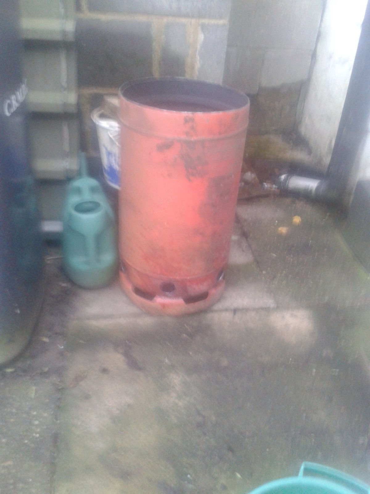

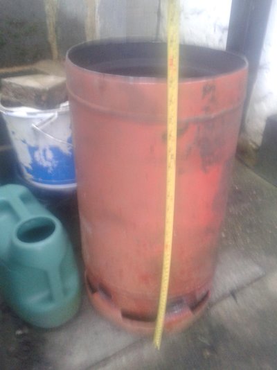

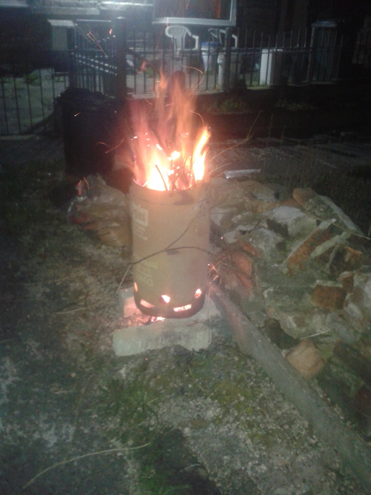

Im a skinflint so decided to build an incinerator out of an old gas bottle
dont want a drum one as too big as our garden dosnt need one that big just a smaller one
it cant be used for anything else as a damged bottle

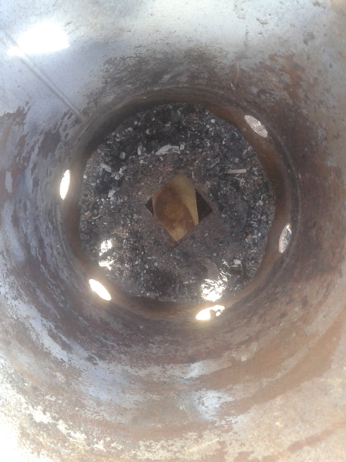

drilled 6 x 1 5/8" holes around the base cut the top off it
so ive got a 24" high x 12 1/2" wide incinerator

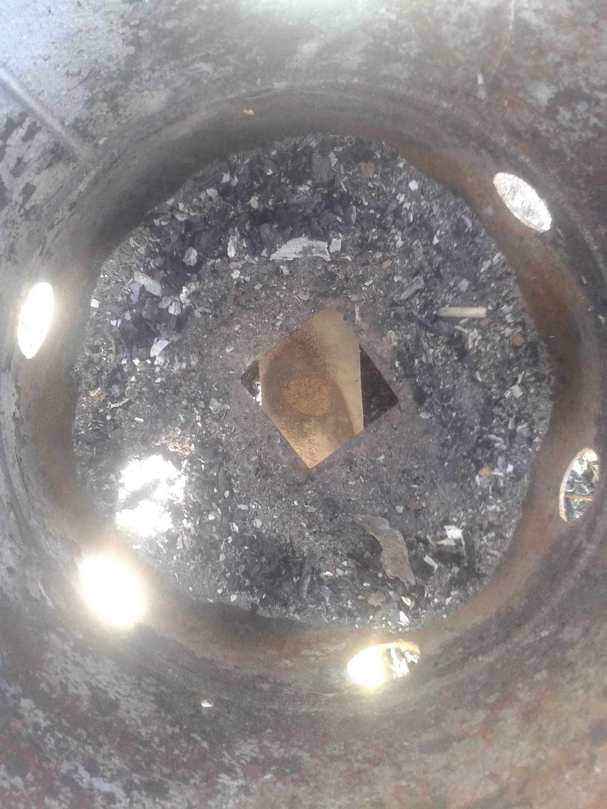

still got to drill the bottom hole, havent decided if i should use a sort of stand on the bottom so it can be drained of ash
im considering a second set of holes above the line inbetween the others buta t 3mm should last alot longer than the barrel type or bought version of insinerator
