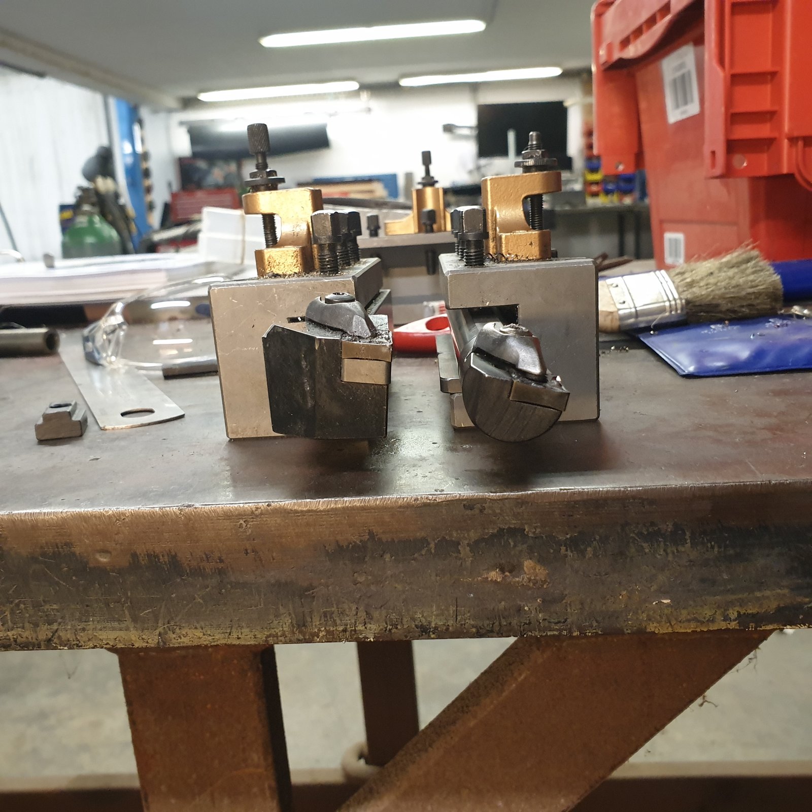

Key words there..... standard tool holder. Some boring bars have flats to use with this type. My Aloris boring bar holder has an opening to take a round boring bar, with or without a flat, and is clamped in place by a single crescent shaped bolt. The bar can be rotated as desired.The bars come with machined flats, so cannot easily be adjusted in a standard tool holders.
