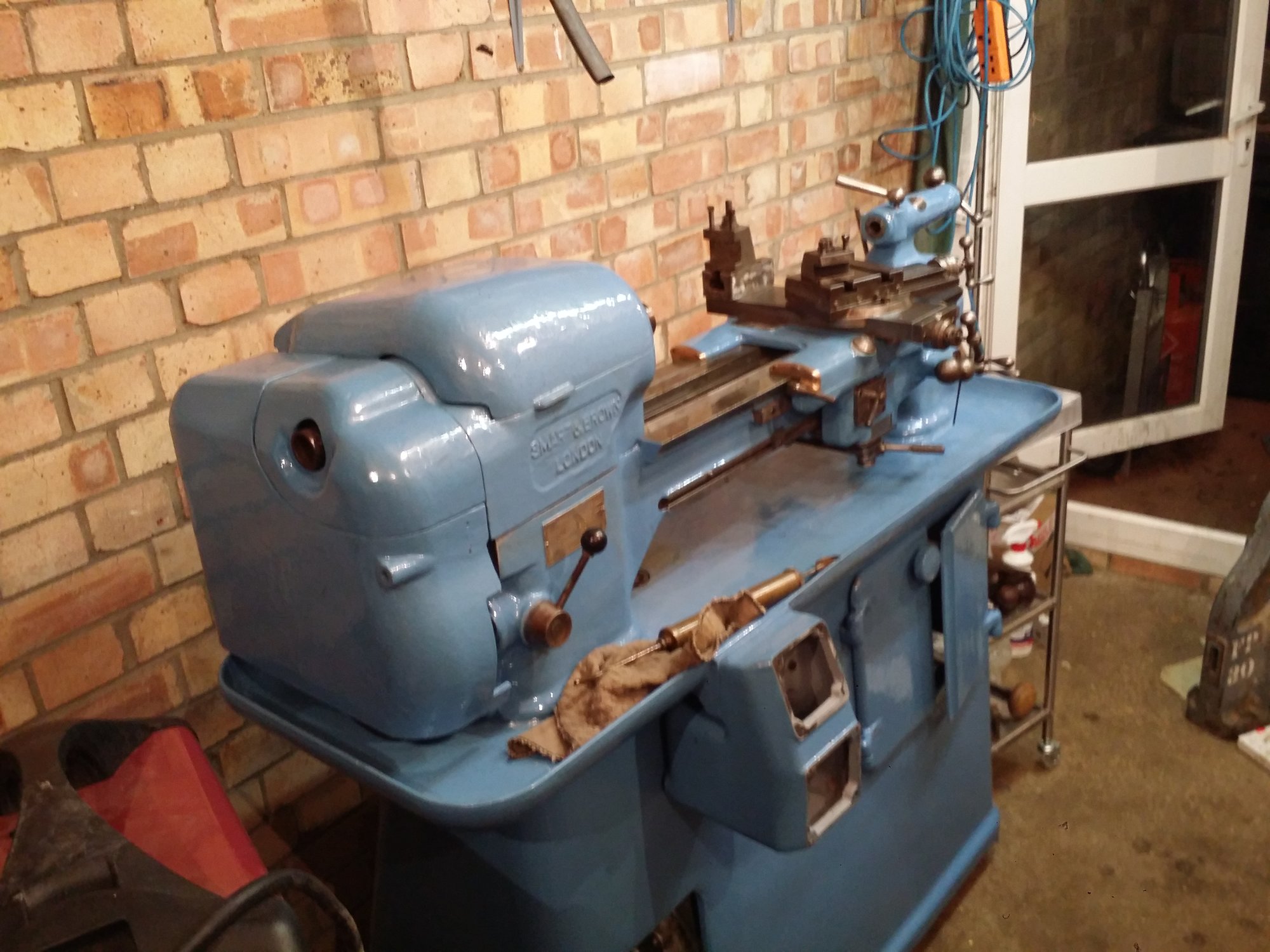

    Very nice. Looks very familiar too.
    Its the lathe my smart and brown M is based on.
    Not surprised its solid and well built if mines anything to go by.

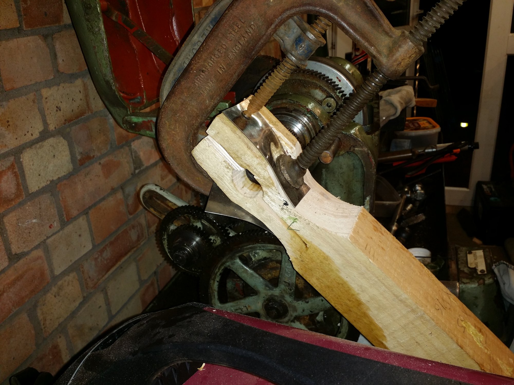

    Had similar isuea with my 4 jaw had to get inventive. IMG_20170813_210327.jpg

    Tried it.
    Snapped a piece of 3x2
    I spent a month googling and trying more and more desperate methods.
    I even welded a piece of 25mm shs to the face plate.
    The heat didn't loosen it.
    One of the issues is that there is a gearbox built into the headstock for the back gear, so locking the backend of the spindle strains the gears.

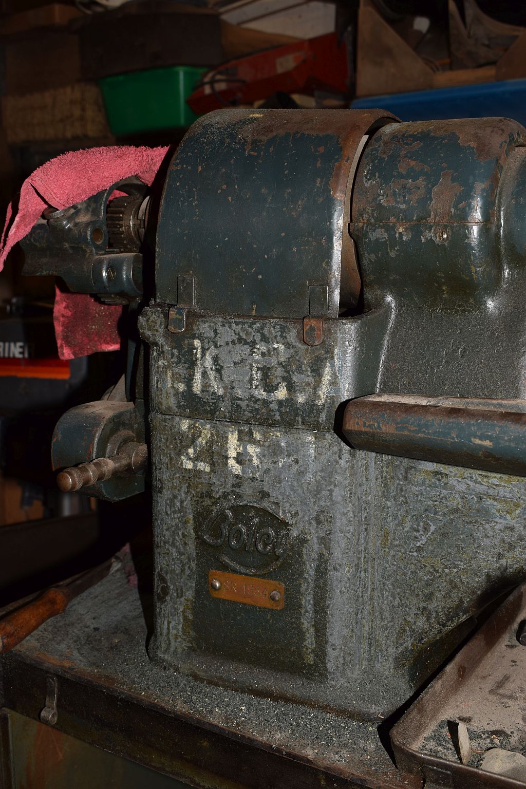

    Night shift scraping paint, its been repainted, just lightly blown over, paint comes off real easy. Original colour was olive green. Interesting discovery on the front of the headstock are the Faded letters in white paint
    R.K.C.A
    2611
    Just a feeling but im thinking ex army lathe? Explains the simple angle iron & steel plate welded bench its on Plus the fubared end on the compound slide with squaddies using it!

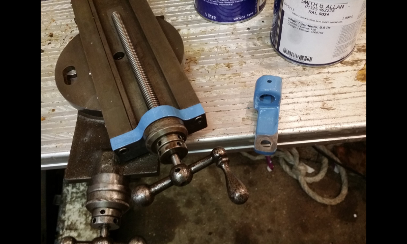

    Strip down continues, Took the cross slide off & there is little wear to its screw & nut, not surprising as the nut is about
    1 3/4" long Doesnt seen to be much wear to the sliding surfaces. change wheel banjo assembly & Headstock came off last night, It is clamped to the bed with two cam clamps. lot of gunk & crap under there. Turns out that the headstock & bed were originally scraped to fit & the marks can clearly be seen. Next job is to Pop it back on & measure runout on the spindle. If thats ok I may be talking to slideway surfaces re a bed grind.
    I am never going to make money on this machine but it doesnt stand me in much dough so im treating it as a learning exercise In fine engineering!

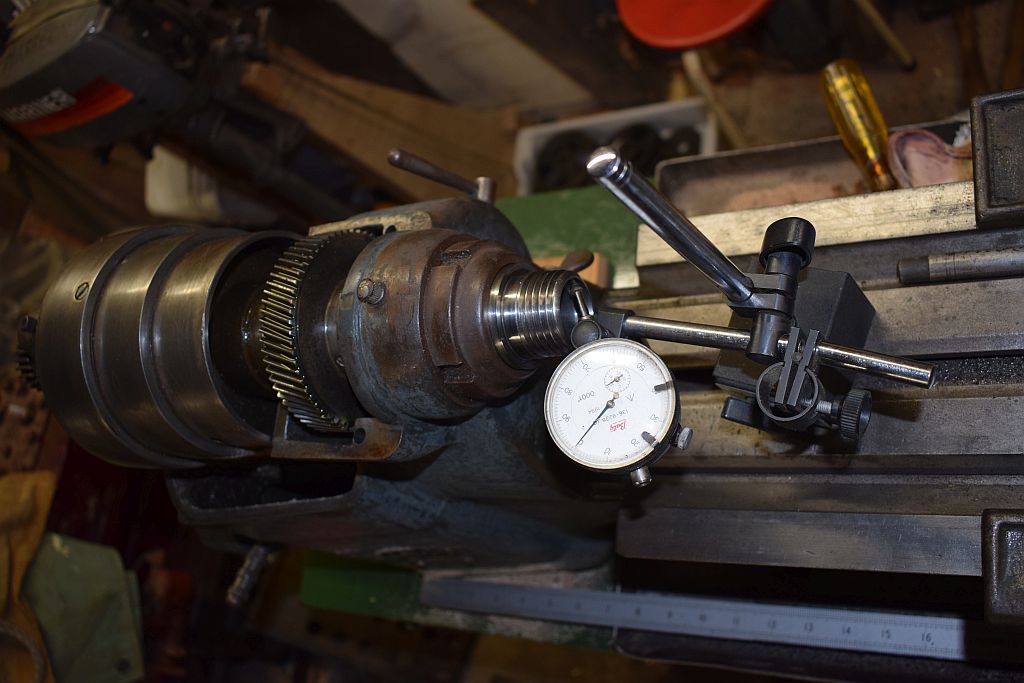

    Cleaned the bed & headstock mating surfaces & remounted the headstock, ran a clock on it. Seems to be about 3 thou variation on the register face but on the inside of the spindle taper there is less than one thou, same on the outside just in front of the register. I can live with that! test bar in collet runs true. Here are a few pics.
    Front of headstock showing old lettering.
    Clocking the nose.

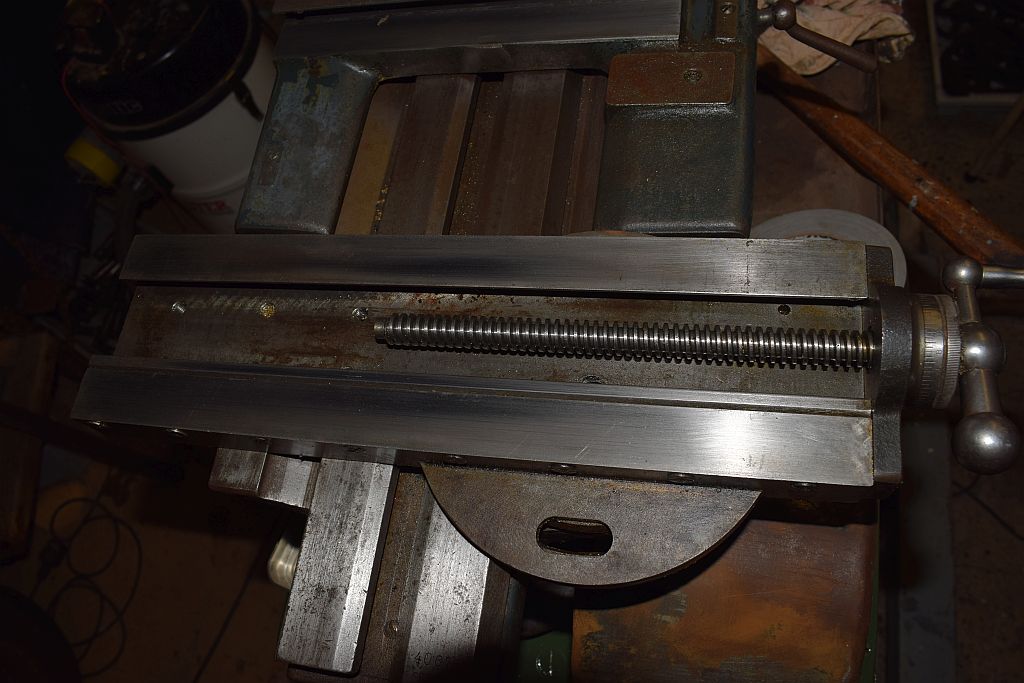

    Cross slide & screw

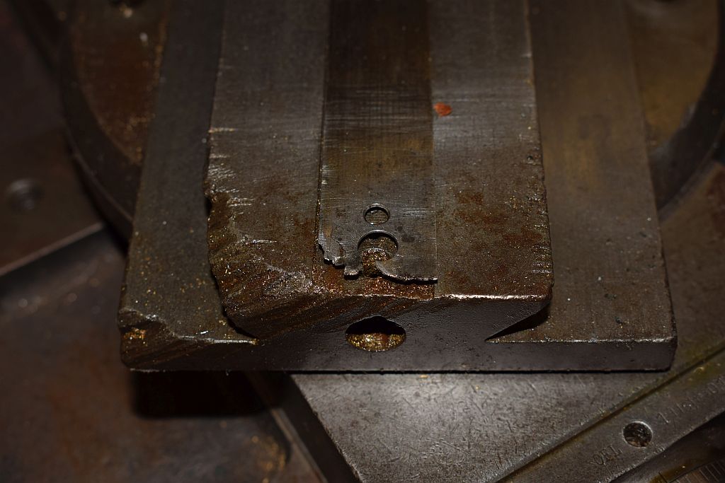

    Compound slide damage
    Ouch! This has obviously happened more than once. Dont suppose there is a lot i can do with this, any ideas welcomed.

    Near identical.
    Had similar crash damage on my compound. Left it alone after checking for high spots.

    Call it character & leave it be. :D

    Nothing you can do with that except make it flat on the way. Apart from being ugly it won't affect the operation of the machine. You might want to check the swivel isn't bent though.
