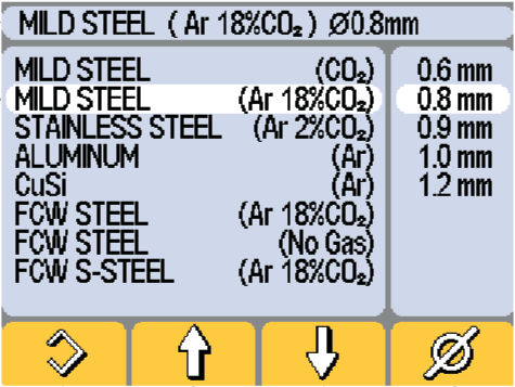

This is the gas and wire diameter selection screen on my Böhler Uranos 2000SMC MIG and for mild steel using either CO2 or Argon / 18% CO2 gas; I use BOC Argoshield Light which is 93% Argon, 5% CO2, 2% O2.
What difference does this make to my welding..? As a weekend warrior hobbyist with all the gear and
In all seriousness - what difference does it make? I do find that the synergic settings are 'hot' and I back the settings off by a millimetre or so; it does like to get itself into spray transfer mode beyond 4mm or so!
