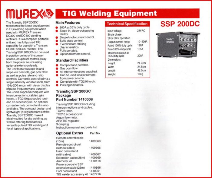

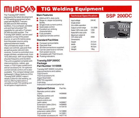

Many years ago I worked for a company that used transtig add on units in production welding bays, I refrained from answering your post because it was a long time ago and I rarely used them, being lucky enough to be in charge of half a ton of an ADR tig set,
However from what I can remember they were hooked up to DC rectifier sets and worked in a production environment running all day non stop.
This is a scan from an old BOC brochure, not the same model I know but similar.
Sorry, only just caught this thread. THF 450 was *only* HF and gas valve. Should run from 240V (check voltage selector on the rear). This unit was designed to be used with a separate contactor and suppressor unit in a 'stacked' configuration.
If all you need is HF and control of the gas, you may be able to make this work with a DC output welder but remember it's very old and may not work.
