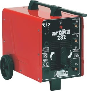

Hi There,
Can anyone help i have a Telwin Artika 282 arc welder which blows the fuse in the 3 pin plug, The welder will fire up and after about 30 sec it blows the fuse in the plug but doesn't trip the breaker
EAN CODE 800489755325 2

No, I meant what amperage are you welding at. It's quite normal for AC transformer machines like yours to blow 13amp fuses if you go above a certain amperage...say above 2.5mm rods...they need a heavier supply; but if it's blowing fuses even on low amps & small diameter rods (2.0mm/1.6mm) then it sounds as though you have a machine fault.
weldequip
U1 230v , I1 19a that little line on the plate tells you at 230v its 19amps. which means a 13 amp fuse will go pop. What i would suggest is replace the household plug with a blue industrial 16amp one. 32amps on the breaker is fine if it blows that, then there would be trouble.
I would think a 13 amp fuse would work up to around 120amps after that there is to much current draw
Unusual that, you should be able to use small rods at low amps without blowing the fuse. Do you keep sticking the rod to the job? That could cause the fuse to go. I'd phone the dealer & see what they say.
weldequip
If i remember a long time ago, when i used to own a similar sort of machine (very long time ago, been an inverter man for about 8 yrs now) they were fine up to around 120amps anything above that and t popped the fuse
