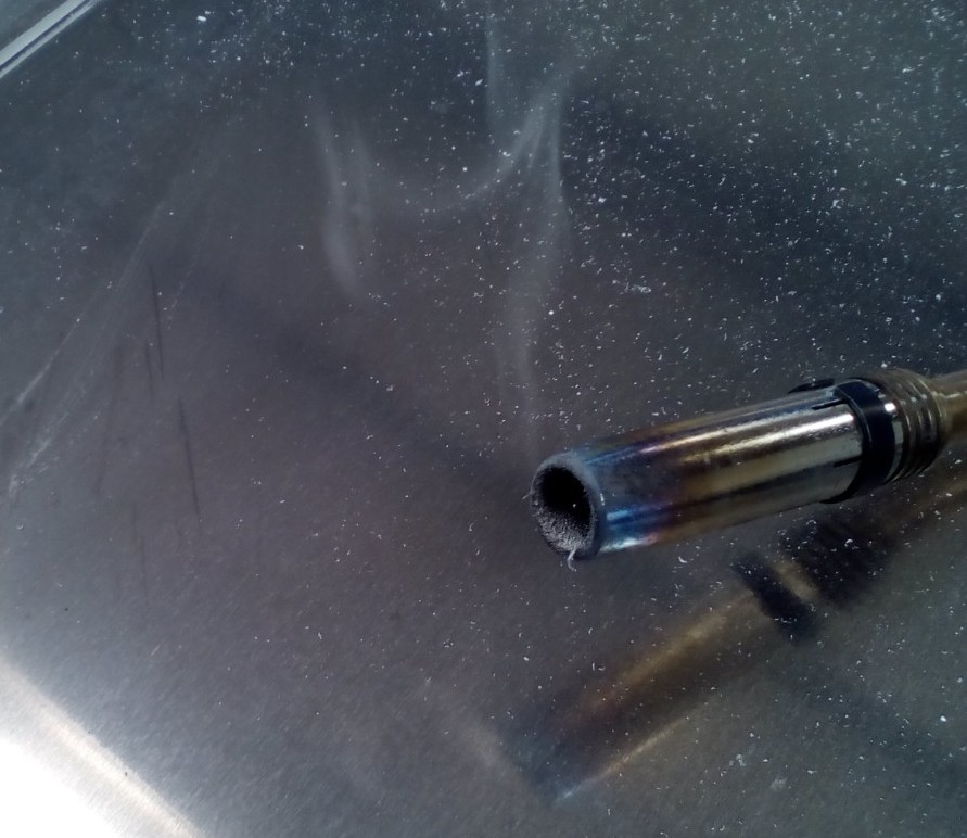

Another thing if doing a lot is get a ceramic diffuser for the torch rather than the composite material ones. If not then you will get the diffuser breaking down due to the heat, here is one of mine starting to burn up after a short while, you can see the smoke.
