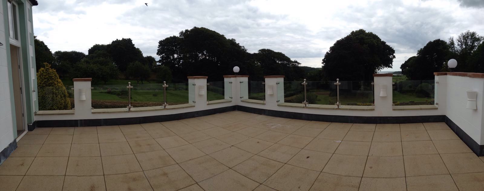

    Due to the design of the wall below (concrete filled cavity wall) and the fact the glass had to overhang the slab edge to be non-scaleable these bespoke posts were made, kinda designed it's self this job...
    Bit 50's retro? I'm pleased with it, my first big stainless job in the bag..

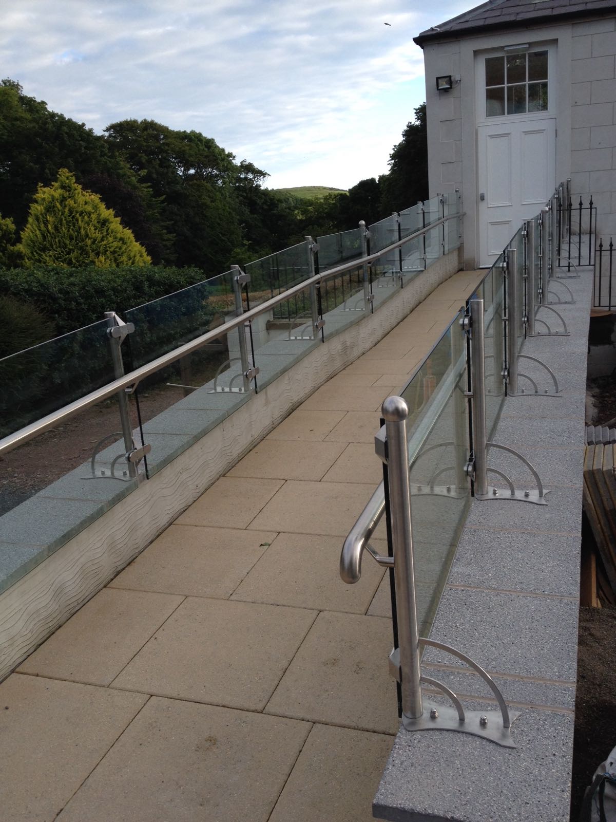

    this is the walkway on the other side of the building
    lots of horrible angle changes in the ramp to deal with (regs require a landing half way down)

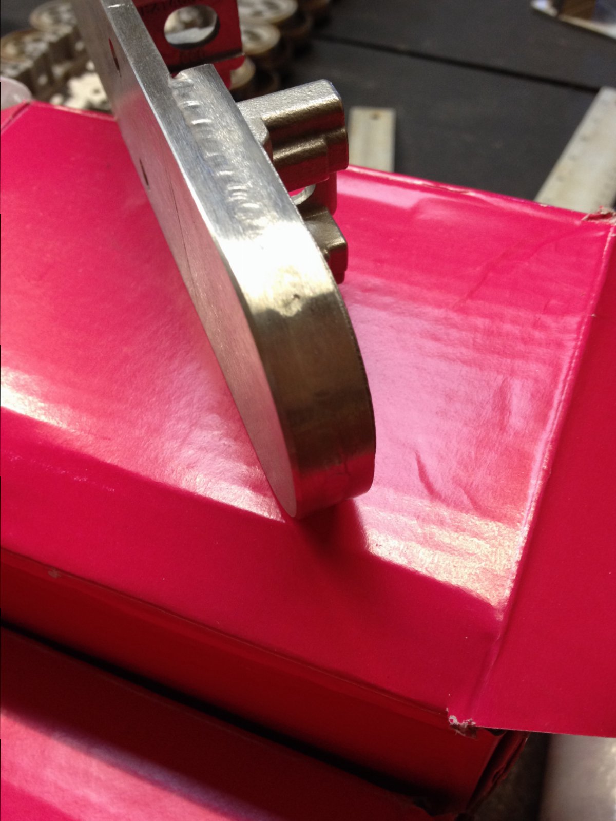

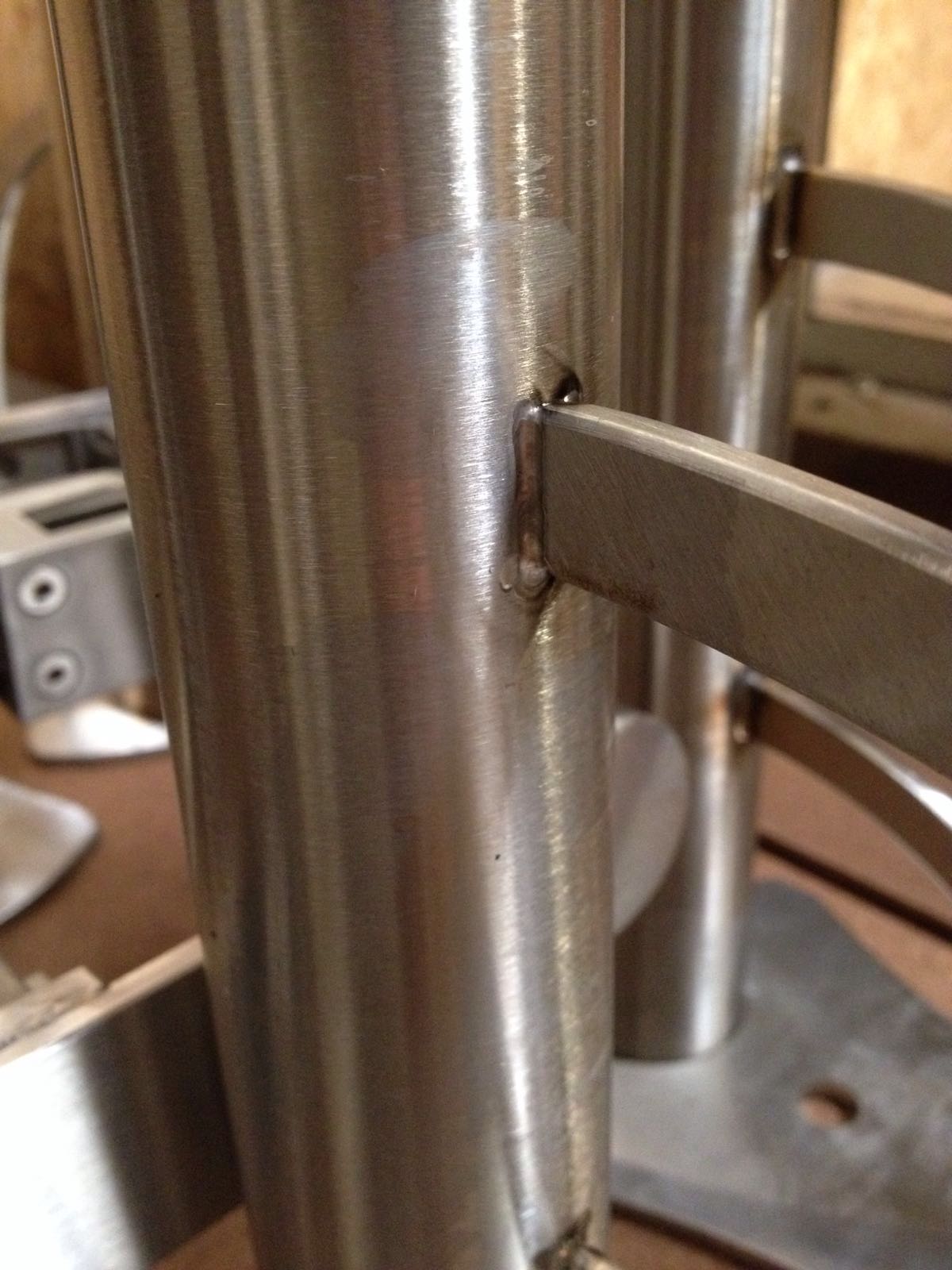

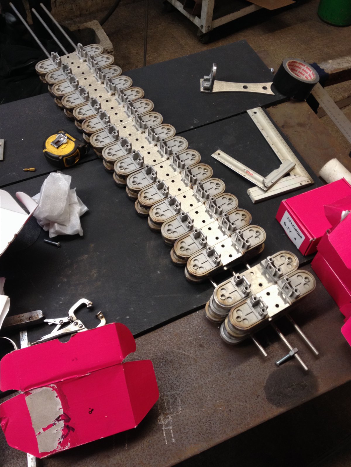

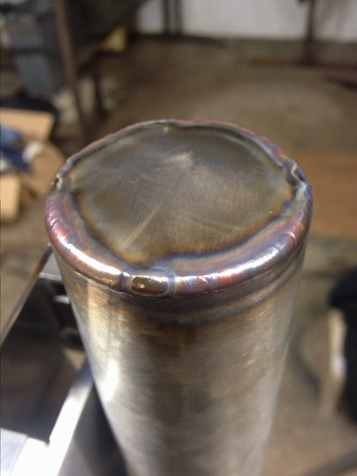

    Almost there with the caps, but still required a little touch with a scotch and paper wheel. Loving the gas lens at this point :thumbup:
    Any pointers/tips/comments welcome,
    J
