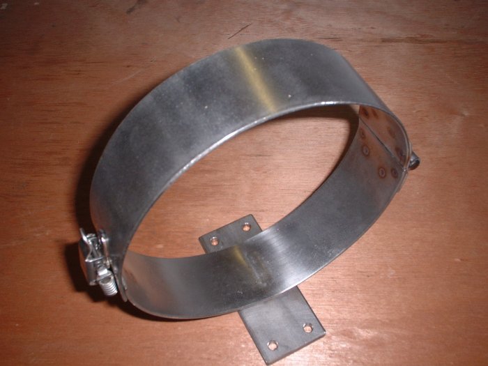

40 x 3 Stainless is easy to bend, how many are you doing, if its only a few you could make a template or mark it out on a piece of sheet, and bend it in a set of horns, which is just two pins welded to a plate, you may want to make it slightly longer and trim afterwards as you will get a flat right on the end, heating it is the last thing you want to be doing, if you have a larger quantity to do a ring roller is the way to go.
These were bent by hand in horns,
