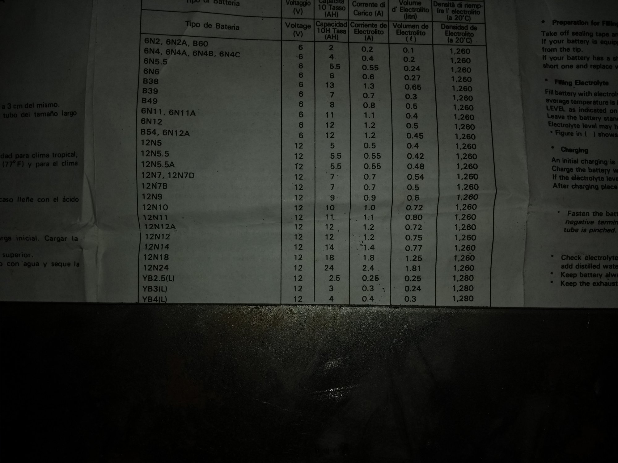

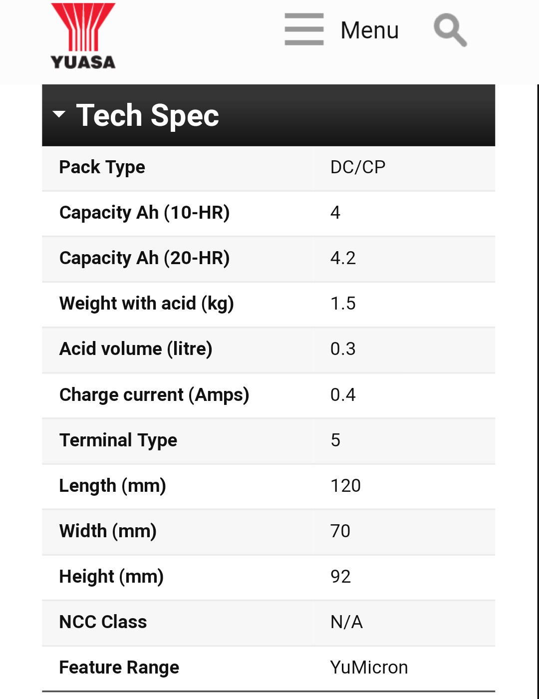

View attachment 139527 Got given a new 12v motorcycle battery with acid.
Instructions say initial charge 0.4.
I take it I would need a special charger ?
The last new one I had only needed 2 hours to gain charge after the acid was installed

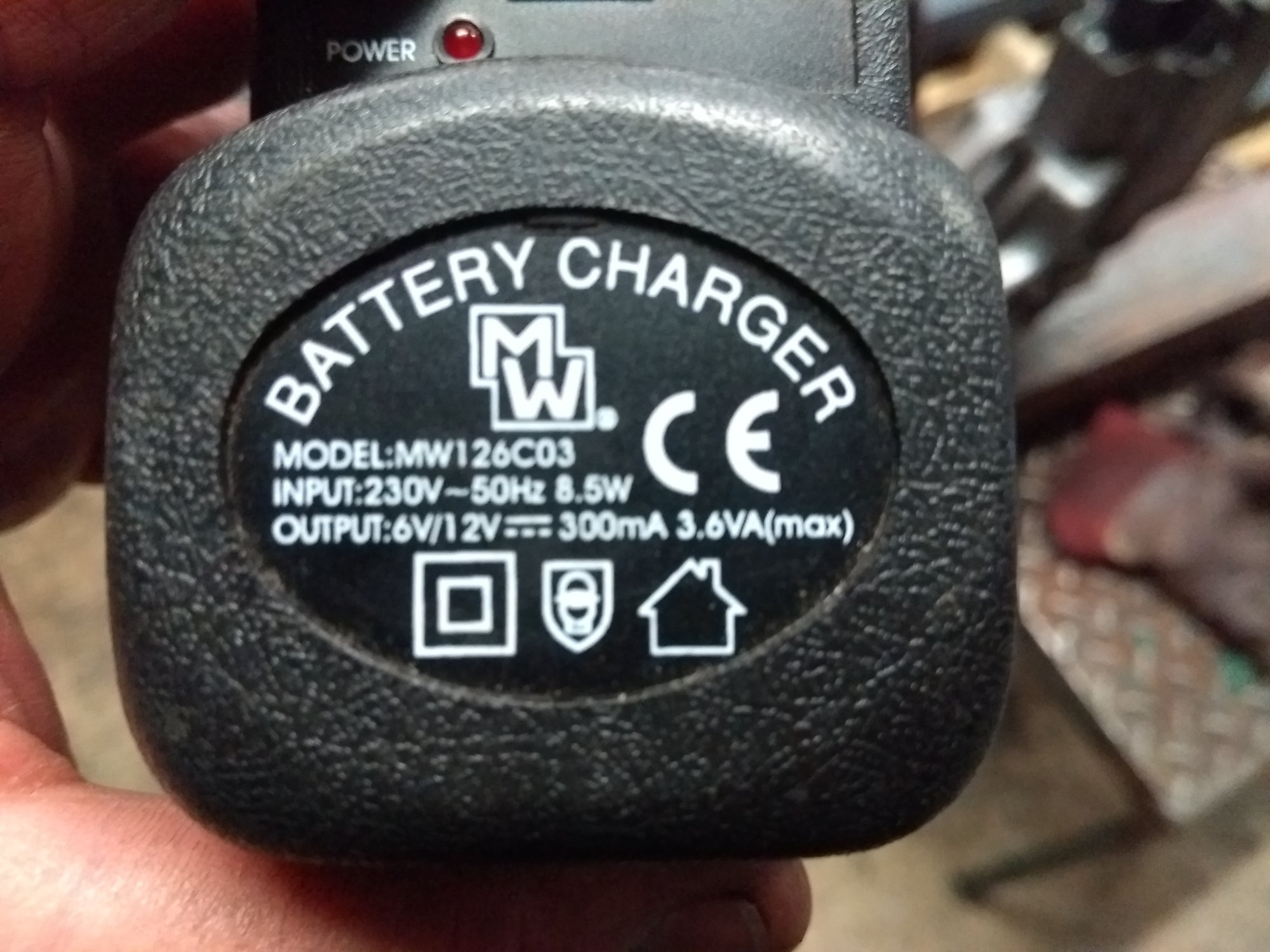

So are these milliamps?Mate brought this in , would this be any better?View attachment 139578
