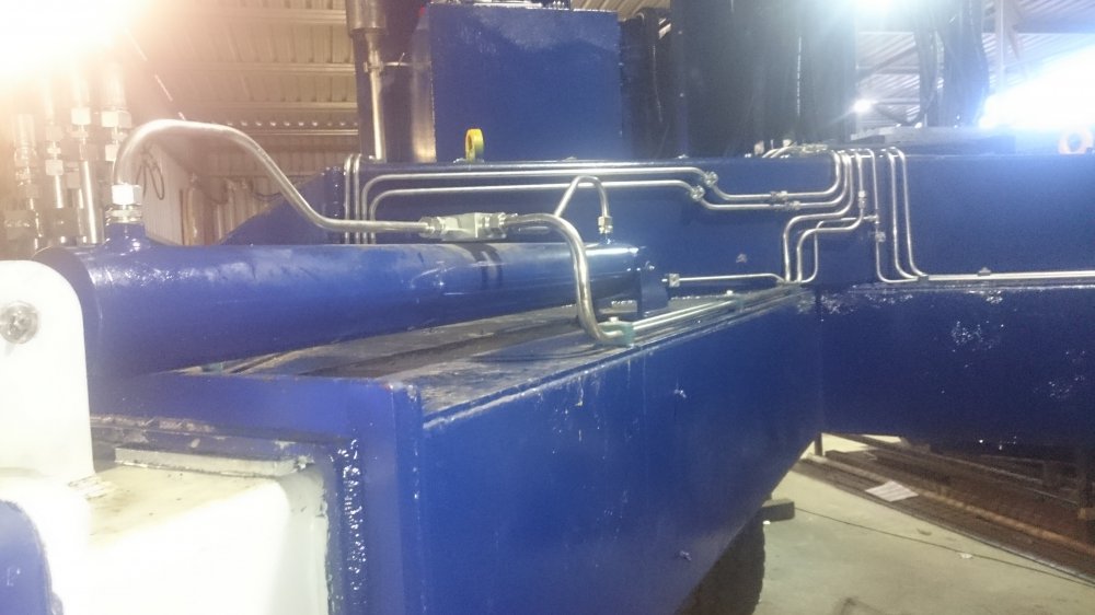

are you trying to bend the flat round a radius ir a tight corner.... if the latter you are looking at something like 8-10 tonnes force required maybe more... air bending in a press brake you would need the wrong side of 70 t/m with a 100mm v
