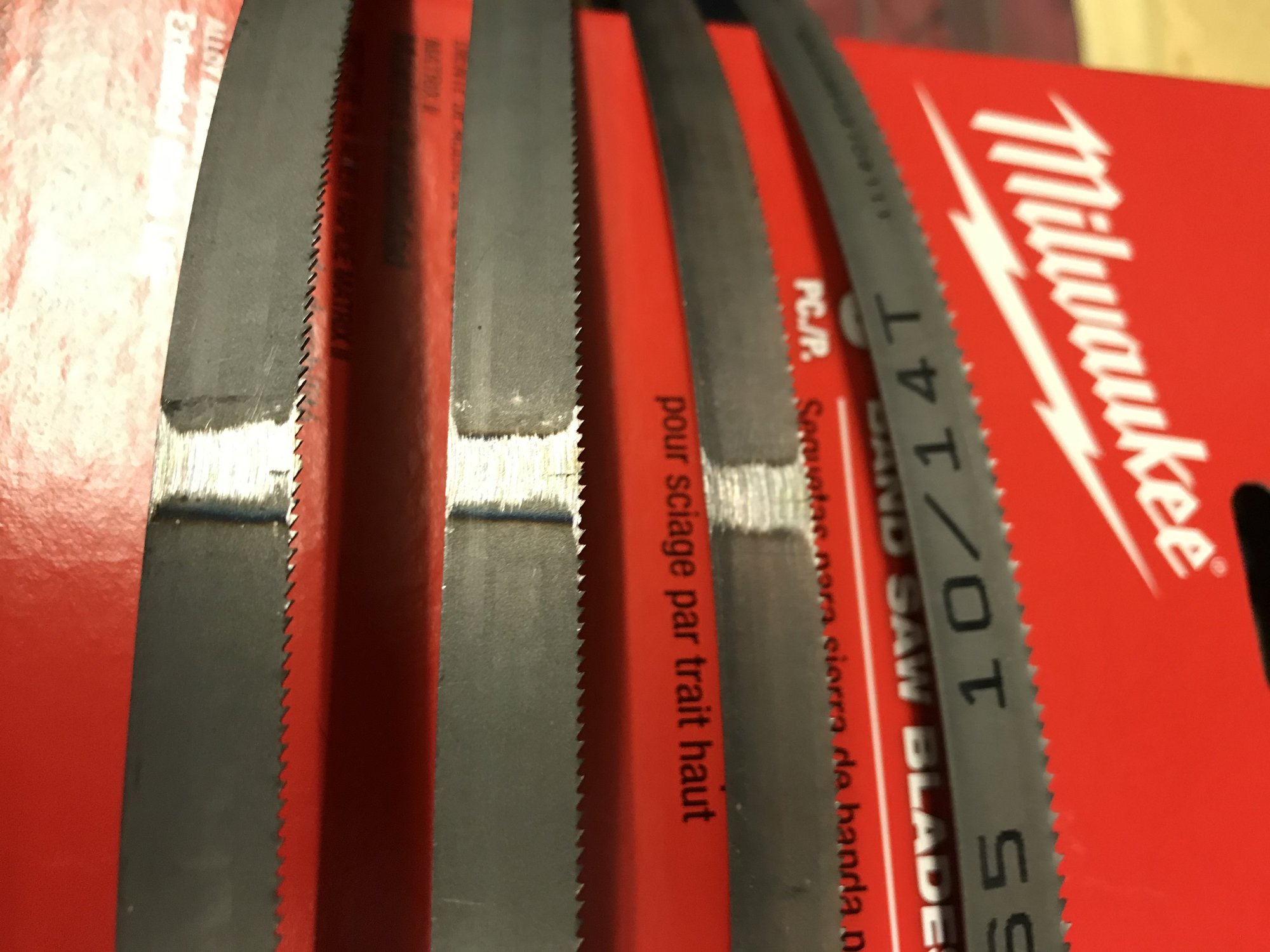

Surprised and disappointed when closer inspection of the Milwaukee blade join on how poor they are, check the pic of the join & poor tooth cut and what appear small cracks at the join.
The 1st two are unused, the 3rd one ive used a fair bit but has started to kick worse over a bit - 18tpi. The 4th one in pic is what came fitted 14tpi 1mm taller and about .3 thicker at 1mm. I cannot see a join on that at all! I've just refitted that and no kicking through inch sq copper. So even compared to the original workzone blade those Milwaukee ones are rubbish.

@Gragson - the Milwaukee blades I bought fortunately don't have the cracks, but put a straight edge against the blade and they were all out of line, unfortunately I was new to bandsaws, if I bought them now I would just send them back.
@Kram - take the blade off and check it for straightness along the back edge (other edge to the teeth).

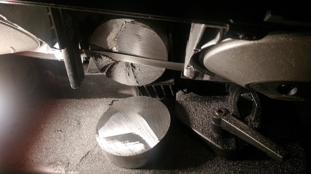

I took grinder to the back of blade and smothed it right down, the knock is still very there, but it no longer feels unsafe. Therefore I tried to cut some tough 100mm bar.
Thinking it'd take a while a small f clamp holds the trigger on. I used lowest speed and it literally took an hour. This would have been fine if it wasnt going off ******, trying to jam or rip work out of the rubbish vice.
The angle is correct on the horizontal axis problem is the vertical is 10-15 degrees off! I dont know if its the blade bending or just the mount.
Yes it is a lightweight machine but its the same on aluminium. On low speed the motor was not even warm so I dont think its doing any harm cutting solid bar.
Im going to try on 100mm wood posts, see if its the same, and look at the pivot to see if its bent.
I had to use some spacers on my vice to get it to cut vertically square, that was cutting 2" steel box with a 10/14 blade and I made a different clamp system as I didn't like the std one.
If you are cutting rounds, you could make up some simple wooden V blocks to make sure the bar is firmly held. You might also use that to adjust for vertical alignment if it's off.
