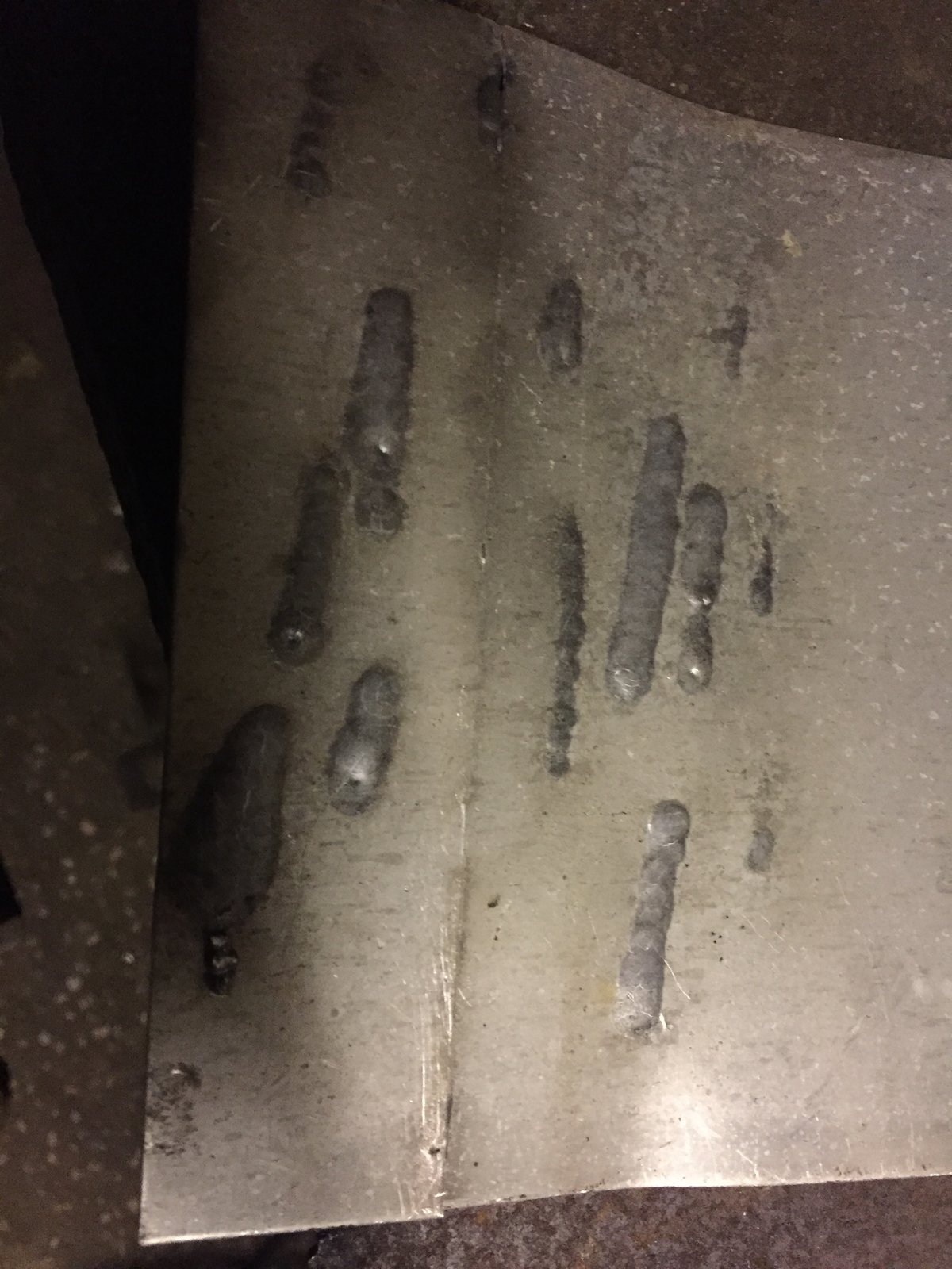

    picked up a Castotig 3002 locally and thought id have a go on some thin ally sheet first attempt was pretty dire and using a filler rod very quickly second attempt seems much better starting to get used to it a bit more adding less filler and speeding up a bit also getting used to lift start as hf doesnt seem to be working not sure whats happening at the end of the weld initialy I was lifting the torch away as soon as i finished but am leaving it threre for a few seconnds now also on my first attempt I was starting before the weld pool had formed.

    Keep going and suddenly it will be easy

    The second lot look pretty decent for the first few attempts.
    Clean material is a must and plenty of practice will get you doing some nice welds.
    You seem to have a decent rhythm going by the spacing :thumbup:

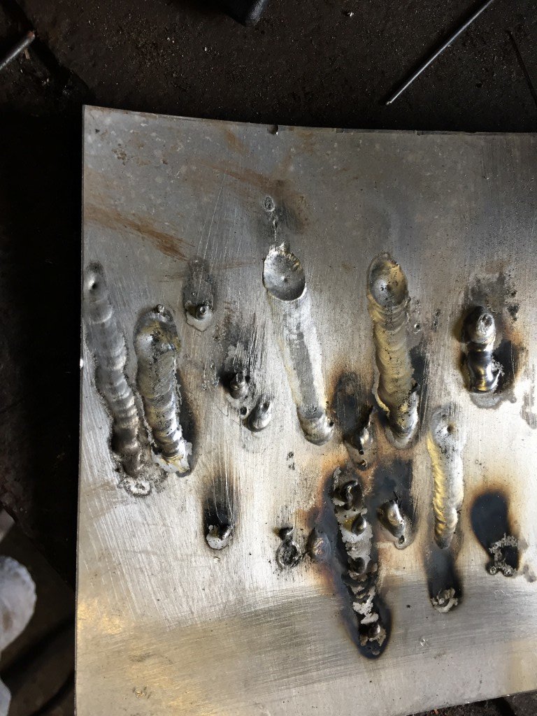

    Had another go this evening I am getting more confident with starting and the weld pool forming and adding filler so I havnt been practicing this but concentrating on getting the end of the weld right but Im still getting a crater I am using a foot pedal ive tried lifting of the amps and adding more filler but still seem to be getting a crater even though it is a lot smaller than my first attempts some are better but the filler rod has stuck to a couple where ive removed it to late

    I wouldn't worry too much about the crater at the end of the run as this can be touched in on a second spot weld. A crater is normally controlled by having a nice slow taper of current on 'button' or 'pedal' release that you can set up on your TIG set (ramp down) so you don't have to control this with your foot pedal.
    I see you don't have a very wide clean width but at least you can see it so its fine for very clean Alu. I would tent to want to increase that a little (positive to negative ratio). The brown staining on some of your runs is usually caused by bridging the arc with the filler wire momentarily or trying to add filler before the puddle forms.
    I would move on to practicing lap joints and then a corner fillet now you can lay beads and then some butt welds last.
    You have not mentioned the difficulty of striking an arc at start up so it sounds like you have overcome that?
    What is the underside of your plate looking like?

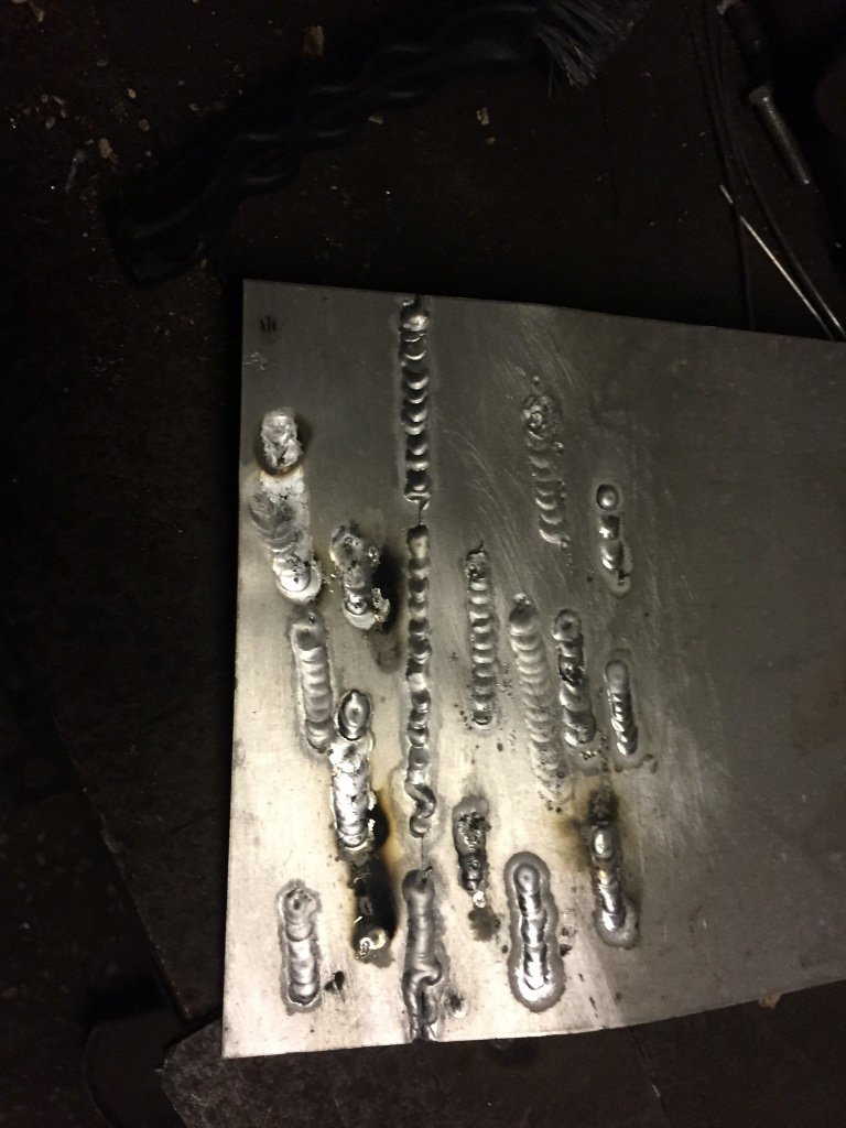

    Had a busy day but managed to get 15 minutes in this evening I tried a but weld and was surprised how hard it was compared to laying a bead on top for some reason I had the ally plate laying on top of some steel.
    I concentrated again not so much producing a good weld but getting rid of the crater and im getting the idea now just need to practice more.
    With regards to the welds some where done with a contaminated tungsten I was using a 1.6mm but had the welder set on about 3.2 to see how it affected my lift starts and they were not good I think having the tungsten size set wrong was maybe the reason as they were fine the other day didnt realize till later so will try again with it set correctly

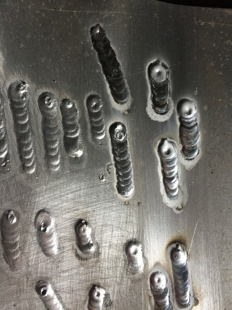

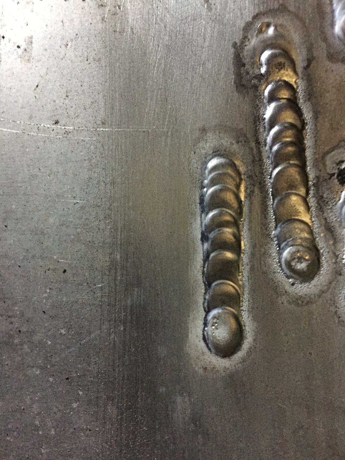

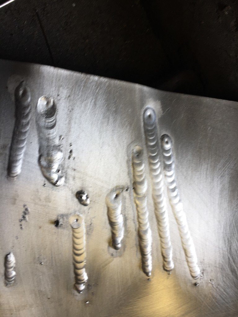

    couple of samll runs trying to get rid of the crater what do you think

    They look too cold to me.

    Thanks Ill turn the amps up a bit penetration underneath wasnt great did the end of the weld look ok thats the bit im strugling with

    The craters are definitely less pronounced than previously but that could well be because the weld was cooler to start with.
    Personally I wouldn't get too hung up on it as it will come with experience.

    Your butt weld did not penetrate to the rear probably because your steel backing plate bridged the gap between the two plates you were welding. This is a no no. You should always leave a gap on the rear. By all means use heat sink bars or plates to the rear but leave a gap between them at the joint position about 10 mm wide I.e 5mm either side of the join. If this was the case and you did leave a gap then you are running to cold. You should be looking to see a moving keyhole that you constantly keep filling with filler rod.
    TIG brazing is not simple but ideal to prevent distortion. Getting the current setting correct and absolute cleanliness is the key areas to concentrate on. Welding sets are designed to weld not braze so making sure the arc is not melting the steel is of importance. Unlike using a gas torch the arc temperature is much hotter so you are relying on heat dissipation in the parent metal and braze rod dips to be high enough so that it prevent excessive local heat build up.
    Re tungstens, I always use the next size up for the current rating when ac welding as the tungsten tip heats up much hotter due to the a.c. balance setting. That's why the tip balls when a.c. welding. I'd use 2.4 mm tungsten for the thickness alu plate you are welding and I would use white tip zirconiated or 5% lanthanated (not that easy to get) not Thoriated.
