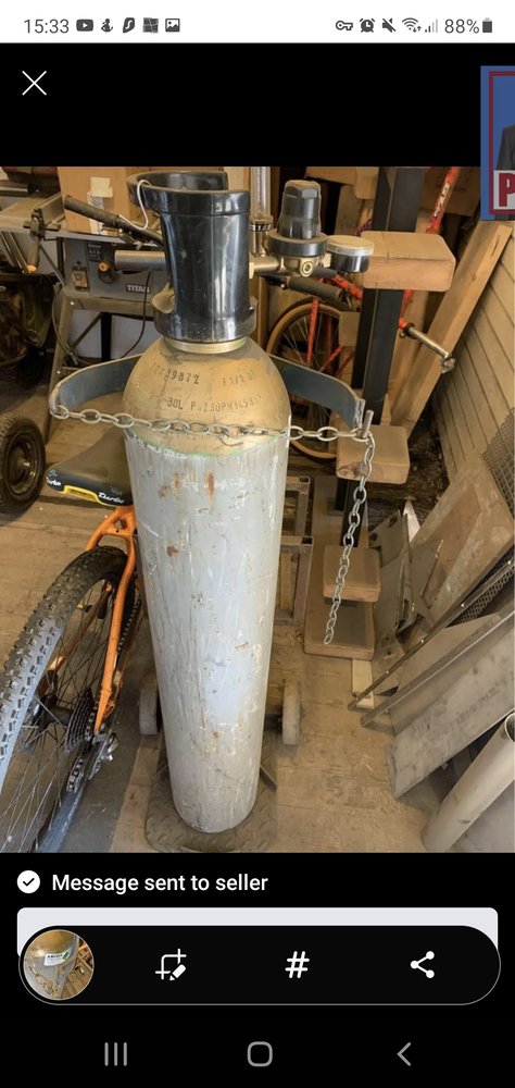

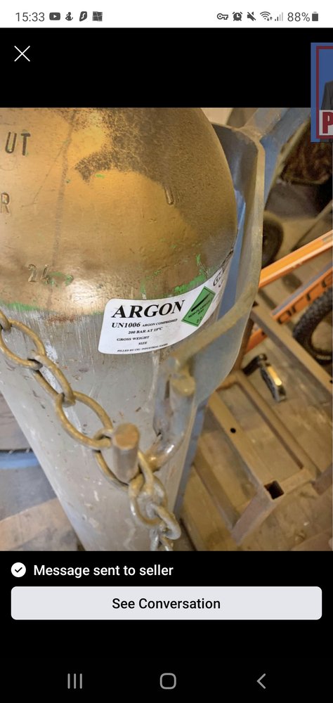

No idea haven't seen it yet. So can the bottle accept a mix ? Tysm the bottle is stamped 2024That was a pure argon bottle also the wrong regulator
What’s the date on the regulator?
Whilst it could it shouldntNo idea haven't seen it yet. So can the bottle accept a mix ? Tysm the bottle is stamped 2024
No good then. I need it for steel. Pure argon will not work. Maybe go co2. tyWhilst it could it shouldnt

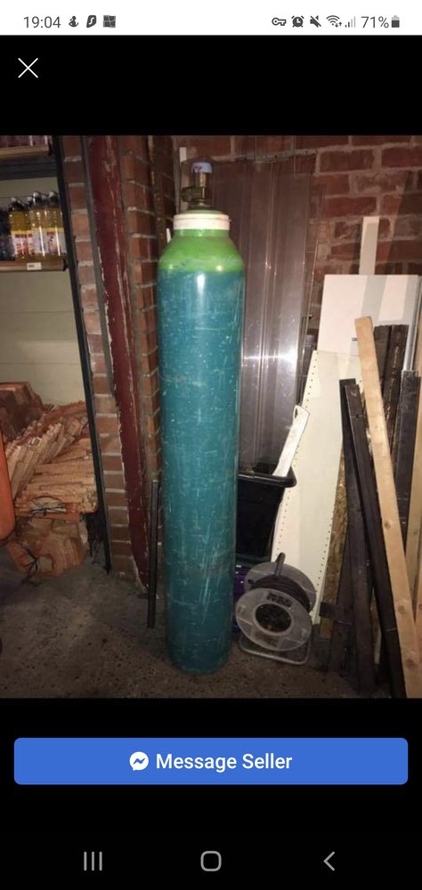

Get a co2 argon mixNo good then. I need it for steel. Pure argon will not work. Maybe go co2. ty
Thanks that not a bad price. 101 including depositGet a co2 argon mix
Different suppliers do different ratios, I think boc is 2.6%
5% CO2/Argon Mix Refill - 10L - 200Bar | MIG Welding Steel up to 6mm
Bottle Gases are proud to offer '5% CO2 / Argon Mix Refill, 10L for MIG Welding Steel '. Order online today!www.bottlegases.co.uk
Worth having a look in your area mate, tons of company’s sell themThanks that not a bad price. 101 including deposit
It's just the deposit that kills. If I can find a cheap mixed bottle I've got a company who does good prices for refills locallyWorth having a look in your area mate, tons of company’s sell them
