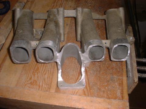

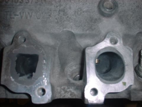

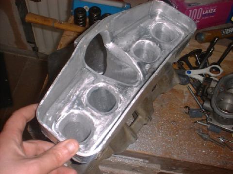

but I also rebuilt an edge on an alloy pulley and whilst shaping it after it had set the lump fell off.
hmmm, it had never been near oil and was soaked in acetone overnight, can't guarantee it was not contaminated but as clean as I could get.Could the mating surfaces have been 'deeply' contaminated, esp if as you say it was an alloy [aluminium]?
if its made of ally use technoweld with a blowtorch
I wouldn't use JB weld in your application, but I have used it to make the inlet ports on a cylinder head smaller
Well that's what I call bravery - if any of it breaks off it's going straight to the valves, piston etc...
