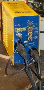

I have the same welder apart from mine is the 140amp version, I have to disagree with Dutchweld as I used mine extensively as a stick welder and it has been really good, I tend to use the cheapest rods from the local agricultural merchants.
Duty cycle is not brilliant on stick but is bearable for my use.
As a TIG machine its fine, enough controls to give a good weld without being overcomplicated.
Best thing about mine is its auto switching between 110v and 240v and its light enough to hang over your shoulder while stick welding up a ladder.
