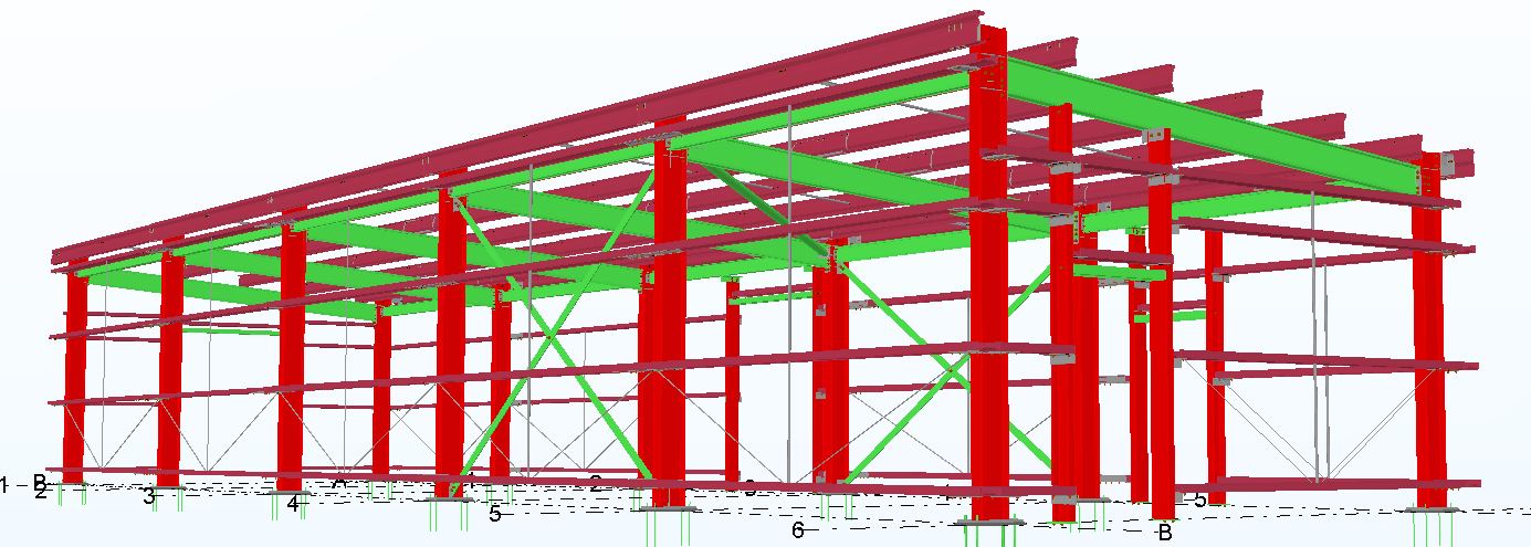

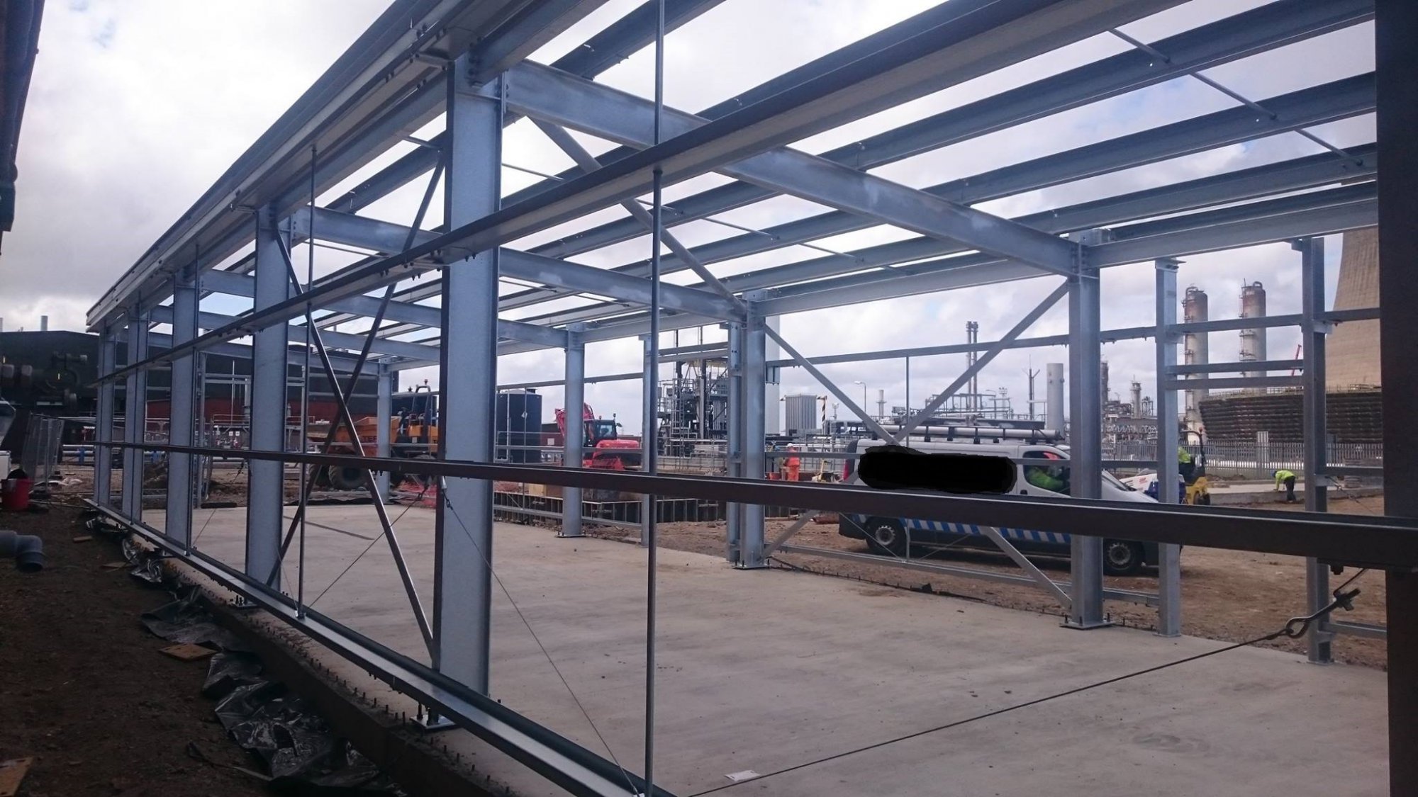

Another little portal frame put up this week in Redcar - Bottom view is a screenshot from our modelling software - pretty much all I see of the jobs when they are erected!
Well I can't see any mistakes.... guessing that's good right?
A keen eye will spot one....see who can find it first...
there is no cladding rail on the gable end at the top, so nothing to fasten top of sheets
there is no cladding rail on the end at the top, so nothing to fasten top of sheets
Near side, eaves level, top rail, missing splice at multibeam cleat on the column? Looks that way in the photo, I think
Tough one this, at any rate, Paul
