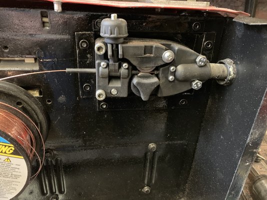

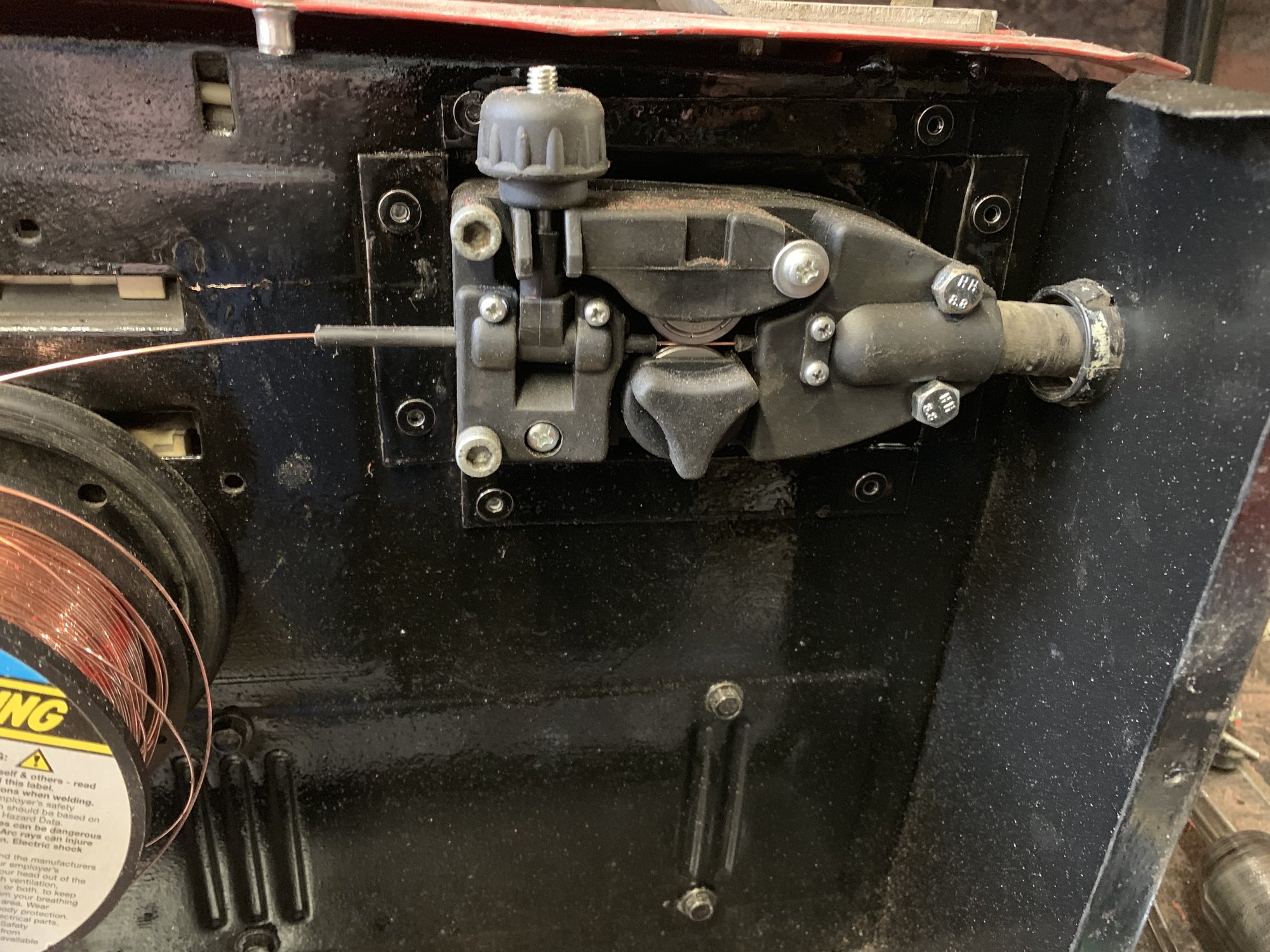

    IMG_0590.JPG I fitted one of these:
    https://www.ebay.co.uk/itm/282194899211
    Cheap as chips and seems to be doing the job. Replaces the motor and tension/feed assembly. You need to fabricate a tray to mount it in so that the wire can line up with the outgoing torch line.
    hunter27, riber3 and coda95 like this.

    Funnily enough I've just ordered myself one of those, glad to hear someone else has already successfully installed one.
    I'm thinking of getting an adapter tray 3D printed, so that others can then easily make one from the plans. Plus, I've always wanted to try having something 3D printed :)
    sanmarcopizza likes this.

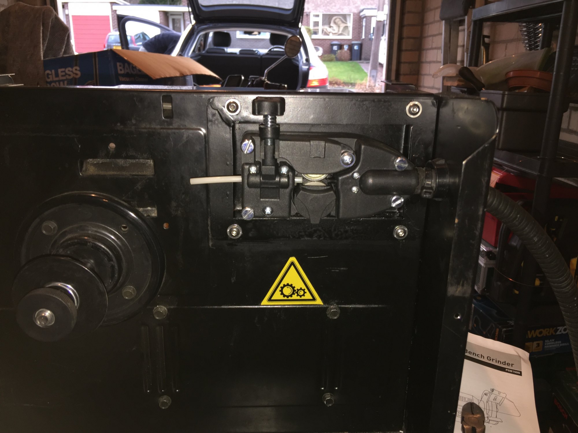

    Hi There, I'm new here i just wanted to thank you for your link to the wire feed on ebay. Fitted a treat and for the first time in years my welder works as it should.
    The only other issue i had with it was the plastic fitting that attaches the wire speed circuit board to the housing had become brittle and broken. That is now made of aluminium and will last for ever.
    I mounted the 24v feed motor into a little 15mm deep tray and used m6 screws to hold it in place.
    Cheers Guys!
