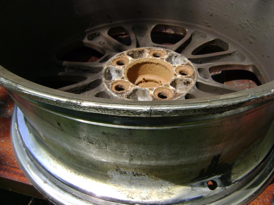

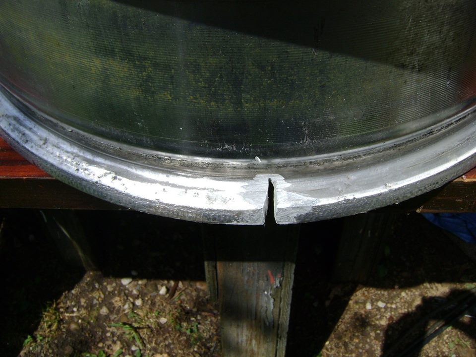

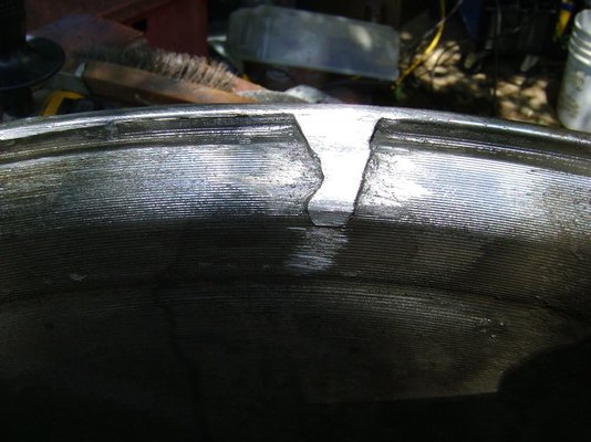

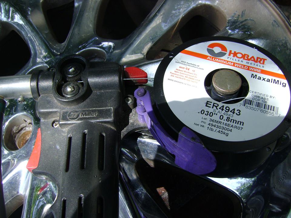

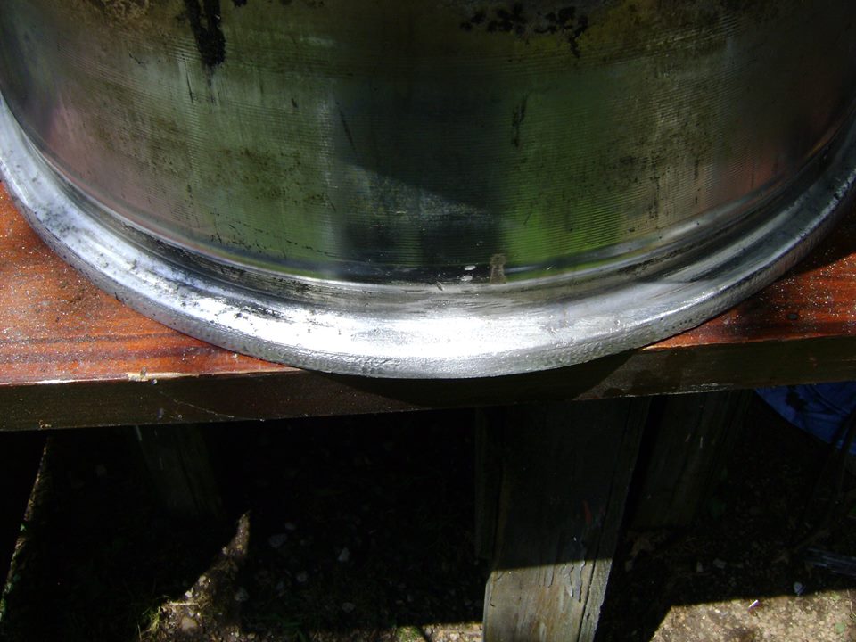

A aametalmaster Member Messages 763 Location Salem Ohio USA Aug 7, 2016 #1 I have been repairing this type of wheel for more than 38 years. Damage done from chuckholes and curbs...Bob
C Chris Stevens Guest Aug 7, 2016 #2 Not sure I would use a spool gun rather than a TIG, but it works for you why not.
