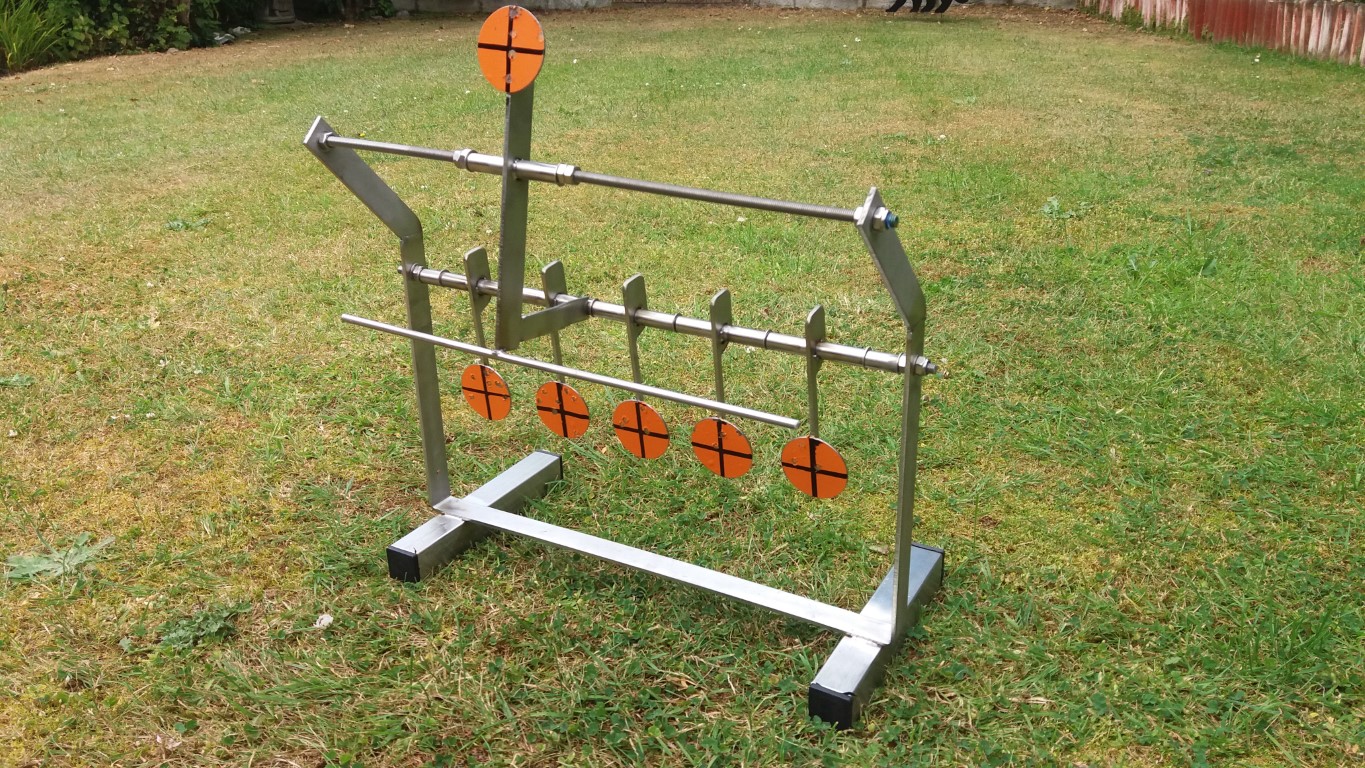

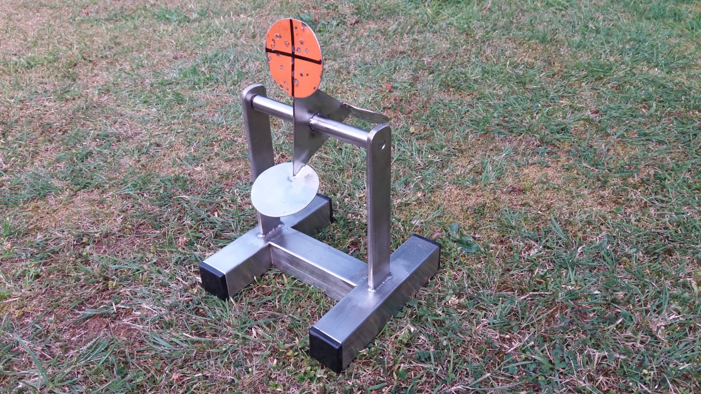

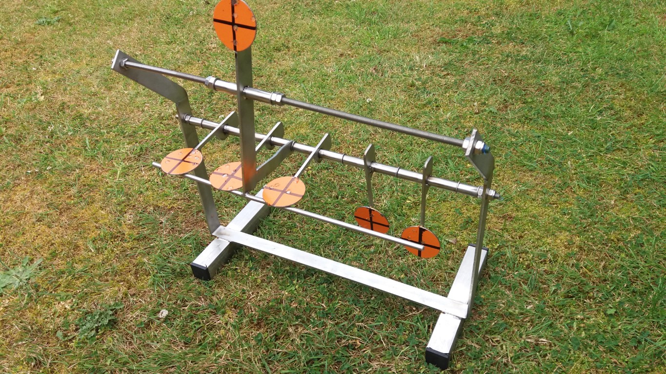

Another little something for me for a change, got a bit bored with popping holes in paper targets and walking up and down to replace them, so knocked this up,
Hit the lower target and it spins and sits on the horizontal bar then hit the top target to reset it,
Had to fiddle about a bit with the weight of the bars to get them to spin right over, a 177 pellet hasn't got as much energy as I thought but it works a treat now.
All stainless of course.
