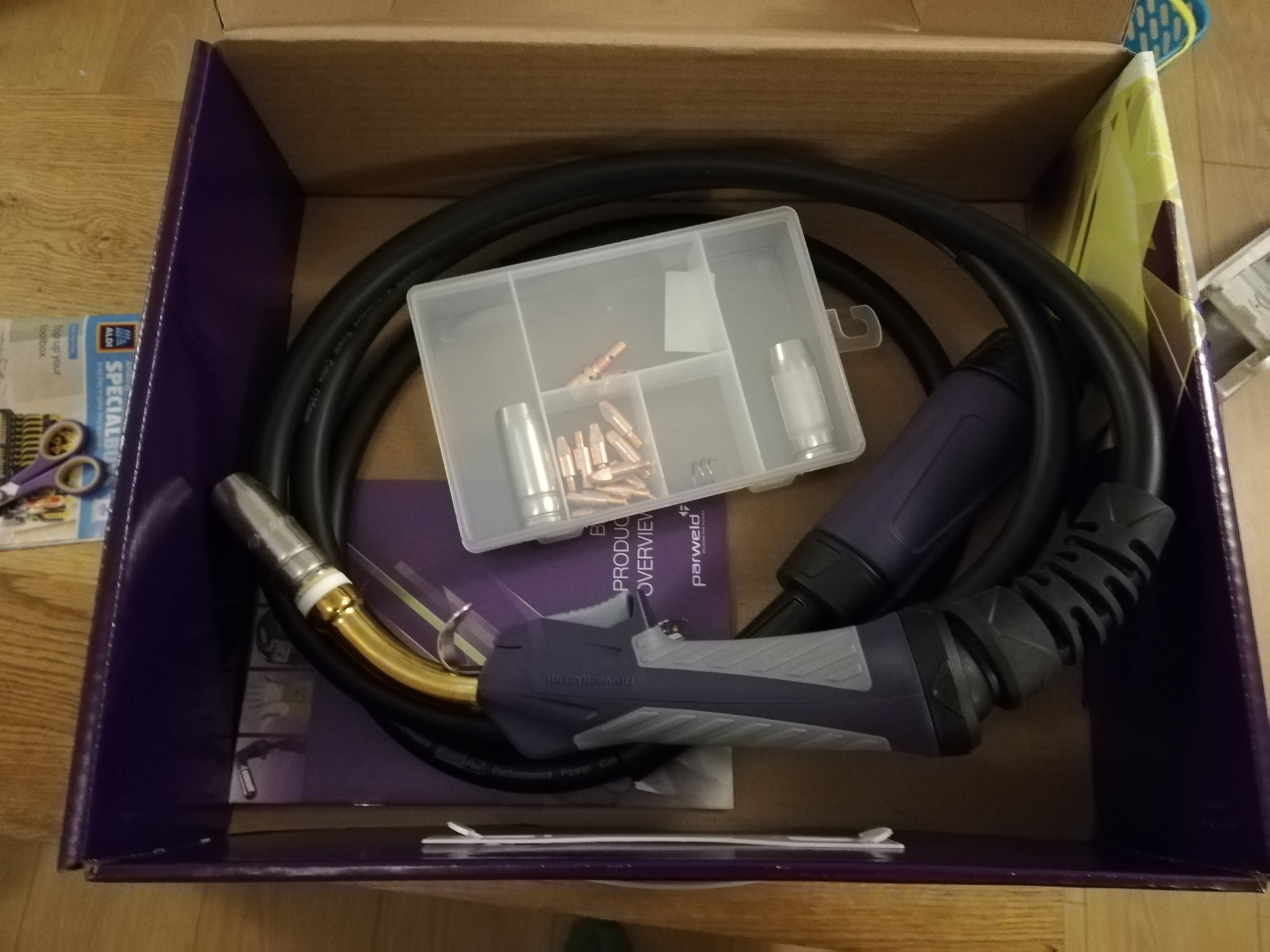

    Hello,
    I have a an Oxford 200-1 for occasional fabrication projects at work, which mostly consist of benches and factory furniture made from square tube and angle iron 2.5 to 5mm thick. My welder came with a SWP MB15 torch which seems good (I have no experience of anything else) but when I am welding it seems to get really hot, would I be better of with a MB25 size torch or should I stick with what I have? Thanks in advance for any help and advice.
    Rob

    It's normal for the nozzle to get hot.
    Binzel's MB15 is good for 60% duty cycle @ 150 Amp with argon/co2 mix. That seems to be more than what the Oxford 200-1 can deliver.

    I recently changed to an mb25 on a 180a machine. I prefer the size and feed to it. Steve at weldequip has good prices on parweld torches

    Thanks Pete, the nozzle does get hot, but the neck also seems to get hot (through gloves too).

    Hi Pondy, thanks for the pic, it looks good , nice spares box too. Does it feel more awkward when welding in tight spaces?

    The shroud is larger so it's a little worse in tight spaces but I've yet to have much of an issue yet. Ive kept the smaller mb15 if I ever had to weld somthing the large torch couldn't get to

    Hi Pondy, I ordered the parweld mb25 4M from weldequip. I’m looking forward to giving it a go, will let you know how I get on.

    An MB25 is just a better design of torch all round. Everything is bigger and better than an MB15.
    The only annoyance is that spring clip that provides friction to the shroud. If they could do a MB36 style shroud for the MB25 torch, it would then be perfect. As it stands, I'd always take a 36 for everything apart from car bodywork.
    I prefer Binzel torches and spares to Parweld, but this is just personal experience and preference.

    My Parweld MB25 4M from weldequip arrived, I have been welding with it, and I prefer it to the MB15 torch I was using, it still gets hot, but not as bad as the MB15, it didn't take long to get used to the size, the extra 1 metre is great, I don't have to move the work or welder around as much. So all in all very happy, glad I bought it, and I have the MB15 to fall back on if needed. My welding is not great, but that is something I'm working on. I will probably post some pictures of my welding soon to get some pointers.
