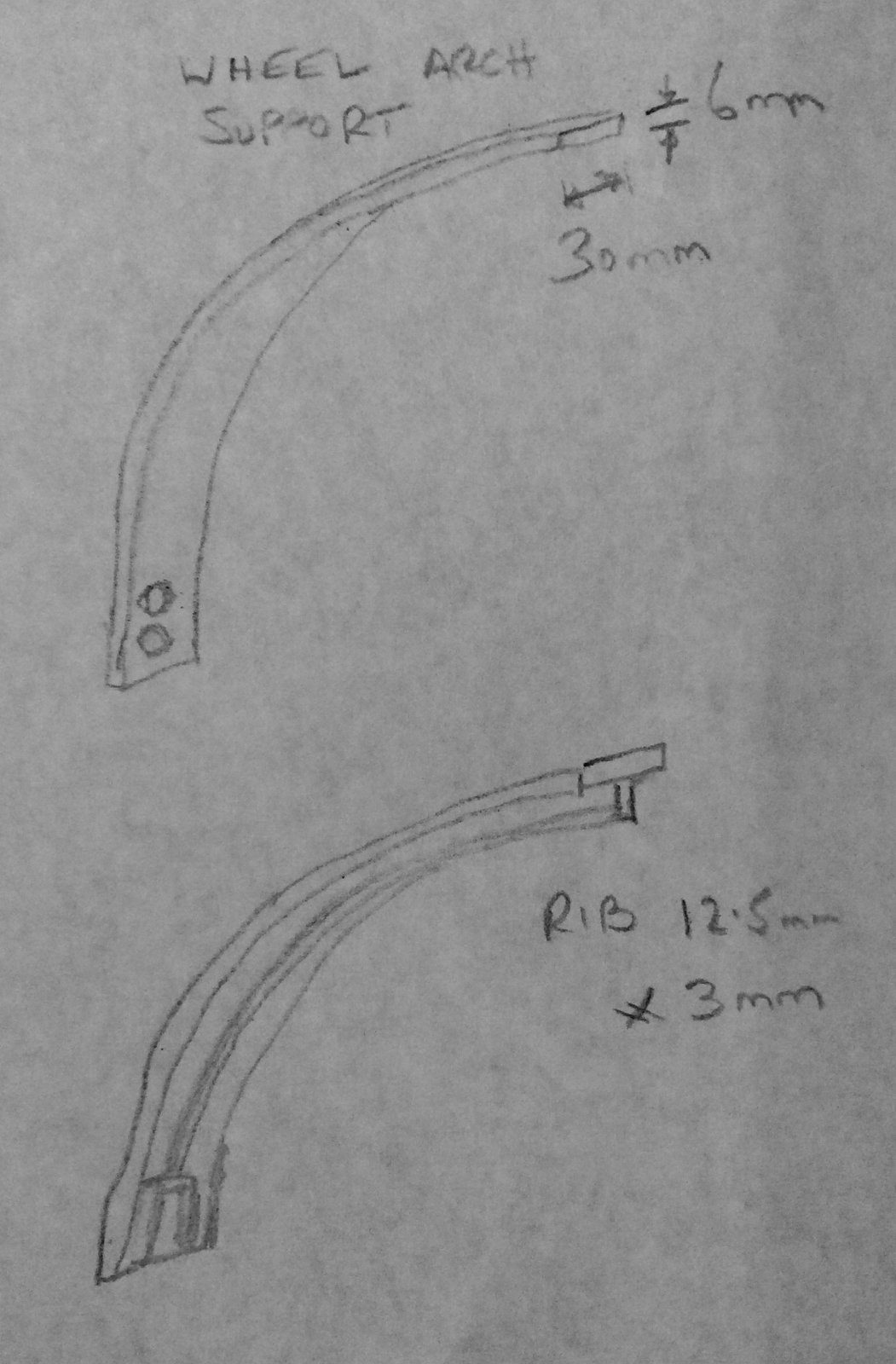

To improve rigidity I am thinking of adding a rib to effectively make the support a tee section.
I have some 25 x 3mm strip which I am going to split down the middle.I will then need to bend the strip (now 12.5 x 3mm) to fit the existing shaped support before welding it to it.
Ideally the strip would be passed through a ring roller to get the right radius but I don’t access to such gear.
So I am left with cutting partial slits in the strip bending until it fits the required shape & rewelding the slits to hold the curve.
That is unless anybody has a better way of achieving the curve?
