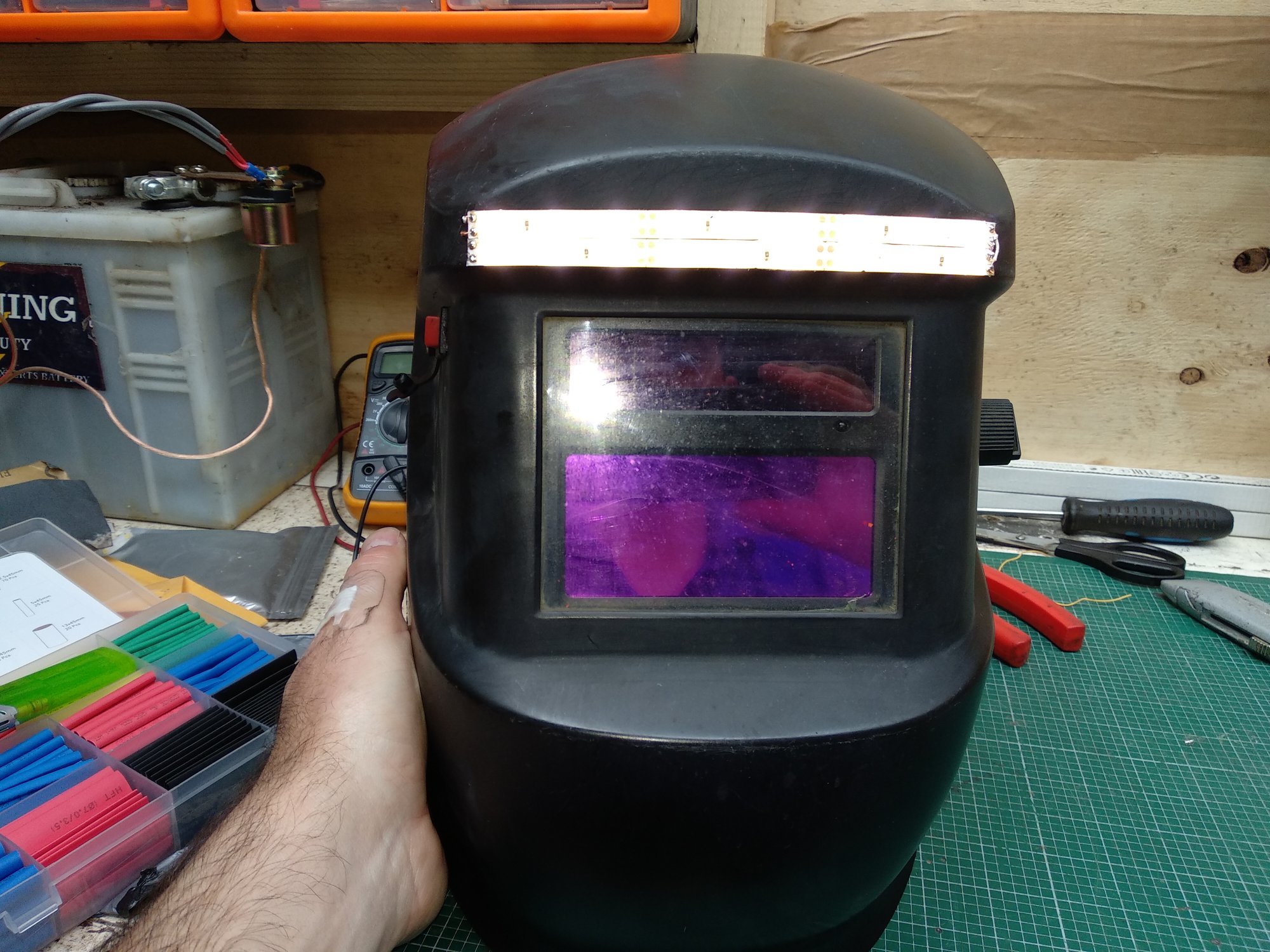

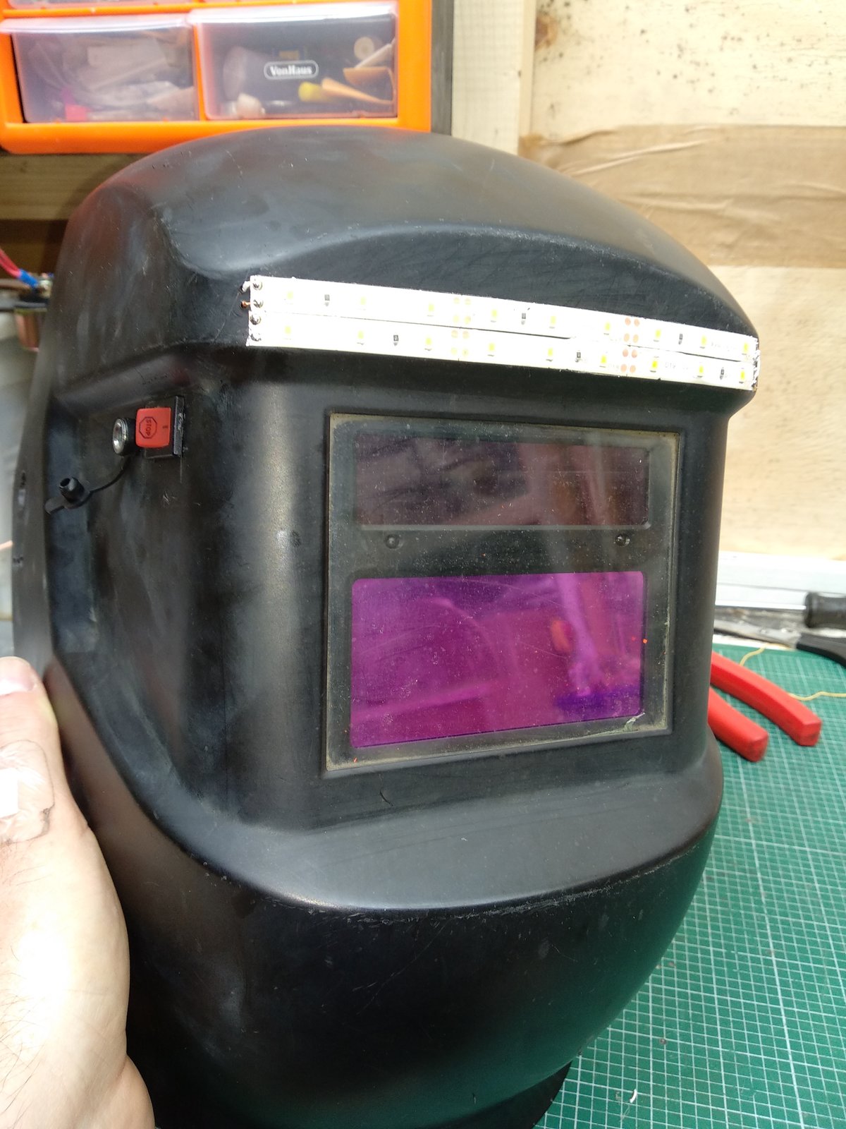

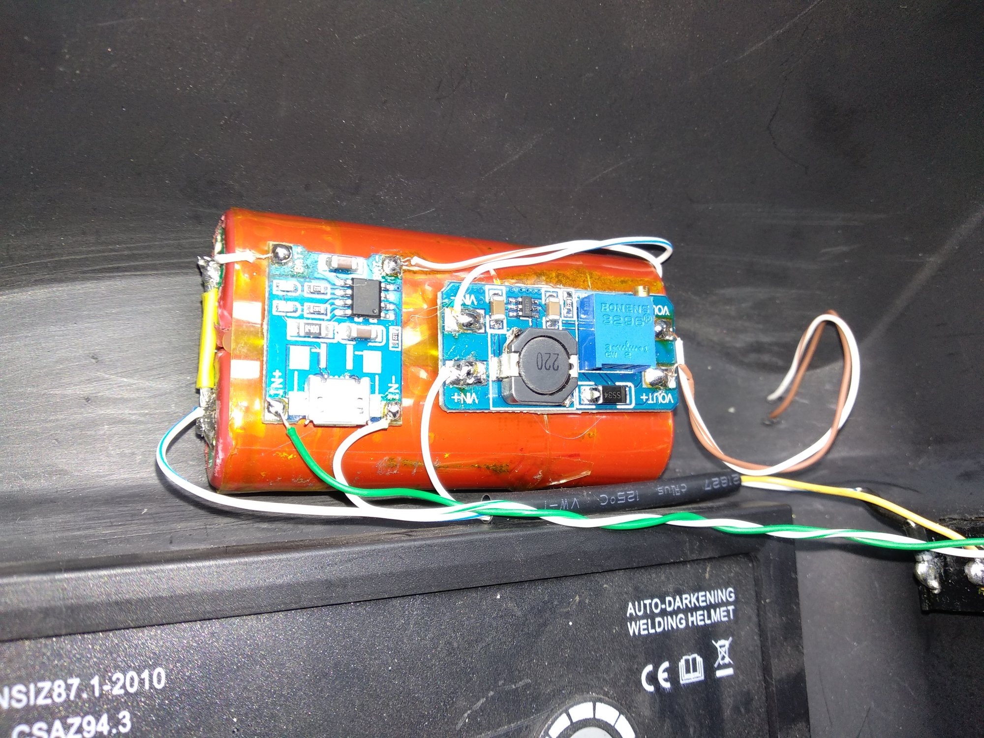

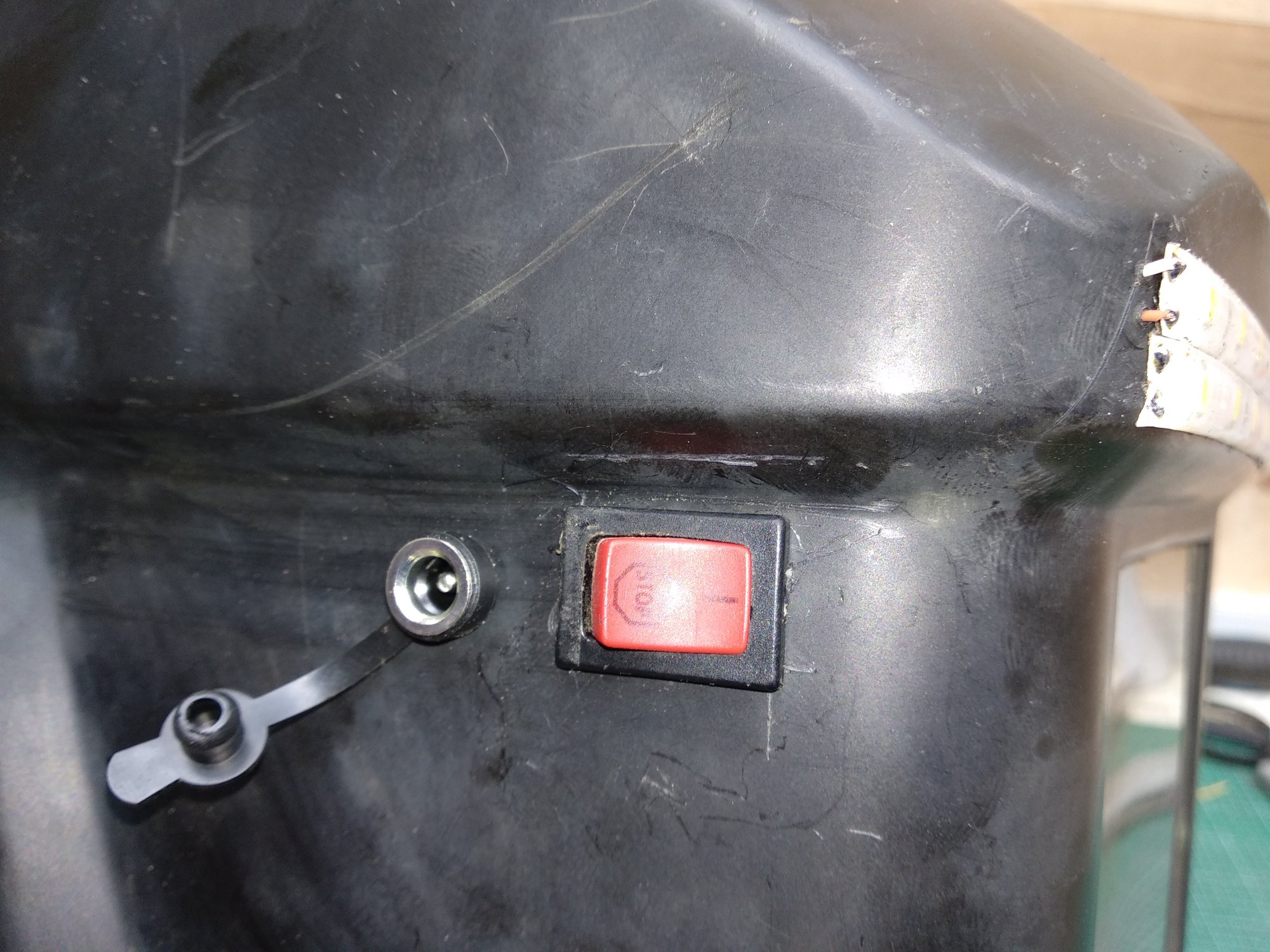

    So I added some LED strips to my welding Helmet. Wired 2 18650 laptop batteries in Parallel with a TP4056 charge board, and boost convertor to give me an output of 12v to the LEDS's.
    Also added an on off switch from old strimmer engine and a charge port for a 5v phone charger with barrel connector.
    Lights off.
    Lights on.
    Switches and charge port.

  2. 3000alloy
    3000alloy New Member
    Messages:
    12
    Location:
    Ireland
    Will upload a picture through the lens when it's a little darker.

    To be really fancy, there could be a light sensor added to cut the power when an arc is created, this saving a little battery. But hey I used what I had at hand.

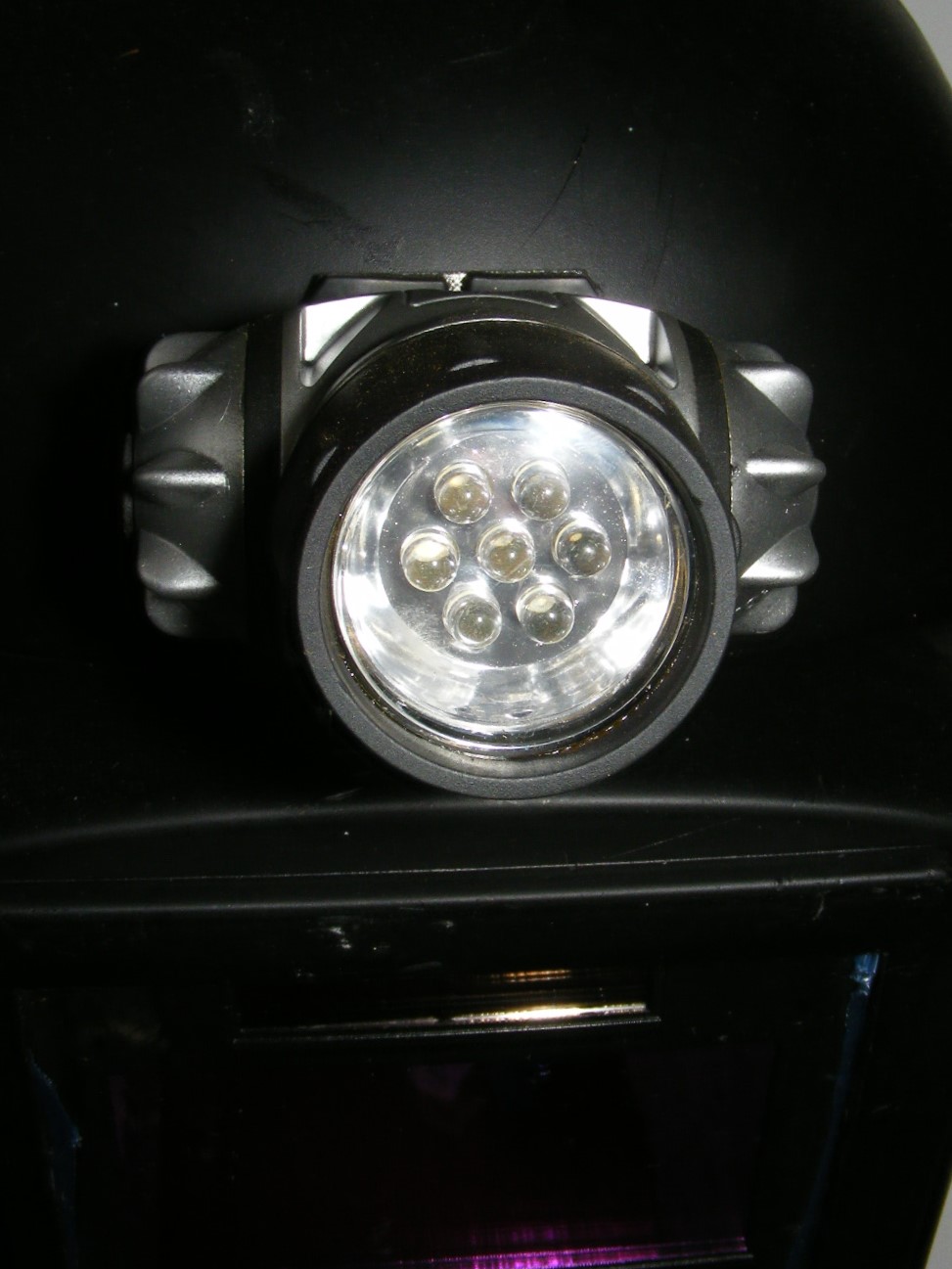

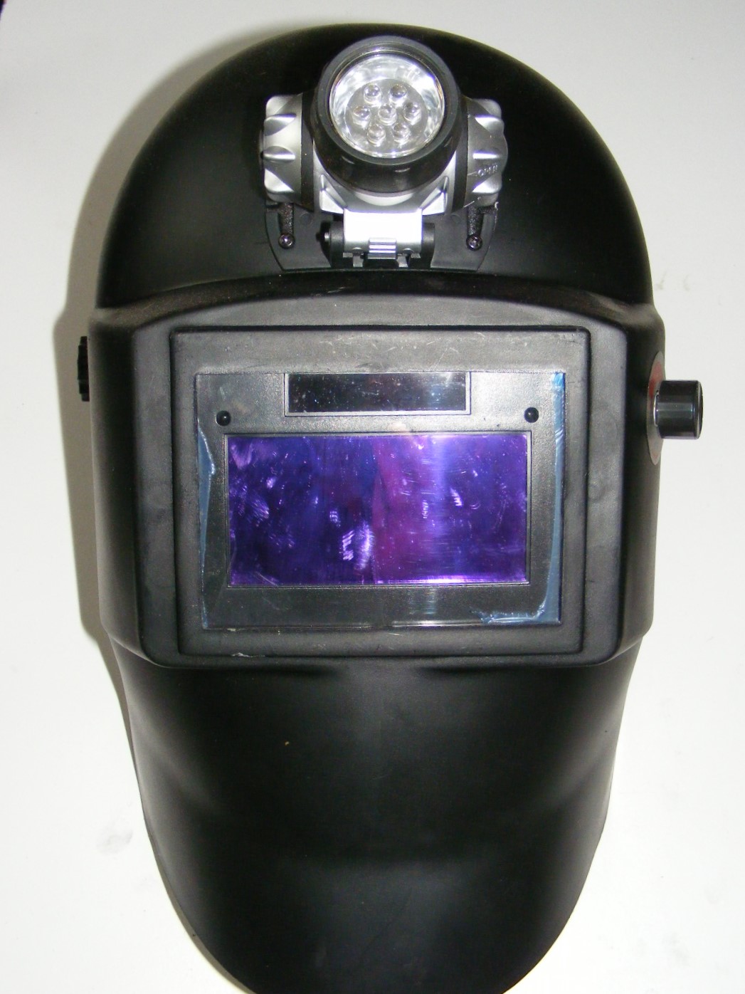

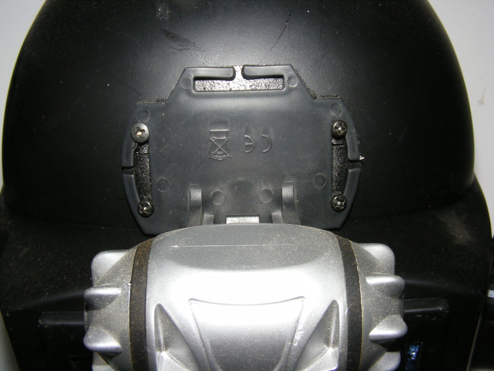

    I had the same problem. I simply purchesed a cheap (£1) headband torch in Poundland. I removed the strap and screwed it to the top of the helmet.
    This works well in dark environments.

    Now that I like very very much, simple, cheap, ingenious idea

    I am usually MIG welding in a rather dark garage, to keep out of the wind, and even when the auto darkening glass is clear it is difficult to see what I am doing. Adding the light makes it easy to position the welding torch accurately before the arc strikes. Once the arc strikes the autodarkening glass darkens and you can easily see what is going on by the arc light.

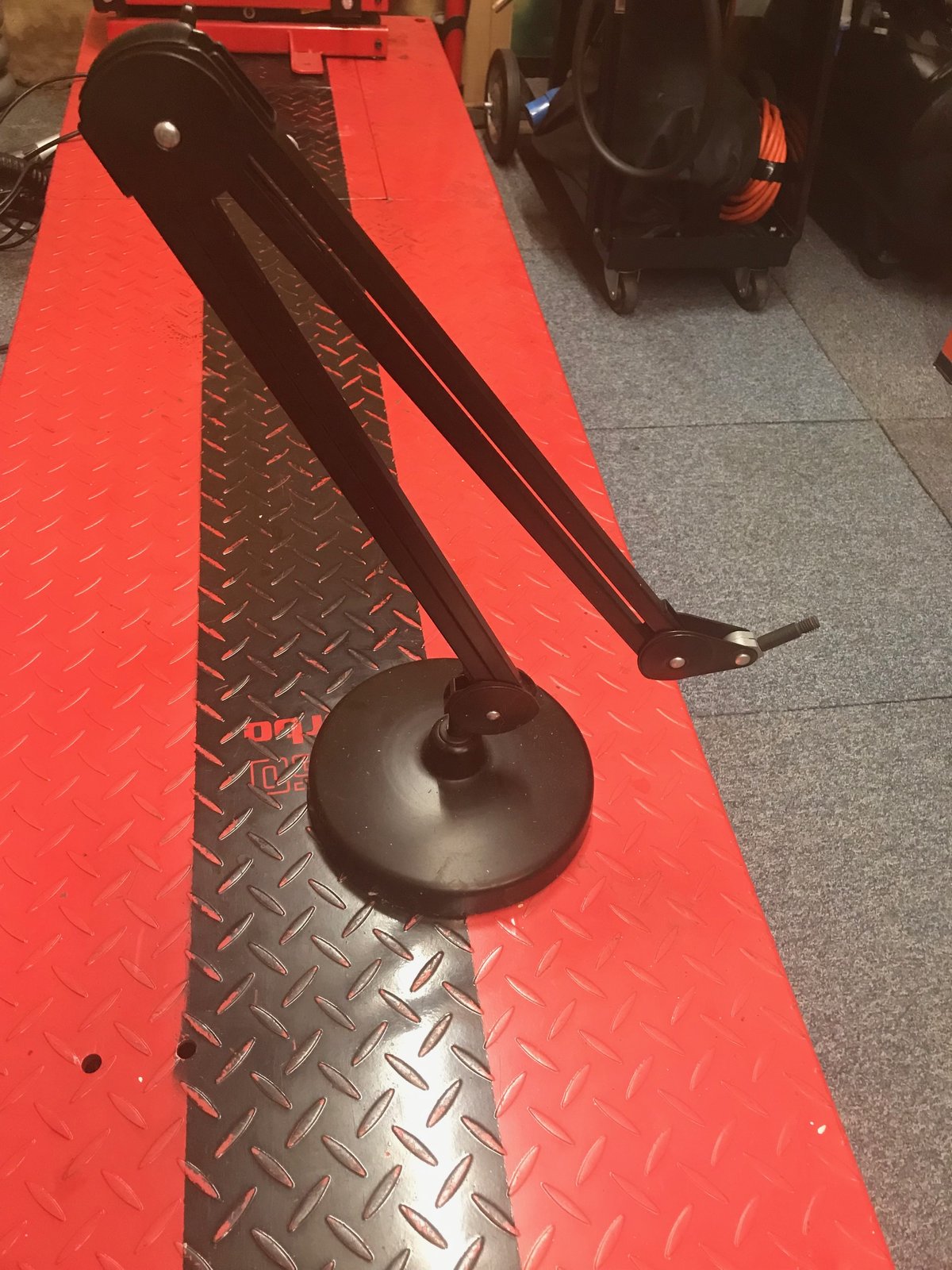

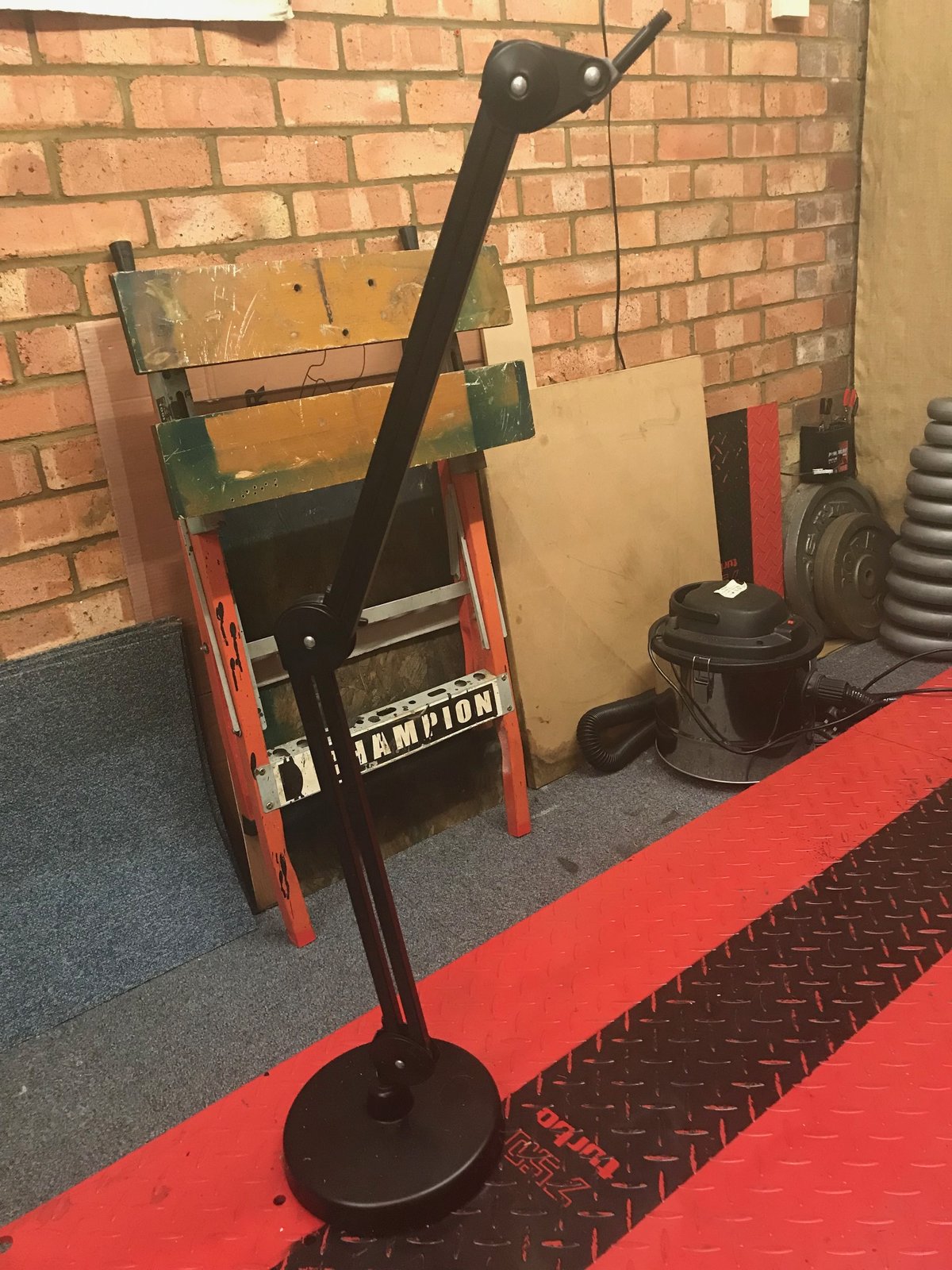

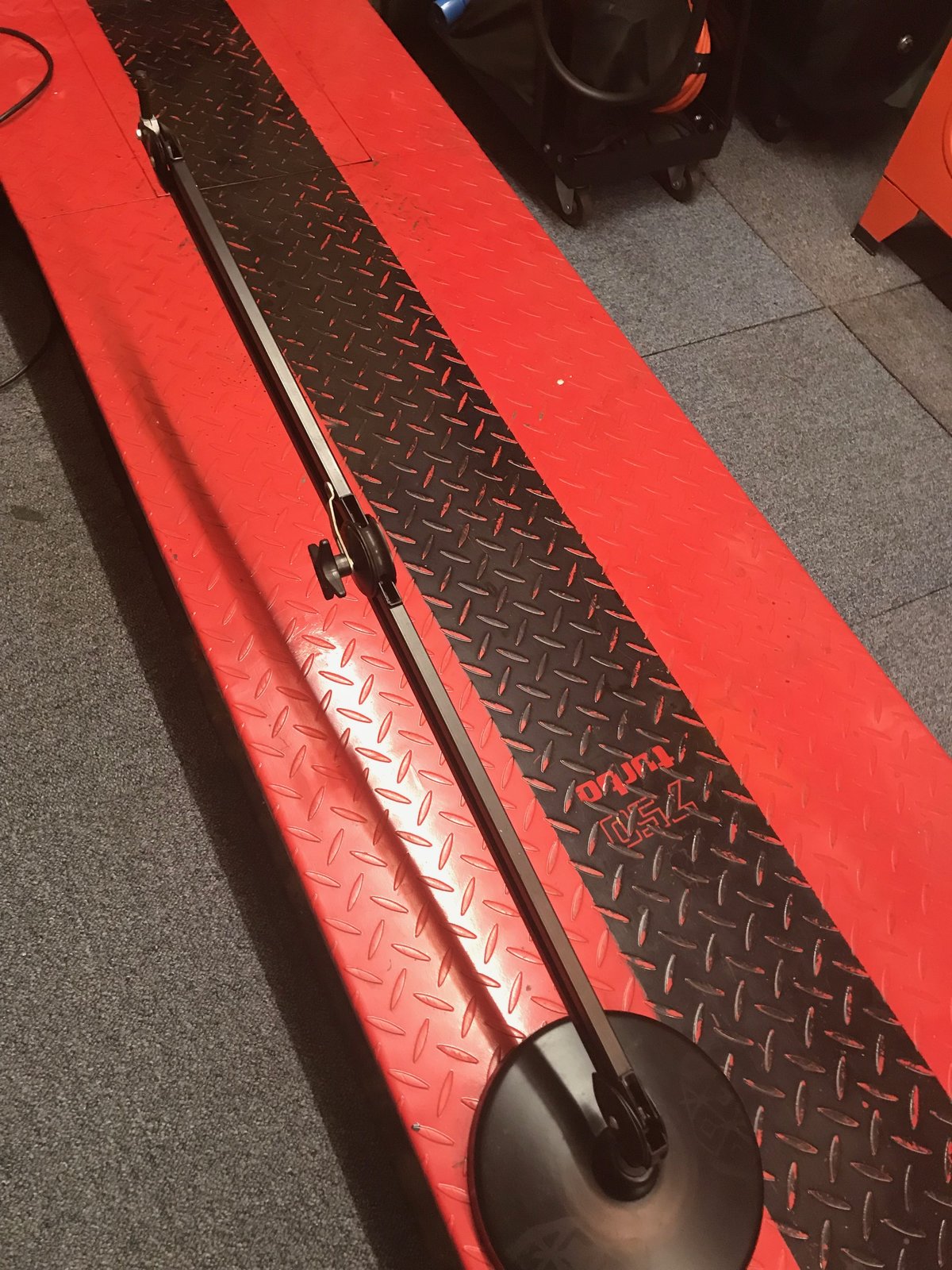

    This got lobbed from a music dept - perfect mic stand, ok you cant stick it on your lid but I'm yet to find a situation where I can't direct a light source or similar things in a stable manner. 6kg base, extends over a meter flat/up and could add extra length on the m10 end but never had need.
    The things schools throw away:dontknow:

    Doesn't all that add extra weight to the helmet making it uncomfortable during long periods of use?
  19. 3000alloy
    Messages:
    12
    Location:
    Ireland
    I have not used the Helmet long enough to say TBH. Yes it adds some weight but my initial thoughts would be that its manageable. The position i have the batteries is as central as i would like to have it, ie batteries positioned any higher or lower in the Helmet enclosure would result in a uneven weight distribution (all very technical for a Helmet light!!) resulting in the helmet constantly dropping down or else staying tilted up requiring a hand to move it etc.
    Time will tell if it strains my neck or not. It doesn't help me weld any better i notice - still Jabberwocky..:doh:
