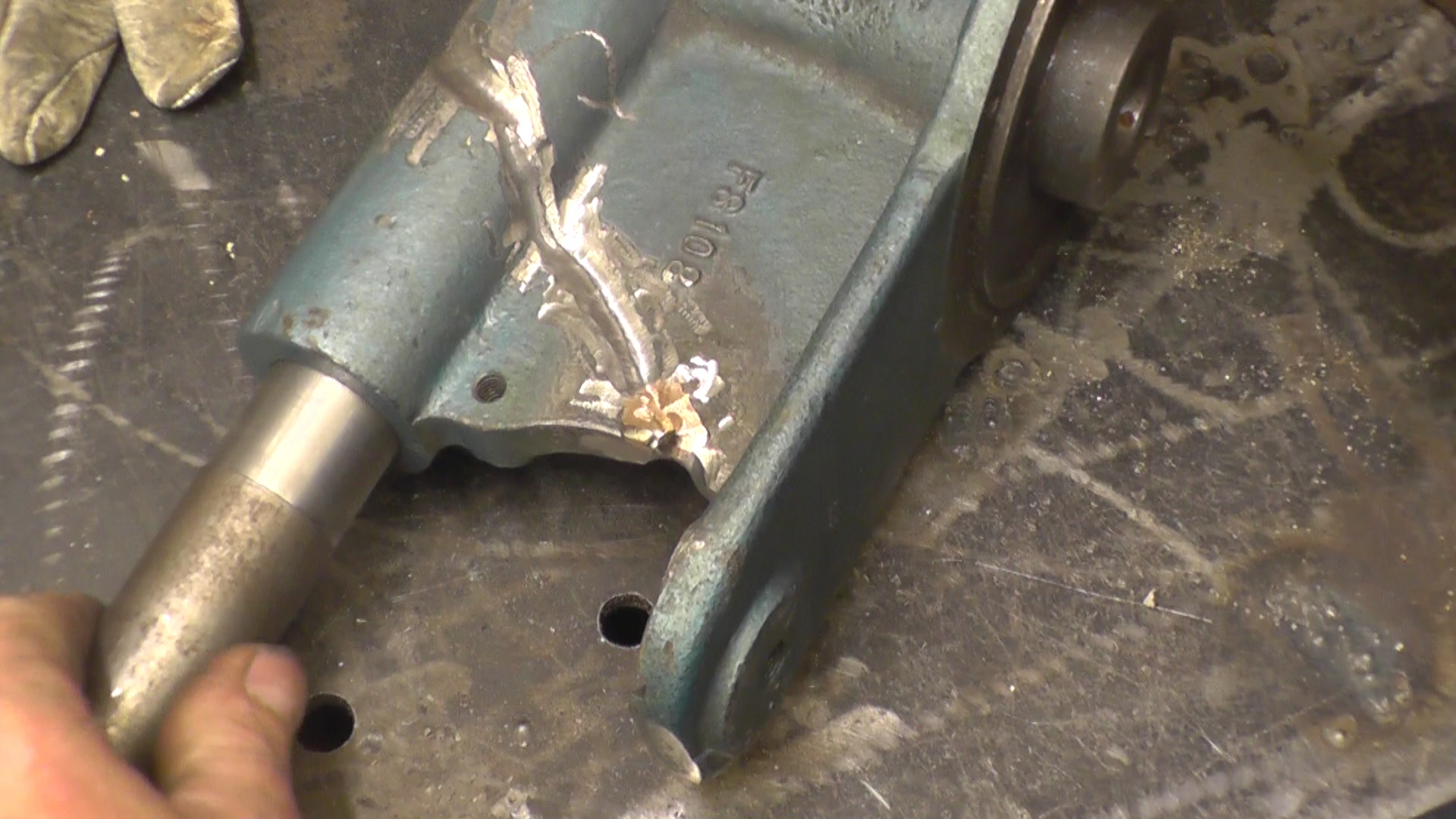

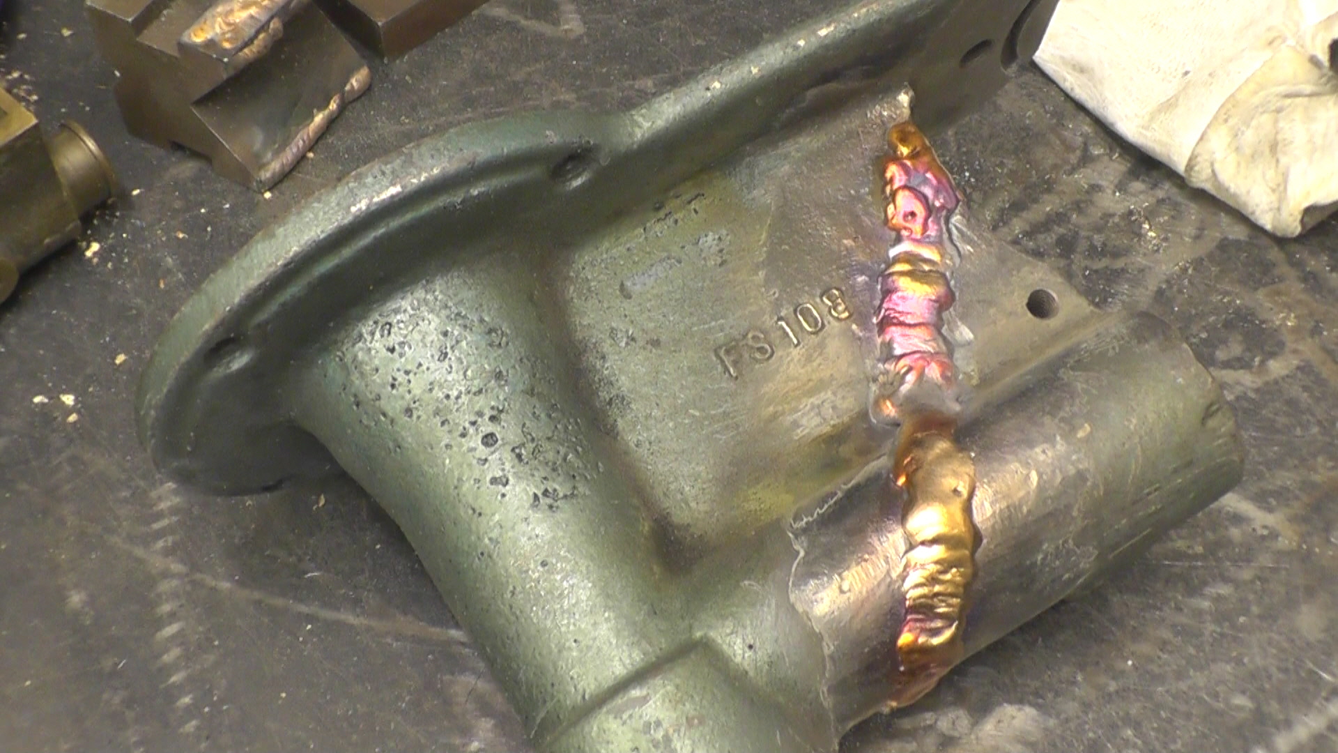

Very SmoothNice job John.
Did it pop and fart a lot or was it pretty smooth going? I have to do a small cast iron repair and that looks ideal.
Be some video up on Sunday

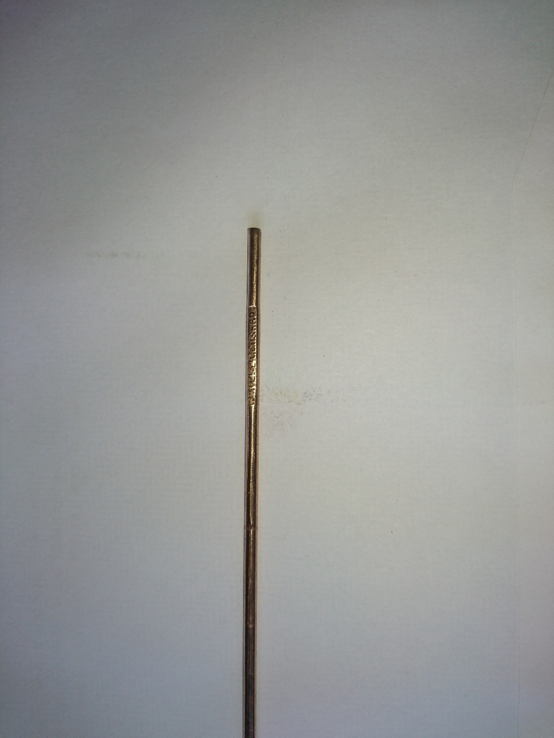

The sif no8 rods I have aren't stamped anywayShould (or are) the SIF rods stamped on one end like normal tig rods, was have a few with no stamp, and was wondering if they were mixed up with normal gas brazing rods.
The No8 ones I have are stamped
I bought mine from welding supplies direct.The last rods i had were stamped
Both lots were supplied by R-Tech
Could the rods be counterfeit
They seem to perform in exactly the same way
Ordinary brazing rods dont work due to the zink content
Copper electric wire can be used at a push
