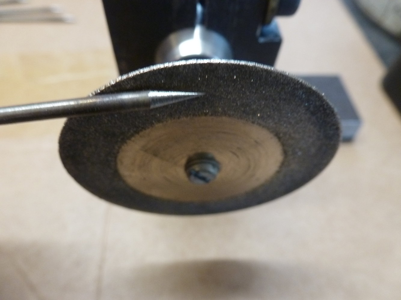

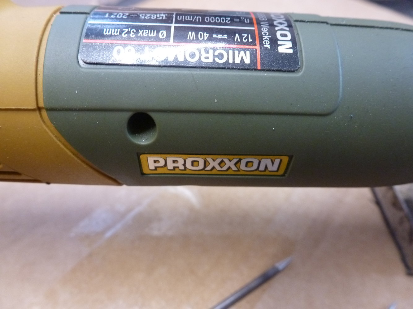

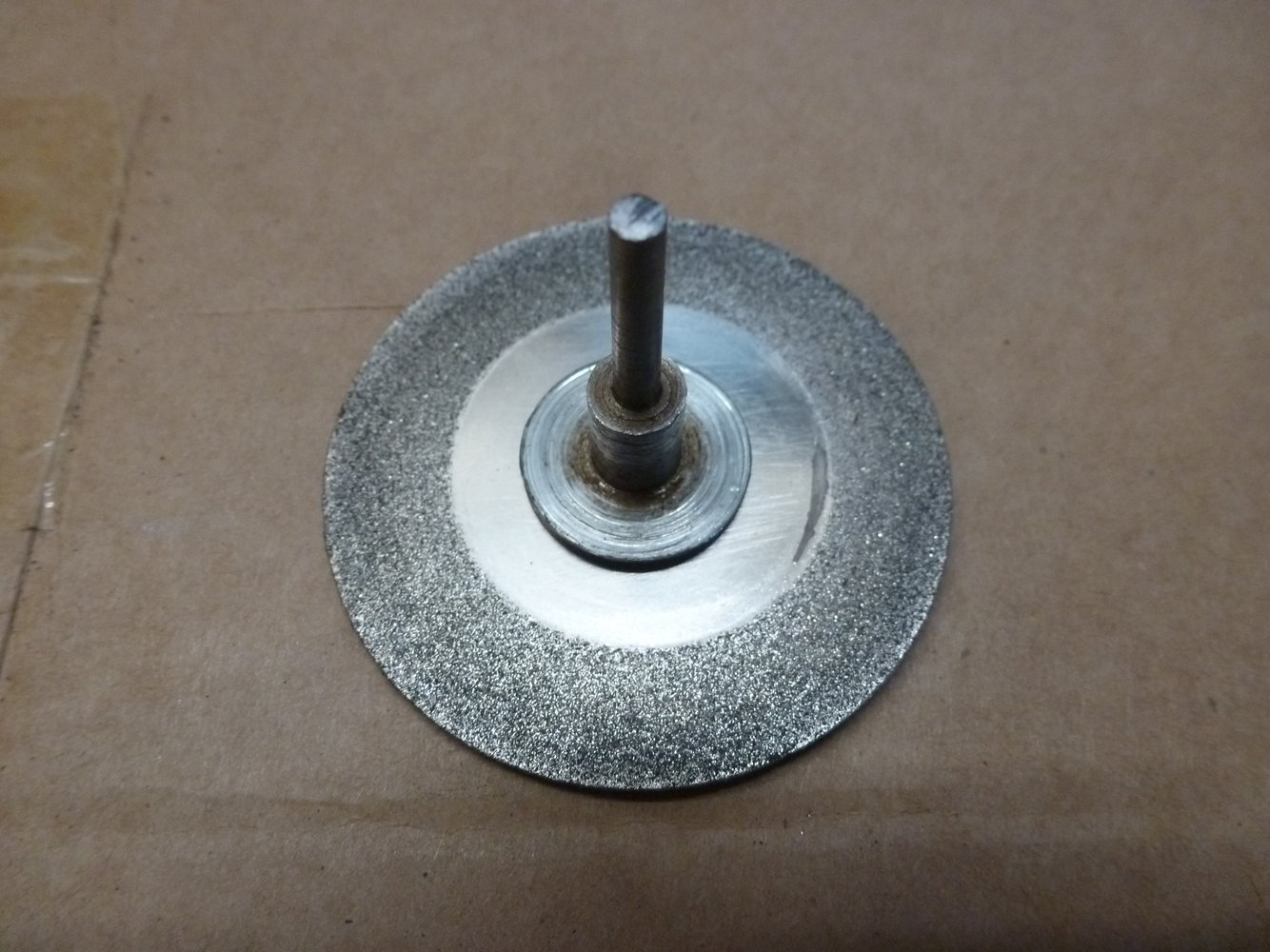

A post which might be of some use to Tig enthusiasts...............

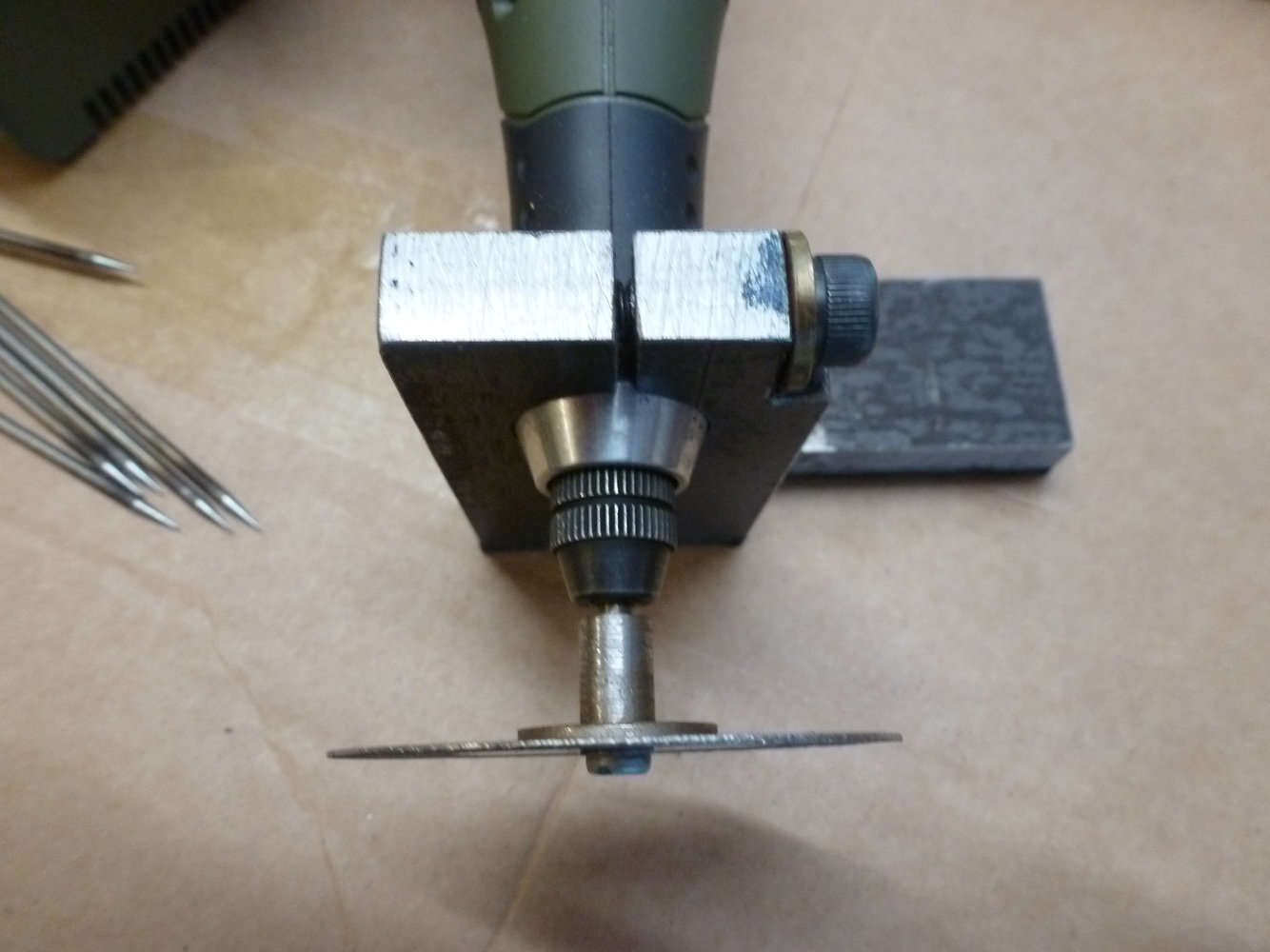

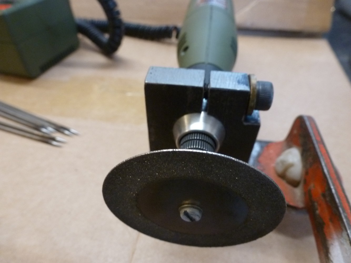

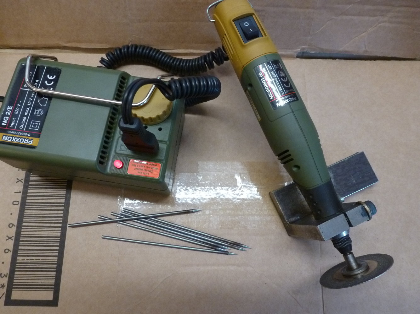

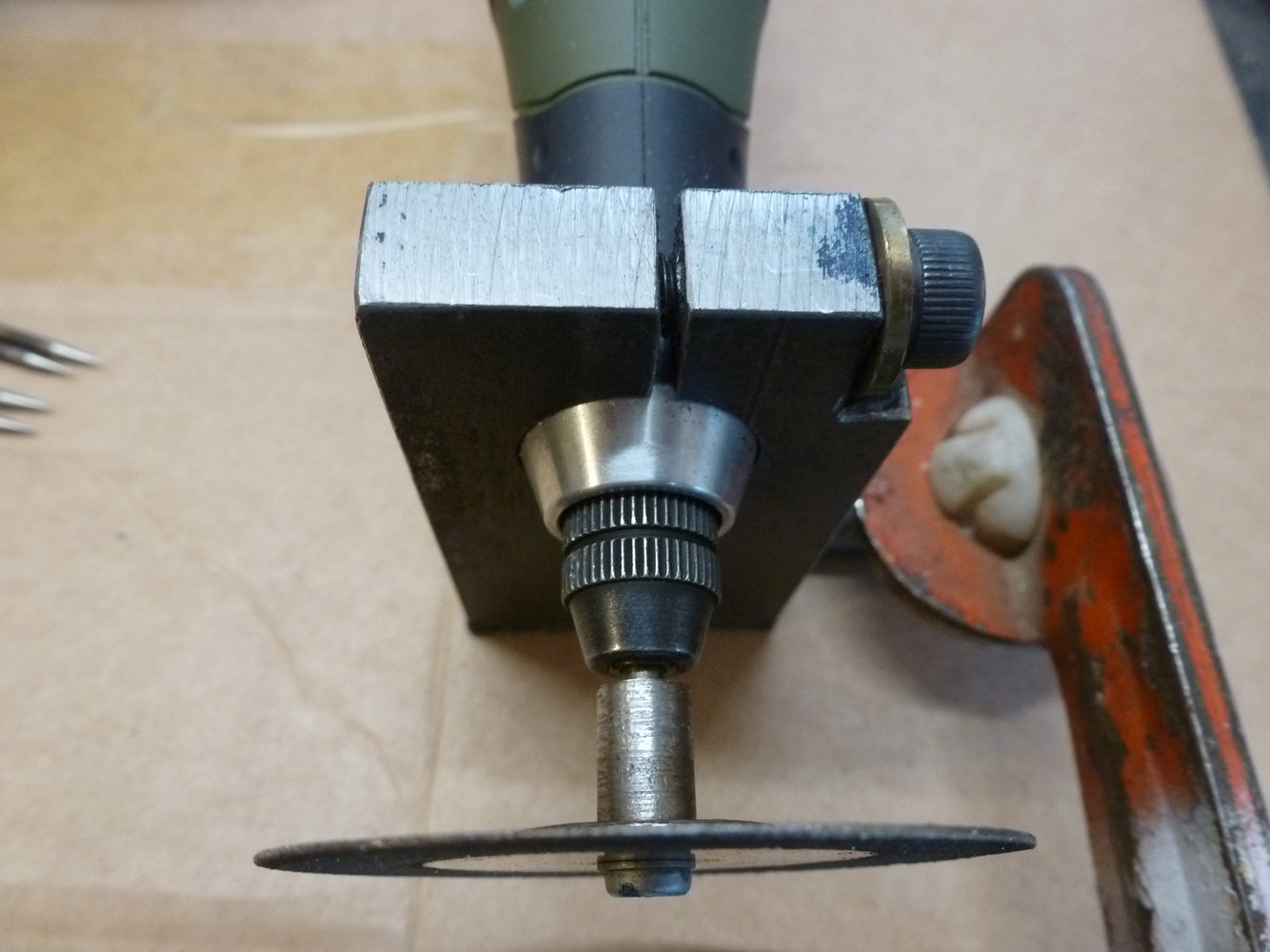

1. Manufacture a small quick release bracket for your Proxxon grinder

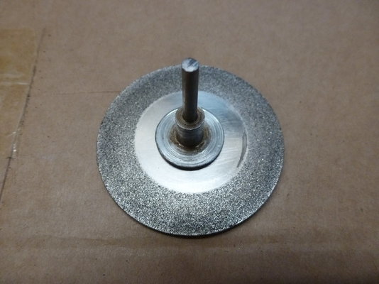

2. Manufacture a mandrel with a larger flange from an 8.8 grade standard coach bolt
3. Purchase a 40mm diamond disc

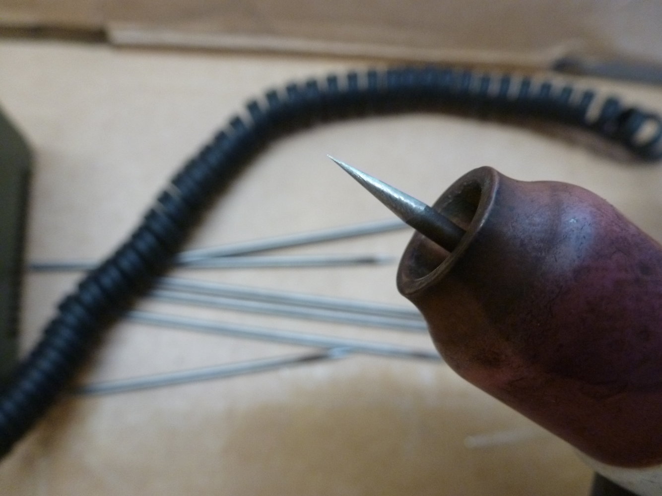

4. Sharpen your tig electrodes quickly and easily
5. For best results grind towards the top of the diamond disc so that grinding is inline with the tig electrode length
6. And Lastly - STOP talking about it and just go and do it!
Once you have tried this method I doubt you will ever go back to using a standard bench grinder.
Disclaimer: This is not engineering advice so do not UNDER ANY CIRCUMSTANCES follow what I do or say
Any attempt to ignore this warning can result in severe physical or psychological damage!
