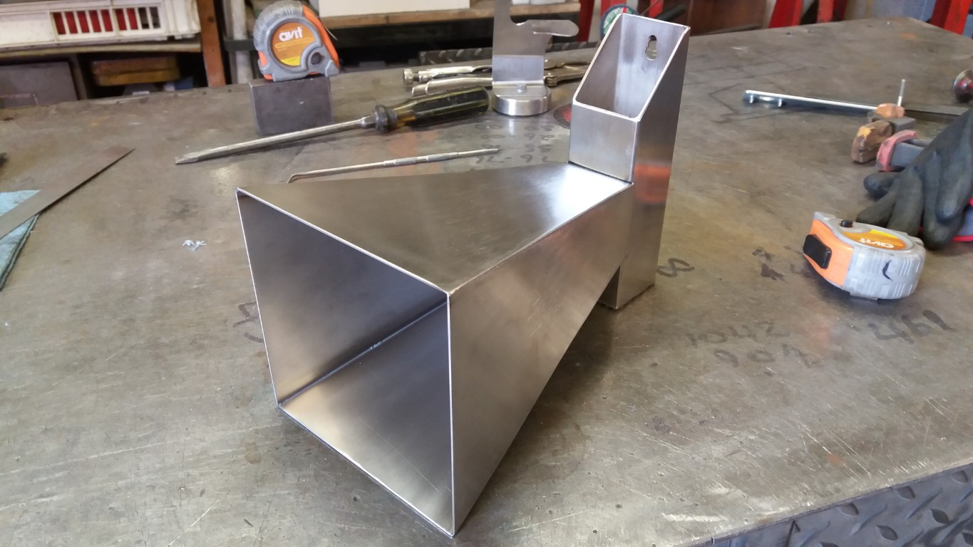

    Held up today so made something I've been meaning to do for ages, see if you can guess what it is, I suspect that most will know though.
    First some bits of stainless sheet
    Then weld em up and make it look a bit decent
    Then a short piece of stainless box section cut out the front and cap the end with a bit of perf.
    There is also a keyhole slot.
    Join them up, not much weld needed just a couple of short runs each side will be enough
    Its not finished yet, just one small detail to do tomorrow.

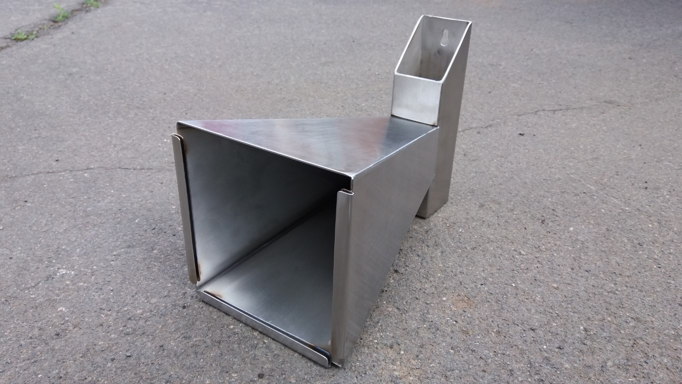

    Yep pellet catcher,
    Target holding channels tacked on and its finished, I know you can buy one for next to nothing on ebay but not in stainless, I've made it so that it can either hang or will stand level on a shelf so i can use it in the workshop or at home in the garage, it works really well, no rebounds at all so far, hitting that box section at the back takes out the energy and they just drop in the collector

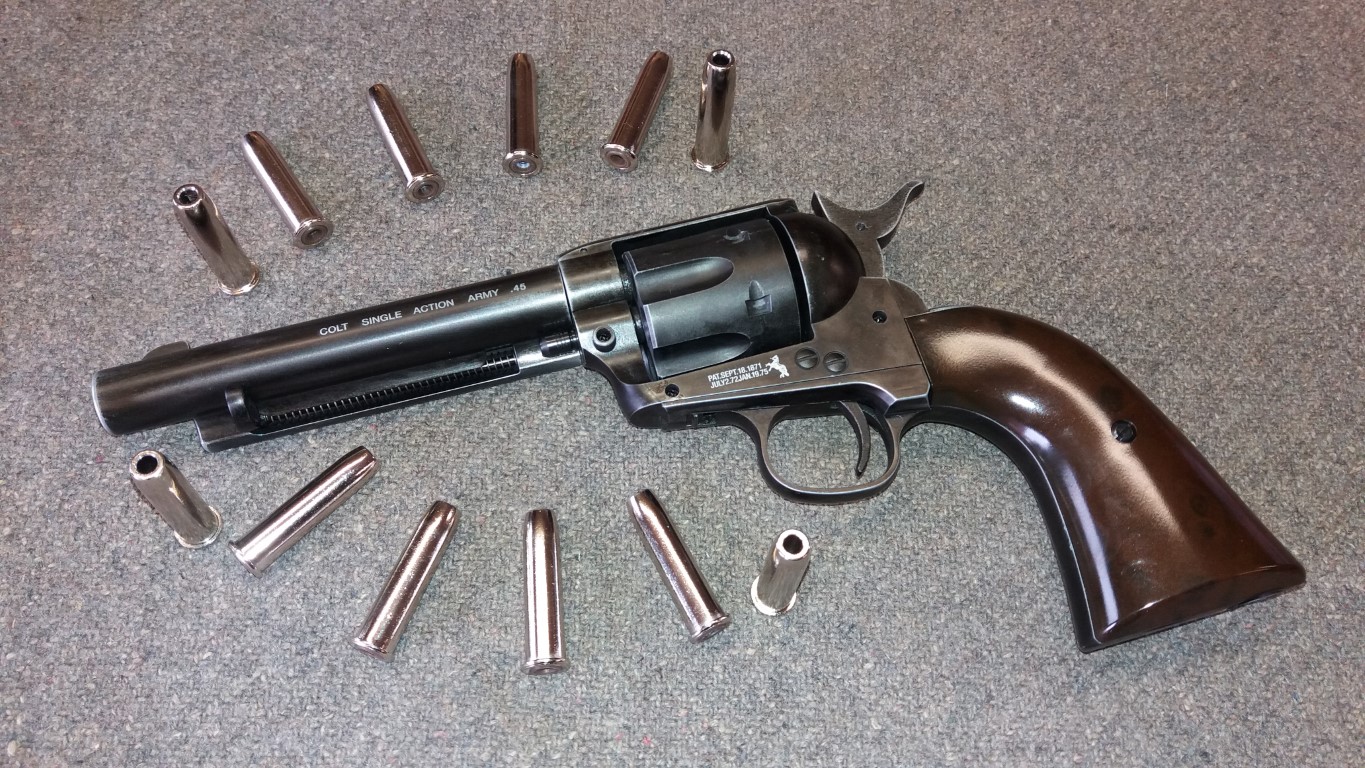

    I'm using this little beaut,
    .177 co2 powered, packs quite a punch, loads and fires just like the real thing, great fun to use.
    I sold my rifles years ago, used to shoot regularly for a local club but gave it up when kids turned up, my wife hates guns so it was anything for a quiet life at the time.

    Yes off ticket, just need to provide ID and buy it face to face at a registered firearms dealer, this is a Umarex, nothing like the quality of a Brocock but still pretty good, I'm going to treat myself to the colt python 357 magnum next, I like revolvers :)

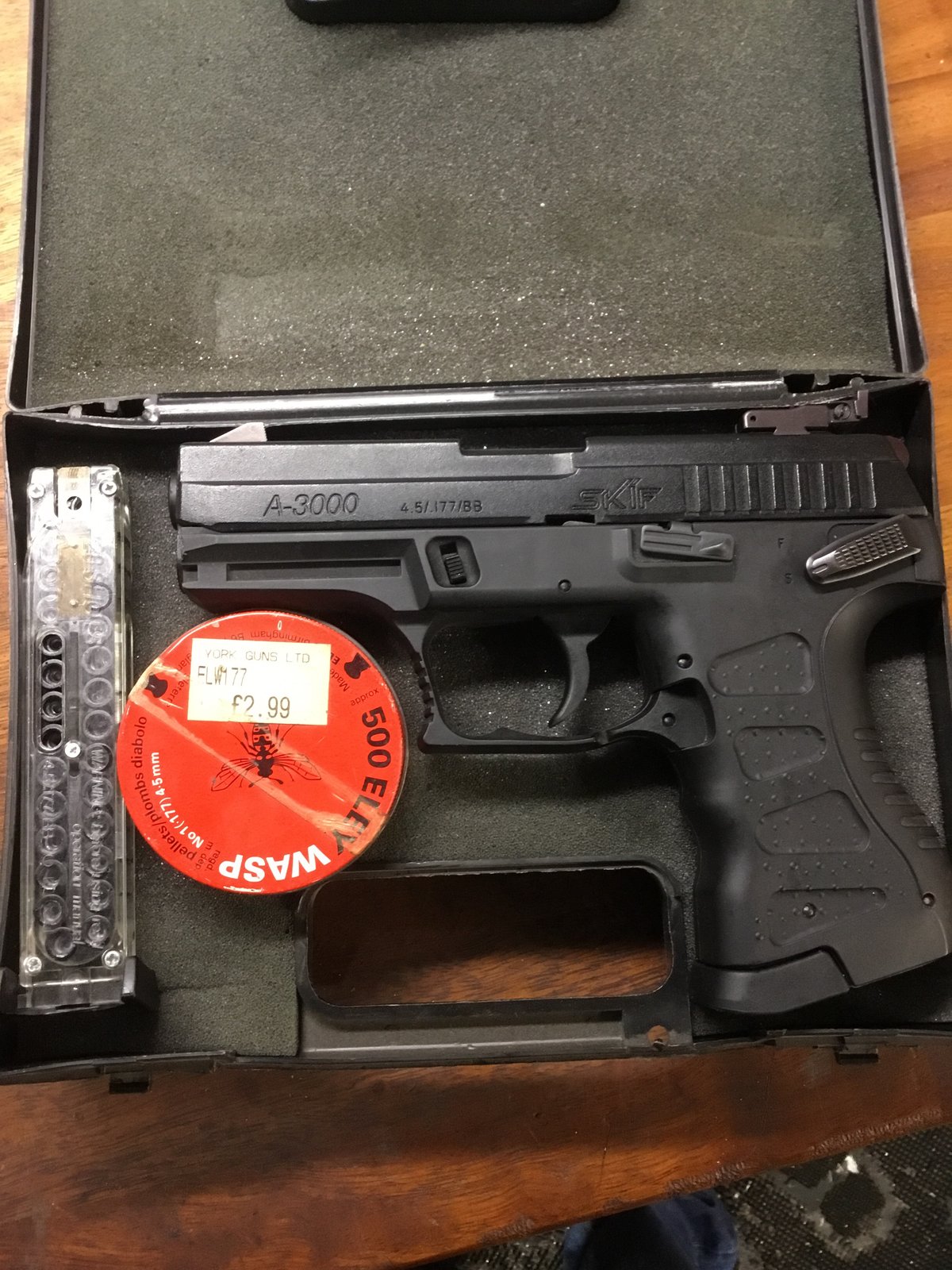

    Very nice. How/what/where? pellet and CO2.
    I’ve had a SKIF for the last 30yrs, 28 shot mag is very handy. Very accurate as well. Doesnt get used much, as can be seen by the cost of the pellets
