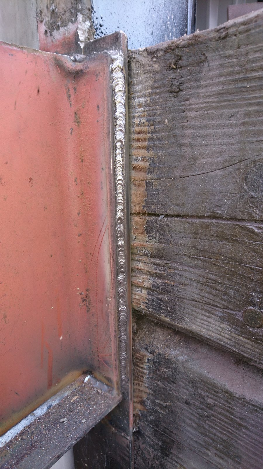

Yeah they aint really that different its just a flux composition? Do exactly what tge 10 does (which i also keep in 2.5) these came super cheap as a miss order from my supplier who ordered the wrong size for a sheet pile company client Of hisI tend to prefer 10 series rod for pipes and high penetration .
But I like to run 7018
I got my pack of 6010 rods from a friend which I did a repair.Yeah they aint really that different its just a flux composition? Do exactly what tge 10 does (which i also keep in 2.5) these came super cheap as a miss order from my supplier who ordered the wrong size for a sheet pile company client Of his
Another great thing is they are ok kept open in the shop in soggy Bowland
