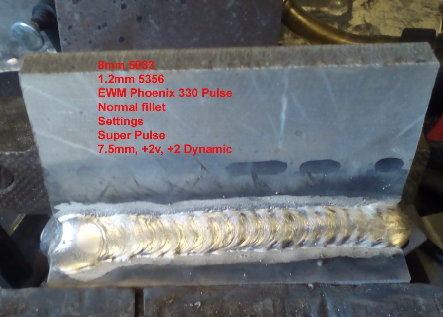

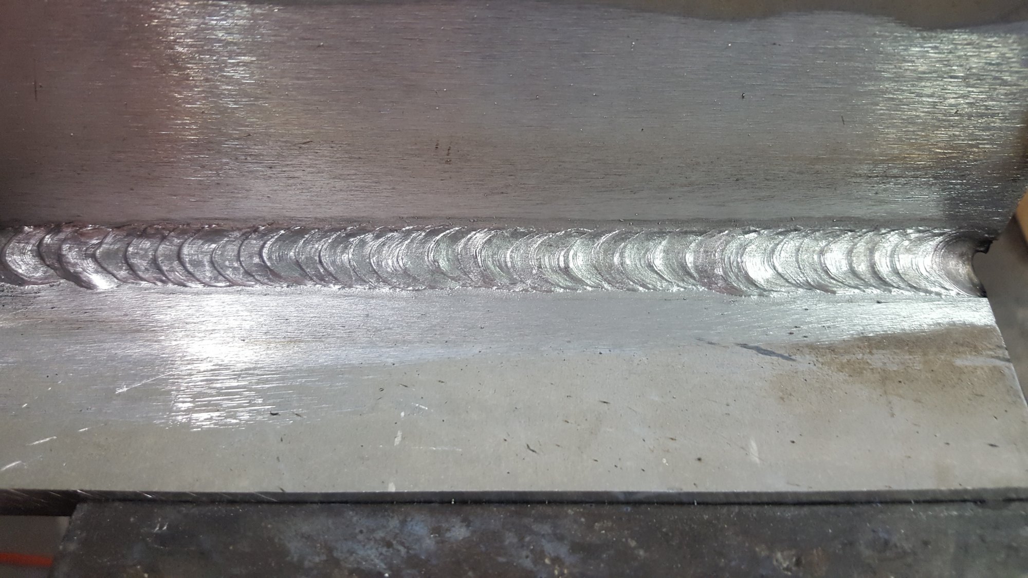

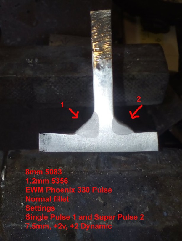

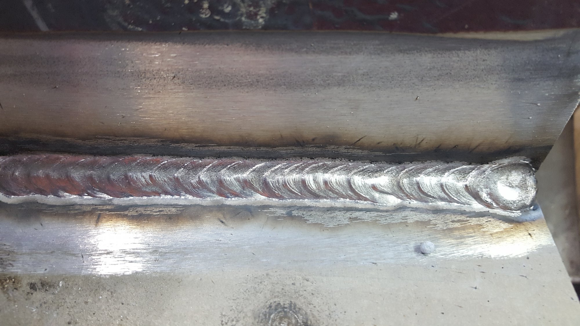

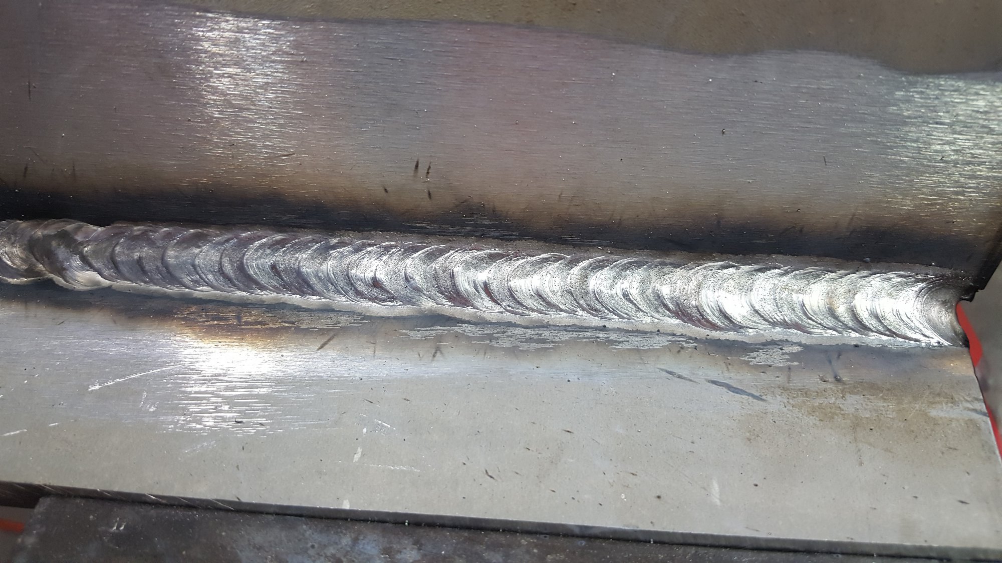

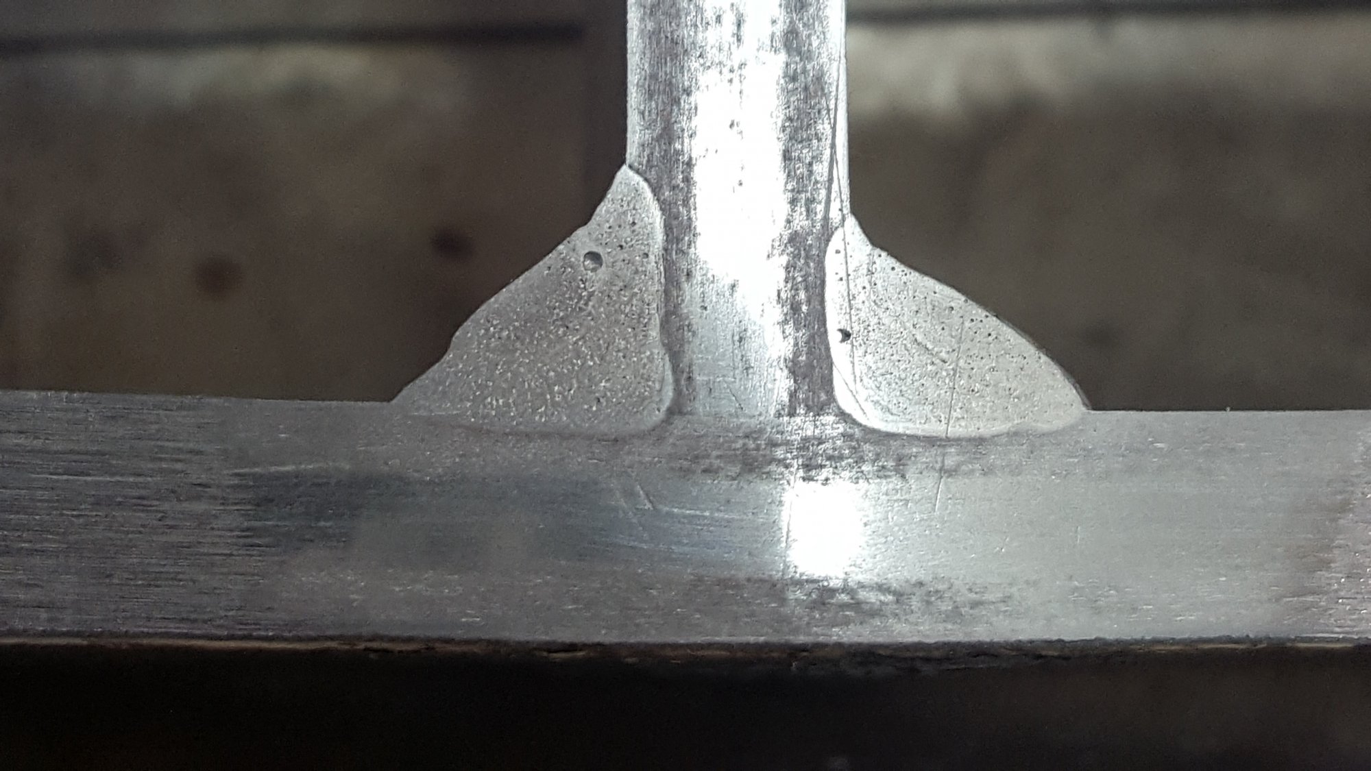

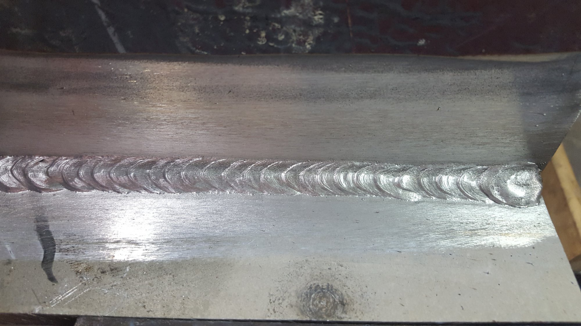

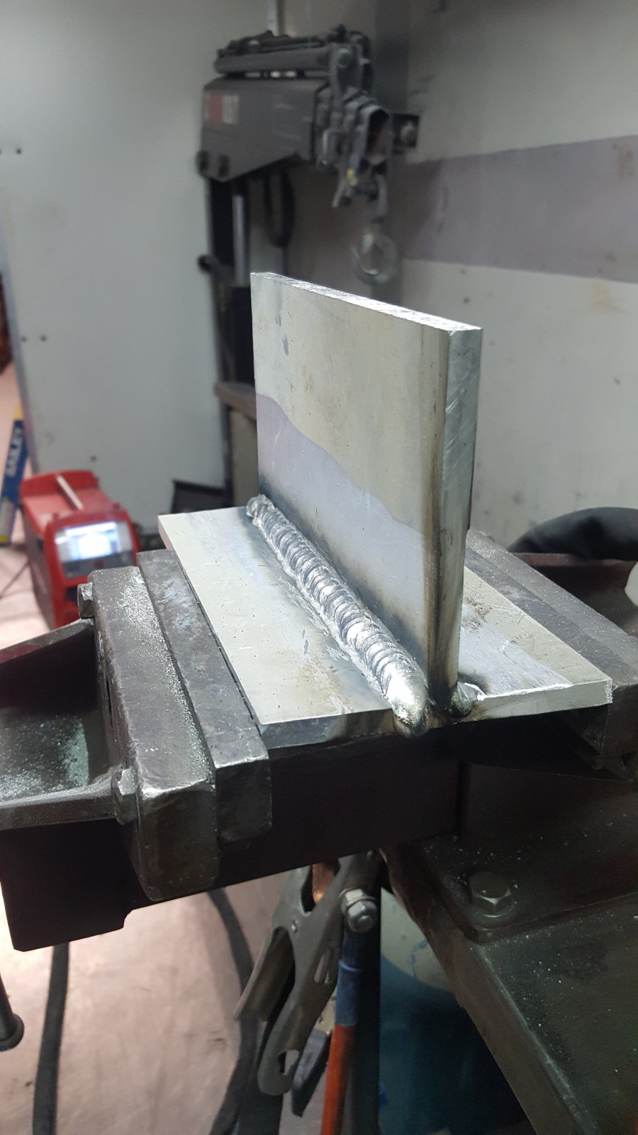

I started off using 1mm wire and was getting on well but decided to change to 1.2mm and see what it was like.
Well for the heavier stuff, 10mm and up it was fine but in single pulse but on the thinner stuff I much preferred the 1mm.
The 1.2mm is welding fine enough but I am getting what I would call crackling of the arc, not full on spatter but certainly not all spray like I could get with the 1mm.
Looked in the parameters today for both 1mm and 1.2mm and will have a play around with them hopefully this week but to me it seems too much wire feed and not enough voltage with the 1.2mm wire. Hot start was very hot so turned that down a bit and that made a difference, time will tell but at the moment I am thinking of going back to 1mm.
