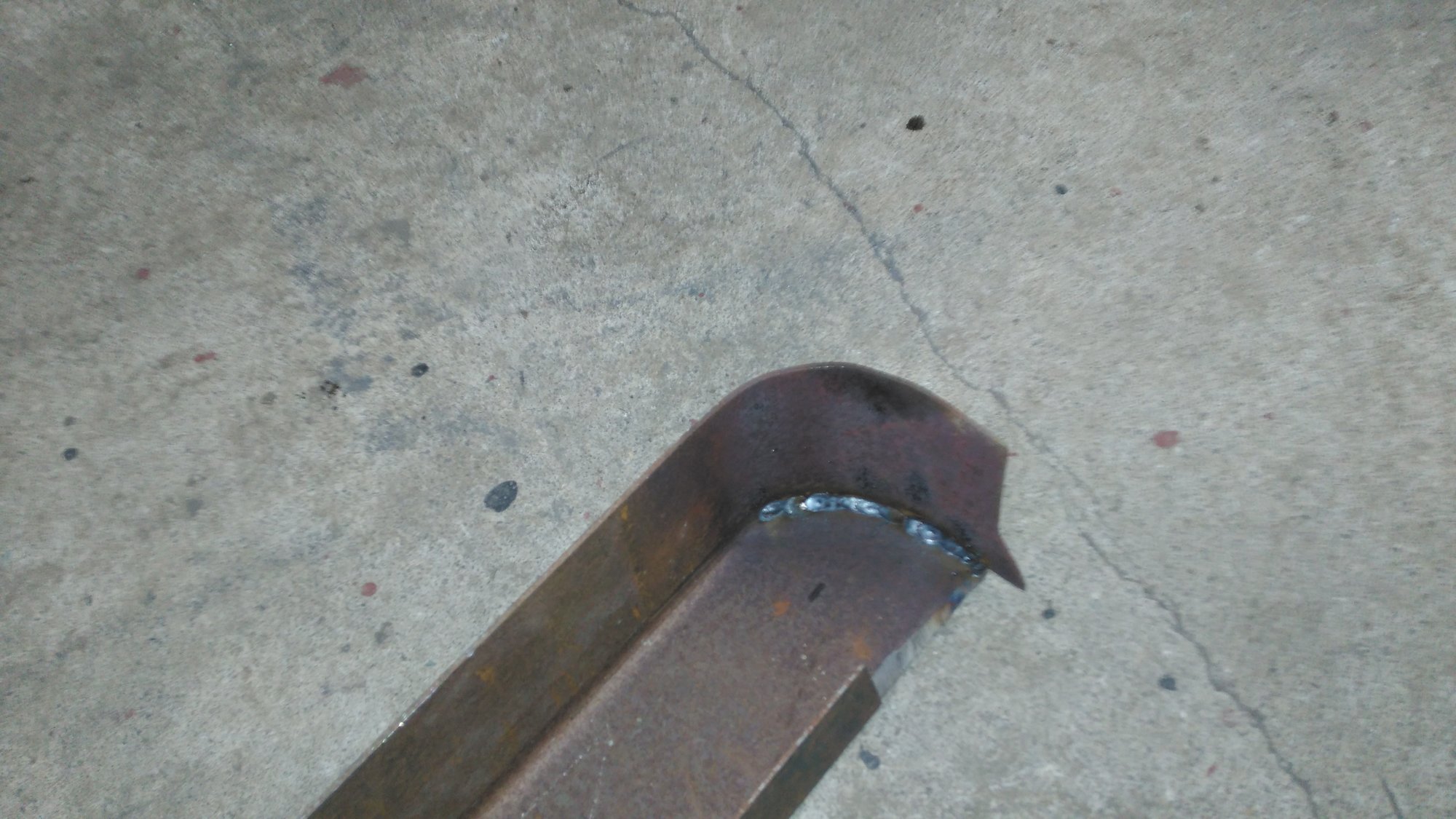

  9. smashweld Member
    Messages:
    403
    Location:
    Central Scotland
    that makes sense...it would have been the tungsten touching the filler!
    being easily dented isn't something I had really thought about, worth considering.
    I want to get some sheet folded, then cut and shape the end like this...would 3mm 5083 be easy enough to form?
  10. Richard.
    Richard. Member
    Messages:
    16,129
    Location:
    Cambridgeshire
    Yes you can form 5083 but usually you get one shot and tight radius’s will crack with out first heat treatment.
    What you show above might probably be ok but I wouldn’t go tighter. It will take some force to bend 5083 3mm gage like that.
    3mm 1050 isn’t going to dent and fail without a considerable amount of force. We are worried about nothing here. It’s not cardboard. I don’t see why either grade at a reduced 2mm gage would not be suited to do what you show in the pic.
  11. Hood
    Hood Forum Supporter
    Messages:
    6,213
    Location:
    Carnoustie, Scotland
    I agree, if it is a small section like that then 1050 would likely be fine and much much easier to bend.

  13. Richard.
    Richard. Member
    Messages:
    16,129
    Location:
    Cambridgeshire
    Don’t forget your bend allowance. You won’t get 125 if you bend 250 down the middle.
    If your bend is gonna be sharp 5*** grade alu will crack unless you anneal it first.
    smashweld likes this.
