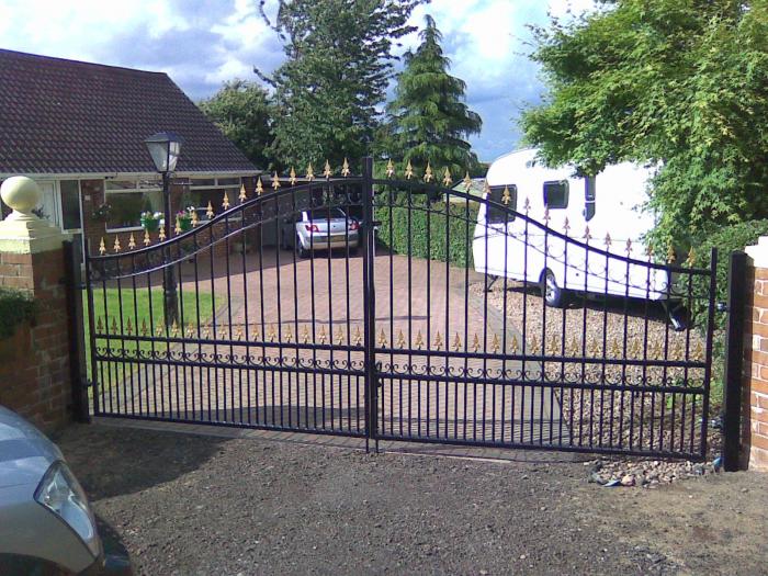

Another set of gates.
Galvanisers/Powdercoaters did us proud again.
Cut the shrink wrap off when we got to the job - Railheads bent, one scroll missing so a 40 mile round trip to fetch another one to weld back in. After it had been galved they never bothered their arses to fettle it/run the flap disc over - just powdercoated over all the crap.
They had gassed blow holes through the box section - We had drilled the box as we normally do - plenty in to allow gasses to vent and galv to drain. Want to charge me a pound a hole. Suggested they put their pound a hole up their hole.
Nice one lads - top job.
Because they can't be trusted to do their job, now we have to send the stuff to be galved, bring it back to fettle it and send it back again to be powdercoated. The place is just full of lazy chavs. Time to find another place.
