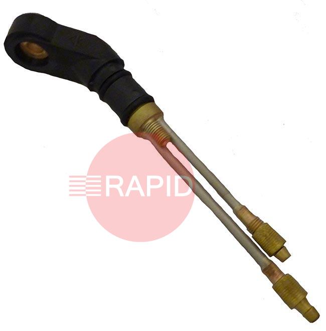

Oh dear.FlexLoc appears to have a male thread as well....
It doesn’t matter what the thread is. You just need the right product. Don’t worry about what people say or finding something to blame it on just concentrate on getting it fixed.Some conflicting infomation though.
Some say the thread on the power line is propriety, so Metric threads. But others indicate its a 7/8” x 14 left-hand threaded

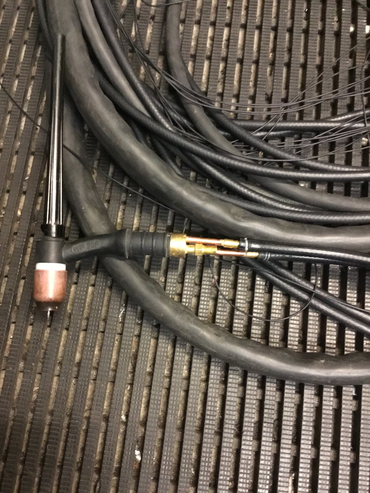

45V03SF is the power line i need to use the generic common thread used on most torches.
I think spending the money on the power line now so i can use and stock the cheaper torches would be my best option. My machine maxes at 210amps, so the 300 torch/ cable no use to me.
They all look the same.That head looks the same as my kemppi as it happens.
How you getting on with the ihead mate.Same power hose I've used on the I-head 20, Weldcraft wp20 and the Binzel SR20, good quality hose.
