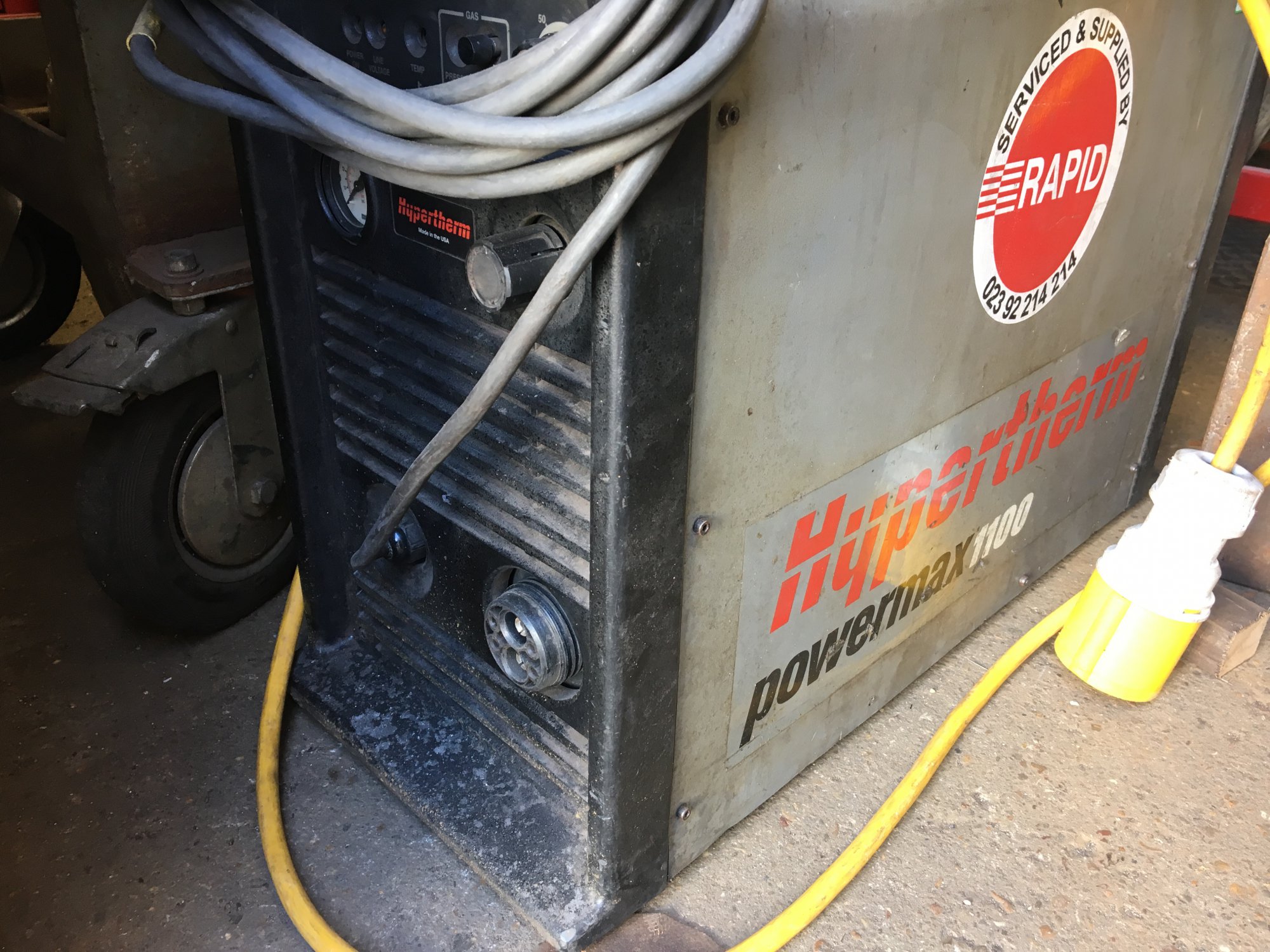

P phmadeira New Member Messages 2 Location France May 22, 2017 #1 Hello Just get an 1100 hypertherm powermax without worklead and worklead connector Where do i have to connect the cable thank you
Jim Davey R H Davey Welding Supplies Ltd Messages 5,736 Location Southampton May 22, 2017 #2 You men the earth lead or the plasma torch? The earth lead usually is wired directly to a terminal inside the set, behind the front panel. Like so.
