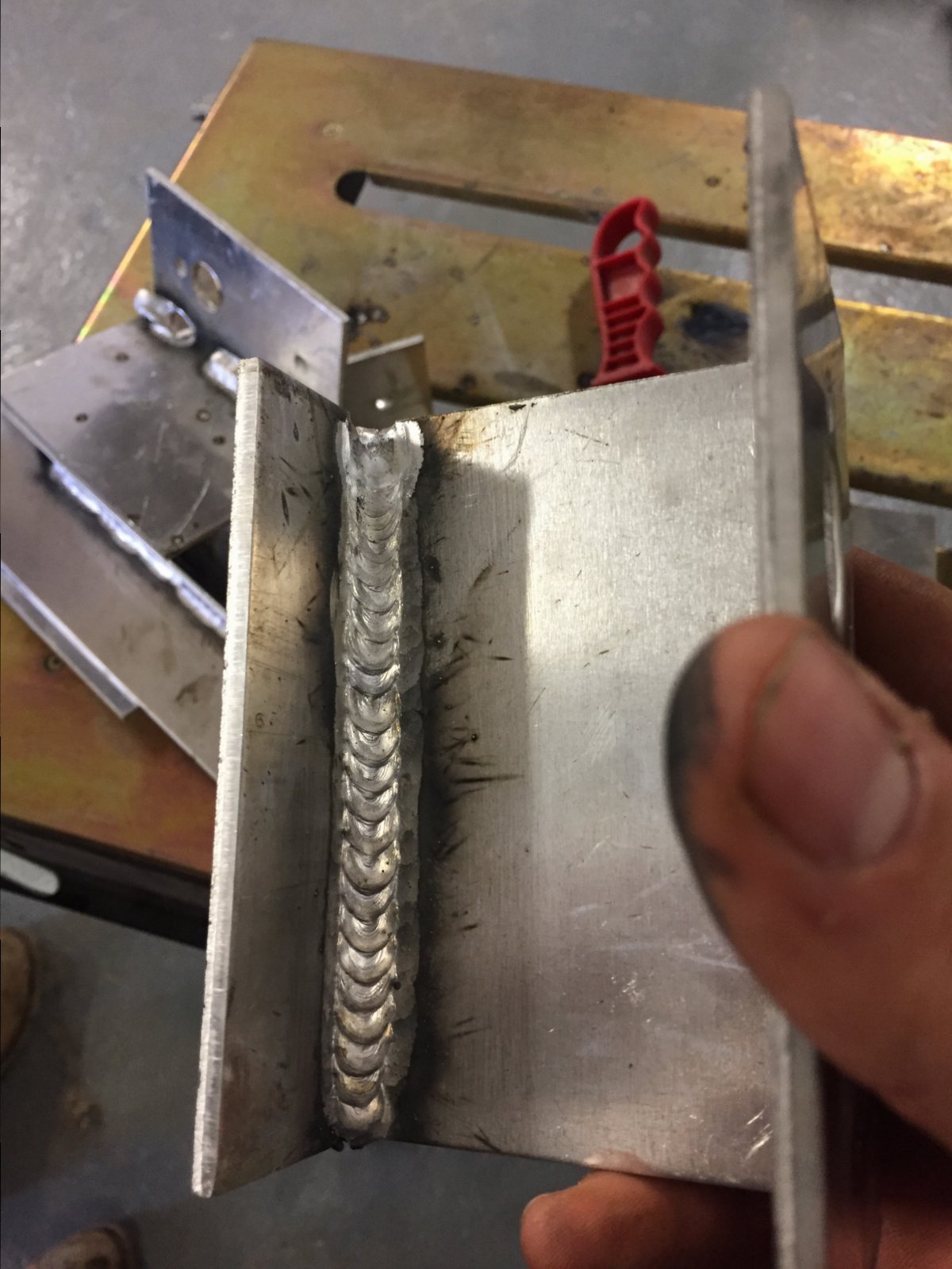

If its a totally different process, why doesnt it have a different name?Don't forget this is synergic pulsed MIG which is a totally different process to standard MIG and bearing that in mind I have to say I thought the welds look dog rough

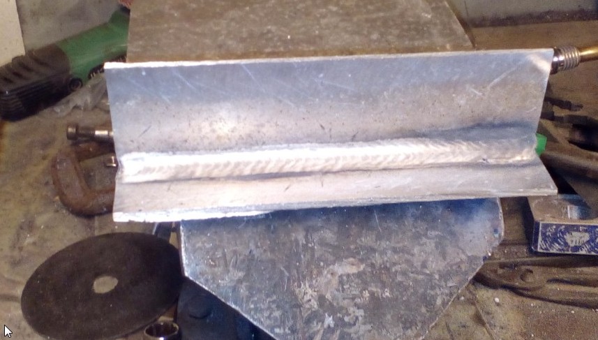

Also, what does a good MIG alu weld look like?

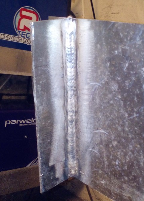

As Richard says it does, Pulsed MIG and the welds deposited can look similar to TIG welds when done right, the welds in the video look cold, inconsistent and one even had a crater crack in it.If its a totally different process, why doesnt it have a different name?
Throw a double pulse in the background and that's on another level again.As Richard says it does, Pulsed MIG and the welds deposited can look similar to TIG welds when done right, the welds in the video look cold, inconsistent and one even had a crater crack in it.
