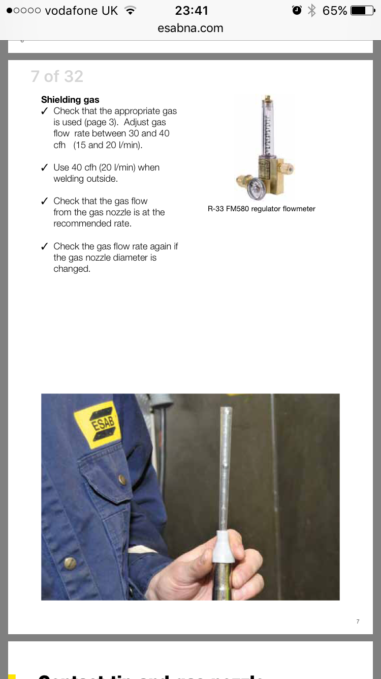

Hi, need to do some welding on a farm trailer, and i have been looking into gas shielded flux core welding.
I managed to get some Safdual 128v wire but unfortunatly it need 75/25 gas and i only have 100% CO2, so its no good.
Can anyone recommened a good duelshield wire that will work with 100% CO2?
Thanks
