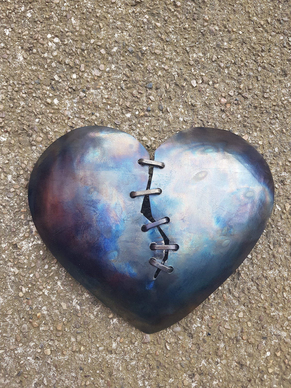

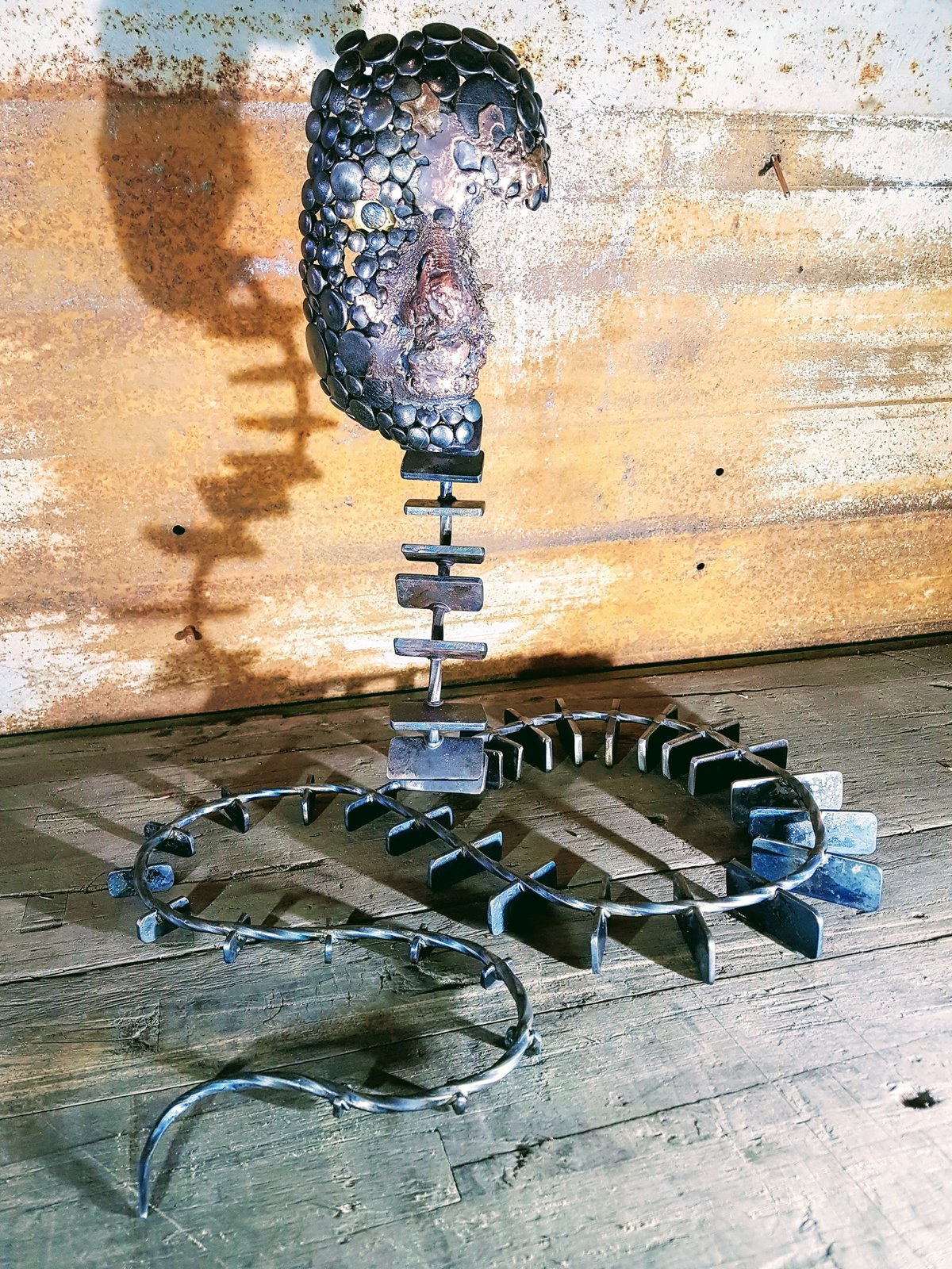

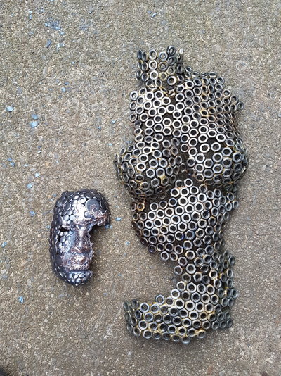

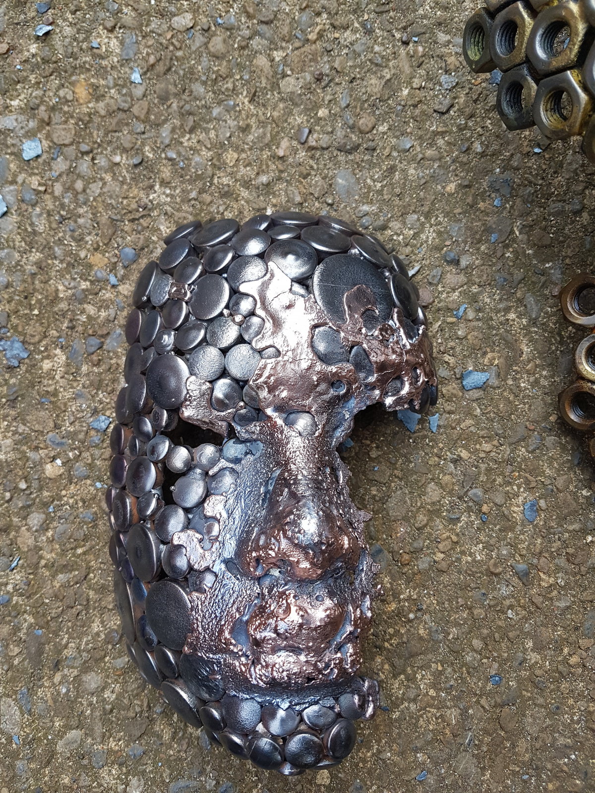

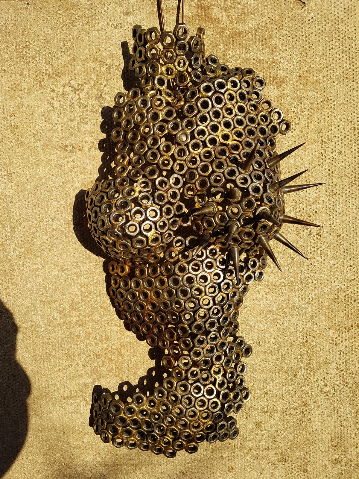

I've taken on a stall at Tattoo Jam in August so i'm spending all my spare time making more bits and pieces to sell. I made these this weekend (i've actually made 2 of the hearts and another 6 have been shaped) The body is made from m10 nuts which I brazed together with them being galved. The face needs a bit of tidying, I got a bit giddy pouring the lips and nose and got more on than I needed some of which I like but the eye socket definitely needs sorting. The lips and nose are made from some old copper pipe melted down with a small amount of aluminium and borax added to the molten copper, which makes it look a bit like bronze.
