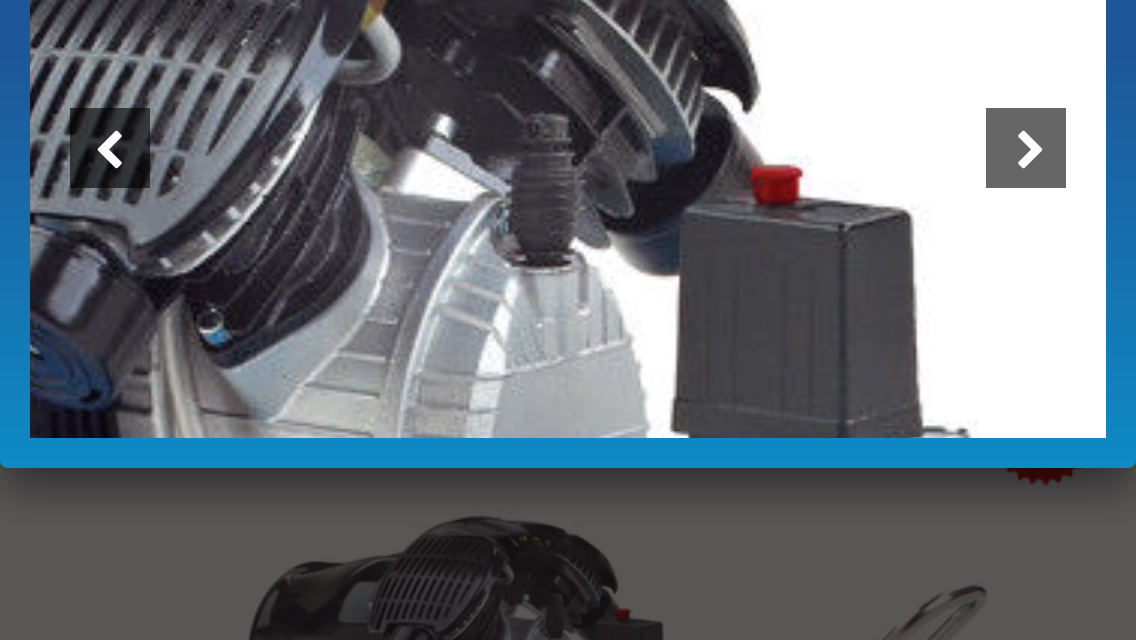

Jlg Member Messages 2,540 Location Cumbria Jan 30, 2018 #1 can anyone tell me what the black bit is called on the compressors where you put the oil I nocked mine and lost part of it and the little ball that is in it

rtbcomp Moderator Messages 18,575 Location Sheffield UK Jan 30, 2018 #4 Sounds like the breather/filler.

Jlg Member Messages 2,540 Location Cumbria Jan 30, 2018 #6 This is what it should have looked like before I broke it
K knighty Member Messages 3,308 Location Sunderland Jan 30, 2018 #7 yeah, it's a breather look on ebay, you'll probably find hundreds of them for pennies from china?
Jlg Member Messages 2,540 Location Cumbria Feb 1, 2018 #8 Don't suppose anyone can post a link to one of these I can't find any the same
K knighty Member Messages 3,308 Location Sunderland Feb 1, 2018 #9 https://www.ebay.co.uk/sch/i.html?_from=R40&_trksid=m570.l1313&_nkw=compresor+breather&_sacat=0 you just need one with the same thread to match yours doesn't really matter how it looks, they all do the same job I'd *guess* the thread will be either 1/4 bsp or 3/8 bsp (just because most things like these are)
