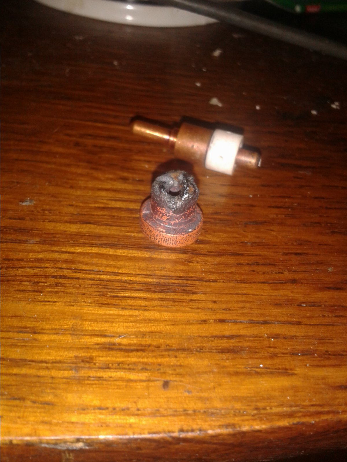

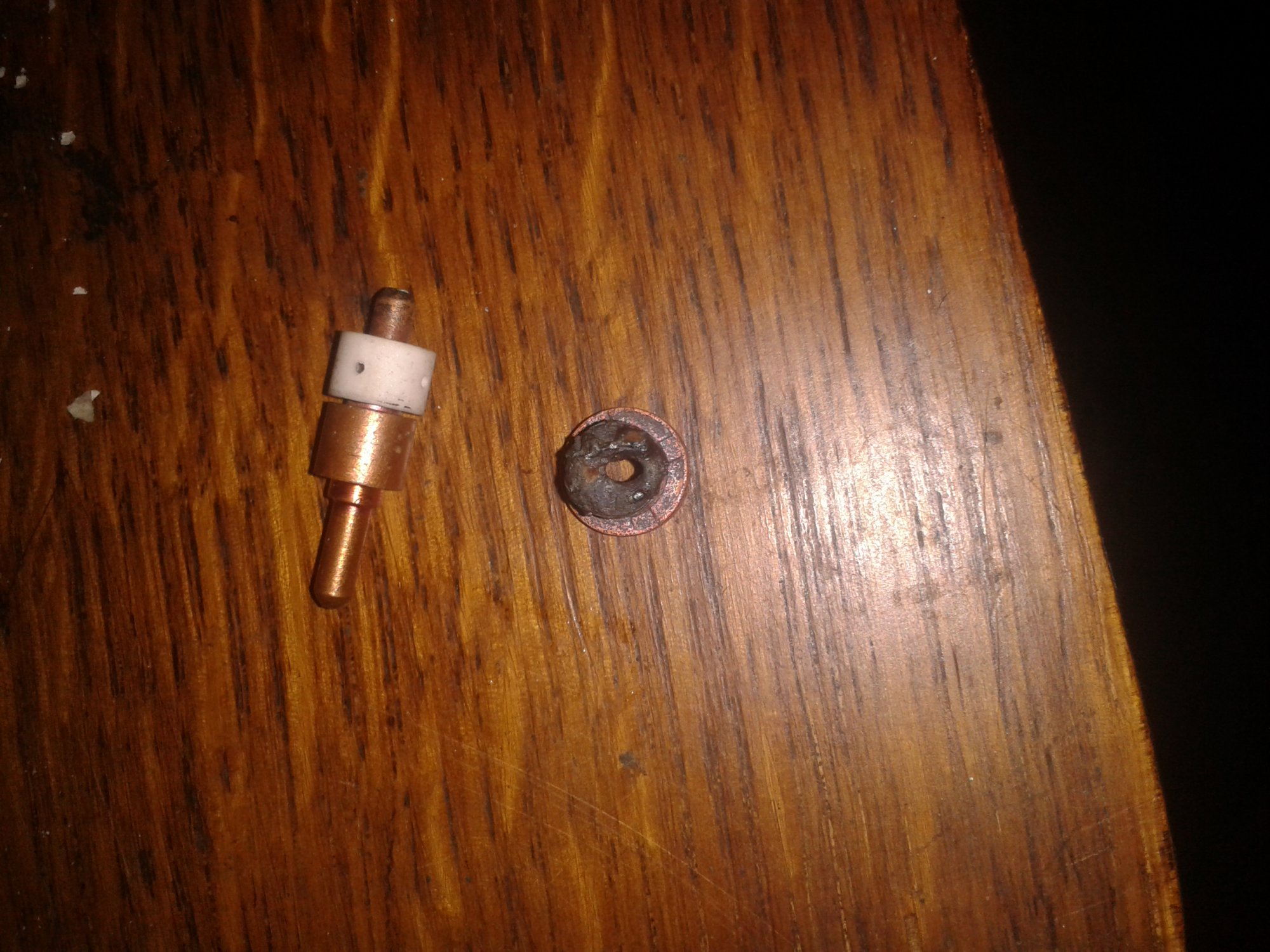

Mate asked me to give him a hand cutting the rocksliders off the side of his truck so I popped round with the plasma cutter, compressor, hoses, etc.
Fired the compressor up on his 13A aocket and let it fill up as I didn't want the plasma and compressor vying for the same 13A. Eventually it filled up so I tried to get started - bright lights and molten metal piling up on sliders.
Foolishly, I turned the amps up thinking it was a problem with all the rust on the sliders and the plasma tip melted!
So I ignored Albert Einstein...
...replaced the tip and cup and tried again - same result.
That's when I realised there was no sound of air coming out of the gun. I hadn't connected the hose from the compressor to the cutter
In other news, as long as we didn't have the compressor on, the cutter went up to an indicated 40A on the 13A plug. The one time we forgot to turn the compressor off after it re-filled it blew the fuse when it kicked in while the cutter was on.
Success eventually - pity I never took any pictures of the plasma tips / arc rods before I binned them
