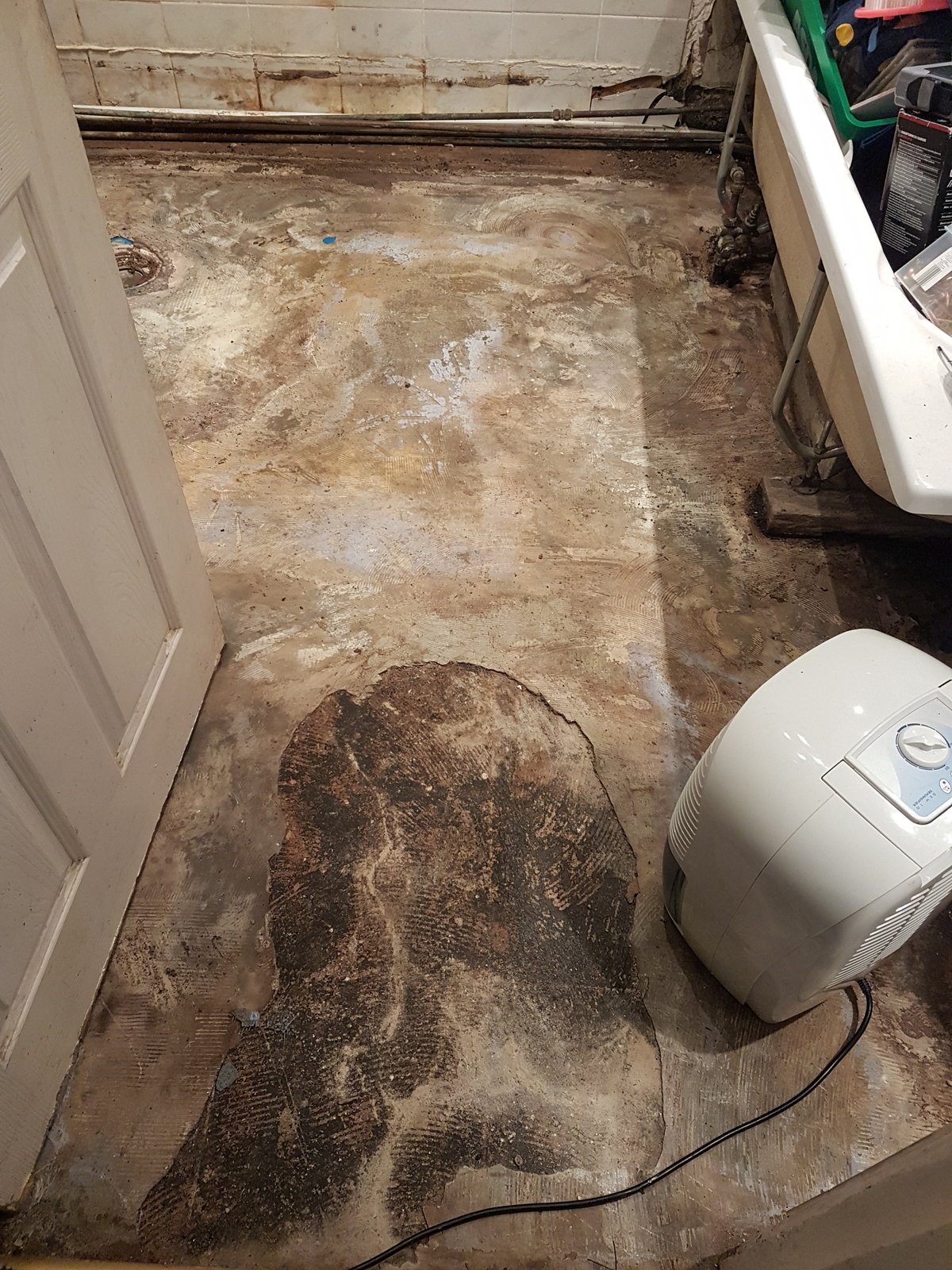

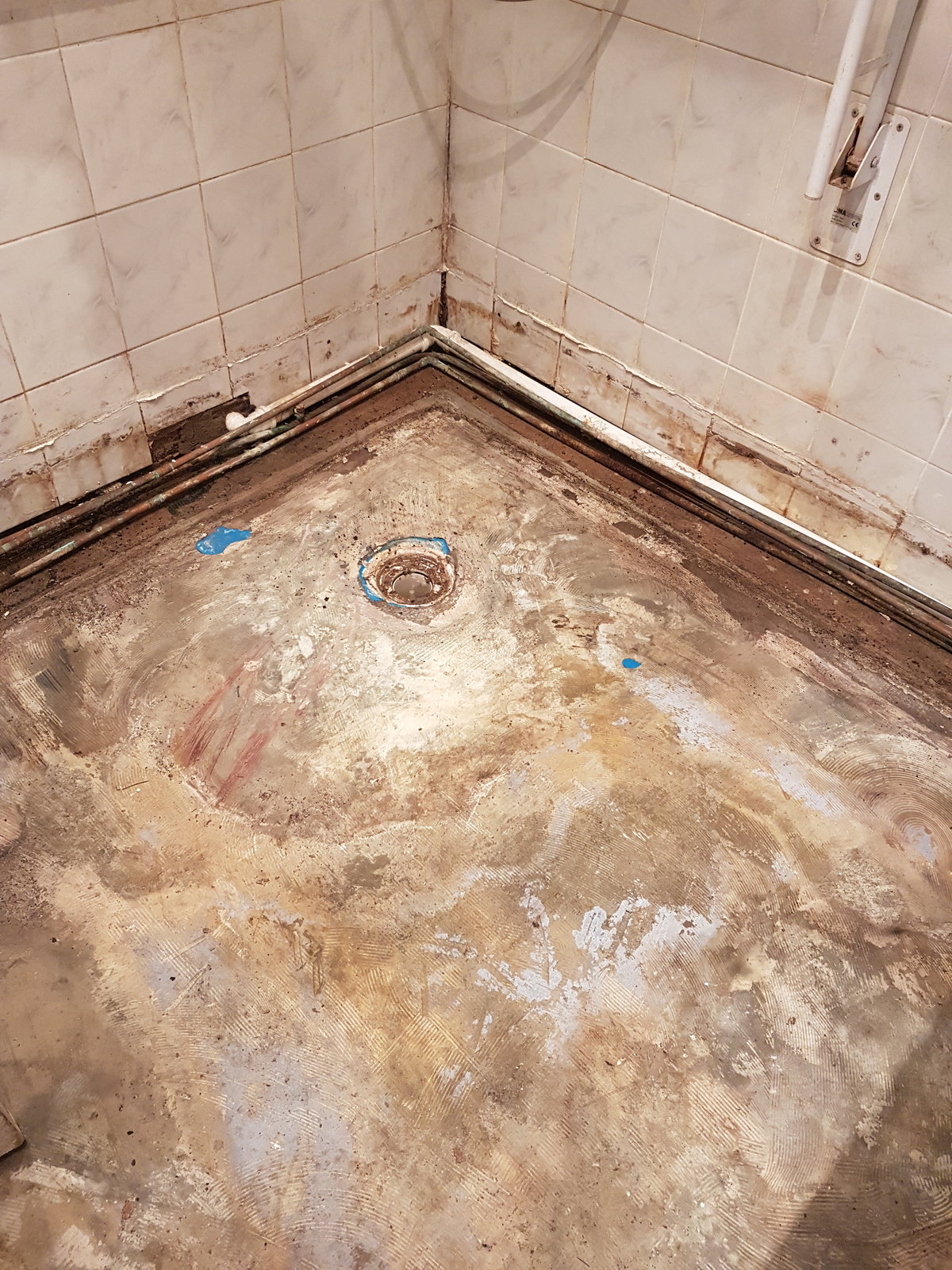

17 years ago i had a wetroom floor fitted and within a few weeks it blew underneath creating a line. That line got worse over time and burst through like. Tree root in a pavement.
It was not in a wet part so we just got used to it being there.
Anyway today i took the floor up and found the problem so i need to make that part of the floor good but would like to skim the complete floor.

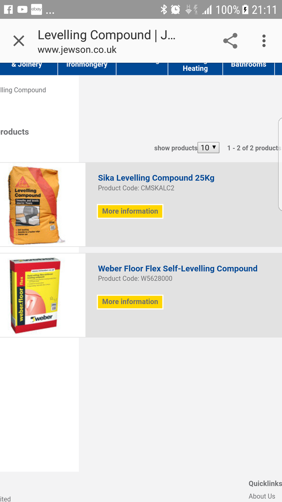

My question is what do they use to create a solid surface under safety flooring. Self levelling stuff might be ok but i would like to add a bit more fall by raising the floor slightly and ramping a few mill towards the drain.
