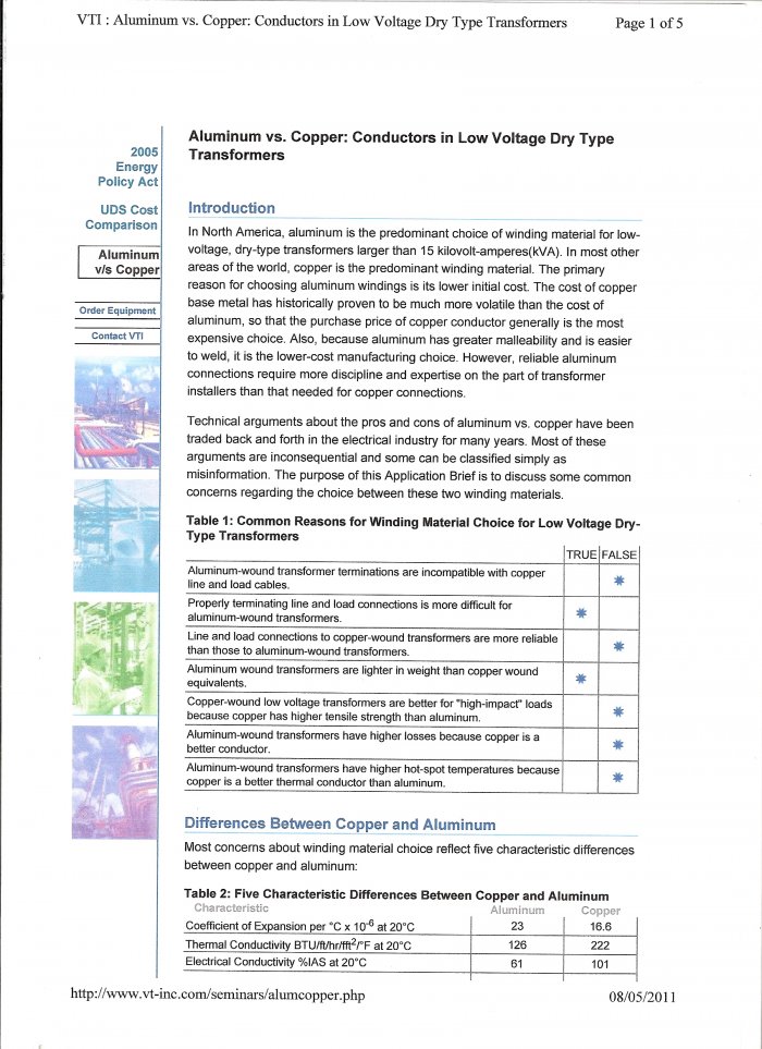

a question why do u need a set with copper windings .Its very very easy to weld thin sheet materials, as well as things like exhausts with a MIG set. You need a good quality set with copper windings, and ideally a wire pulse feature. Pretty often things like Murex Tradesmigs come up on Ebay, and these have copper windings, and most also have wire pulse.
because aluminium windings are in short rubbish.
ali is used on cheep sets because it's cheeper than copper and you can make a transformer out of it, just not a very good one
