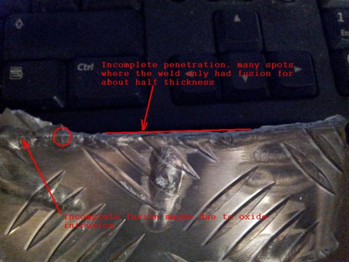

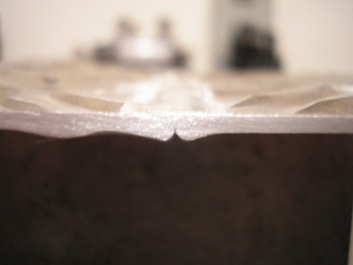

ok welded some aluminium today does this look right as to penetration its
3mm checker plate at 125amps 2.4mm tungsten and a 1.6mm 4043 filler rod and gas at 7ltr.
it was just but joint no chamfer. I broke it off while still hot.
