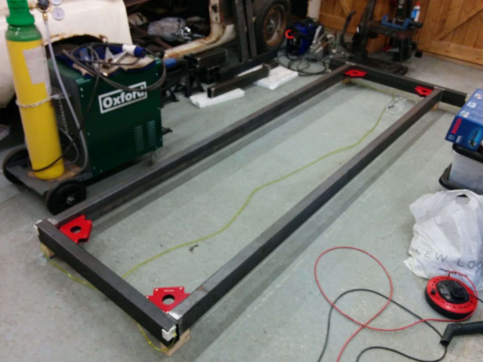

You could be overthinking this. Use fishing line to get it square and long site levels to get it flat, throw in a bit of patience too of course. You'll get it as flat as it needs to be.
