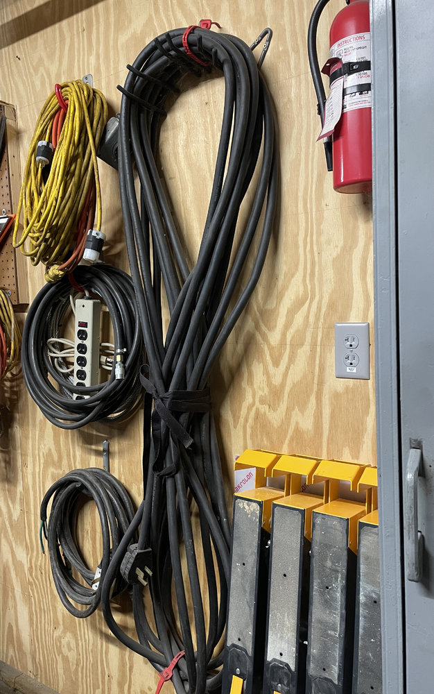

just a rough guide 6.0mm extension cable will get you about 3kw at over a quid a meter thats 90 quid
Google says your wrong.I have 50m of 5g6, I can then attach to 25m of 5g2.5 this gets me out of most problems.
Yawn, works for me.Google says your wrong.
That's the truth, killed a few myself.To the OP, from painful experience, if you do go the extension cable route, make sure it is fully un wound and in nice lazy loops on the floor. it gets REALLY hot when your welding and if its on a roll, its likely get all toasty and warm & melt/burn and make a right mess and blow the fuse/trip box.
