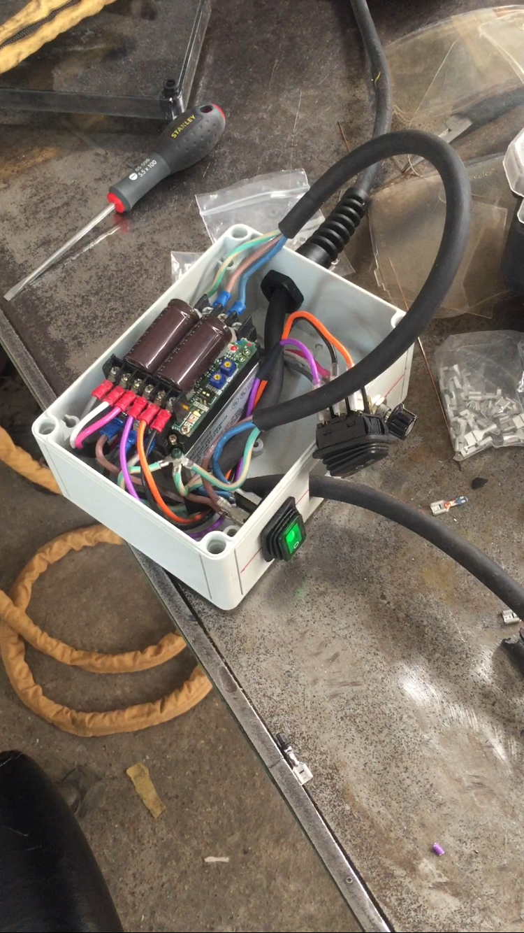

Wow! that's tiny...

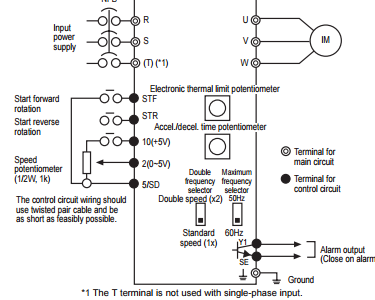

I stand corrected This diagram does show the correct way to connect the pot, i.e. all three legs. It should be 1kOhm and linear, as has already been said.
