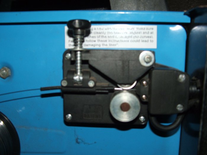

I have feed the wire through into the gun and now i am having trouble with the wire coming out of the tip. It will feed thru if you pull lightly on the wire but if you let go it stops, it acts like its in the gun itself? I don't know and i am sorry that i don't know the termenology. Please help!!!
it slips but i have tried adjusting the tension and it will just stop if you put alot of tension on it. But it acts like it hanging up on something in the torch. I have a new tip in the gun. But if you pull ever so slightly while pulling the trigger it works good.
I may need a new swan neck liner (the spring behind the contact tip.)
The older Clarkes also had an issue with the tenioner pivot flexing, causing the wire to slip.
What size wire? Do you have it on the right groove on the roller? If I remeber right, the Clarkes have 0.6 and 0.8 stamped on the roller; I think you have to have the correct size on the inside. 0.6mm (0.025 wire) will be the thinner groove.
Ok i was thinking that liner might be the problem. I am running a .8mm flux core wire and i tried both grooves and i have it on the smaller of the two grooves which seems to work better, i looked for a mark on the size of groove but didn't see anything. What do you suppose is going on with the swan neck liner? Something caught it in or do they just go out over time?
They get gummed up with shavings from the wire. Also if you overheat the torch, the spring can distort.
You will need to try and clean it out. Remove the contact tip and wire and use compressed air to blow out the liner from the gun end. That may help. Also old wire that is correded will clog up the liner/neck in no time.
You should be using the larger groove on the roller. Make sure the pinch roller is square to the main roller. It is common for the pivot to flex and the top roller get a bit of an angle. The only thing t etip roller should touch is the wire, if the two rollers are meeting on one edge, then you will lose tension.
Checking/replacing the swan neck liner involves taking the torch apart, removing the liner (8mm nut) an pulling ut the spring. It should not have any kinks in it.
Is the existing liner plastic or steel? If it is plastic, you probably have plastic shavings in the swan neck liner.
ok i will try blowing out the liner, thank you for the information. The liner going from the welder to the gun is plastic but the liner in the swan neck is metal. What should i take a picture of?
