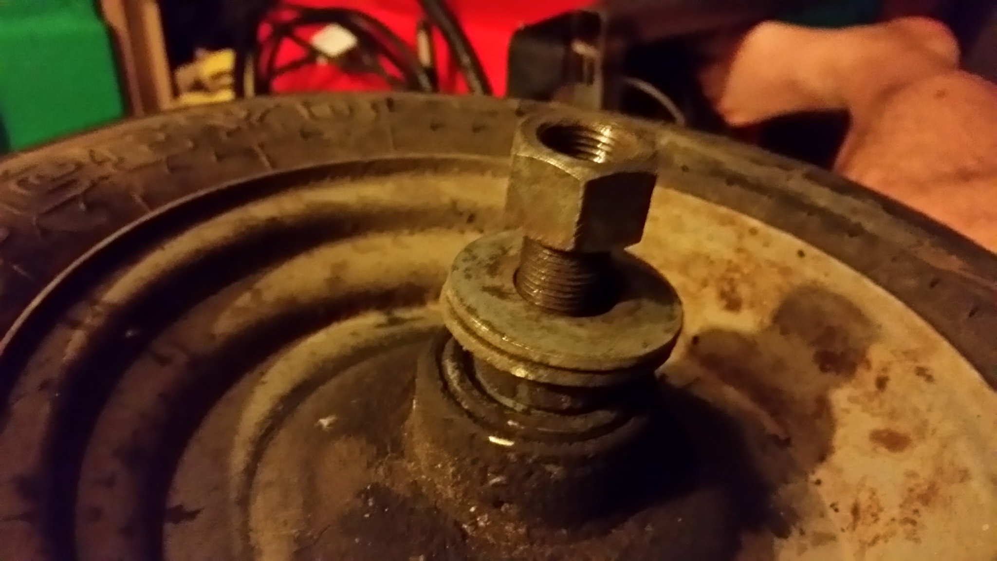

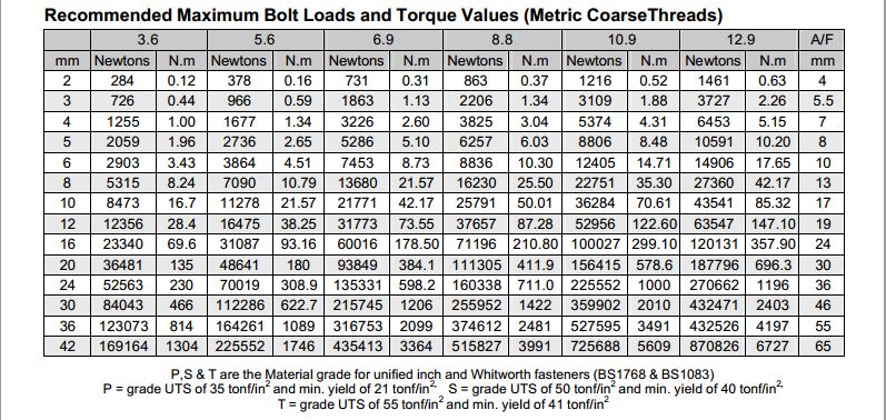

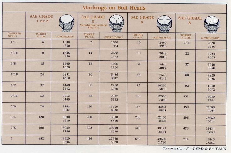

What torx setting would you apply to this nut to attach the wheels back on

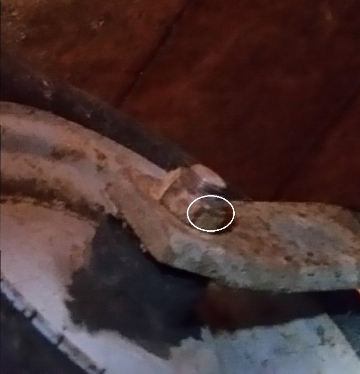

And 2nd question I have been able to remove one of them but the other is stuck fast any body got a way to remove it ??
One side was a quick hit with a hammer and dropped out the other side give a few good taps (wack) stuck fast with the nut most screwed on did not want to damage the the ad of the shafts
