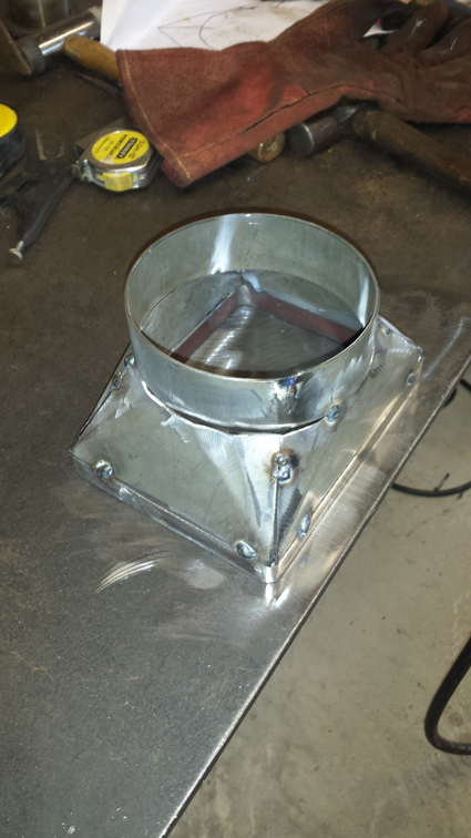

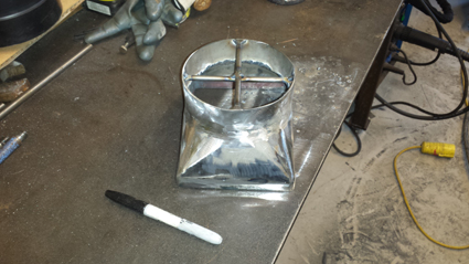

Cant believe the manufacturer only makes these ports in plastic for commercial machines....

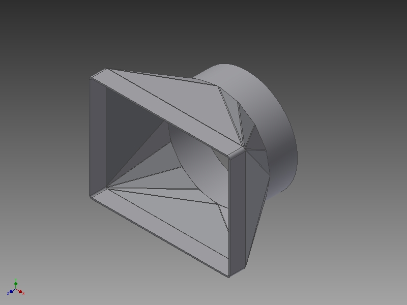

so as they want £50+ for a part we know will break 10 minutes after it is fitted and we will mess around for a couple of years fixing it, time to make a more permanent part

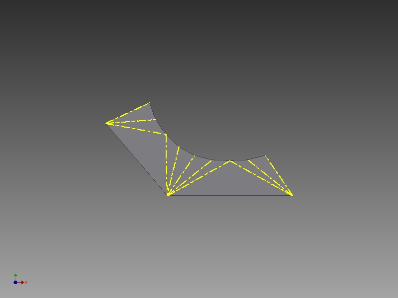

Shape for the lofted section, this is for half the shape, yellow lines are for the folds

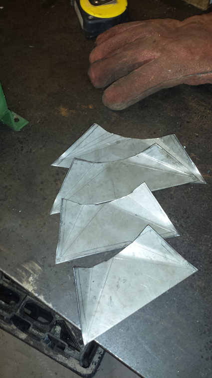

Decided it would be easier in 4 pieces.... that way if I made a mistake it was easy to correct, just make another one

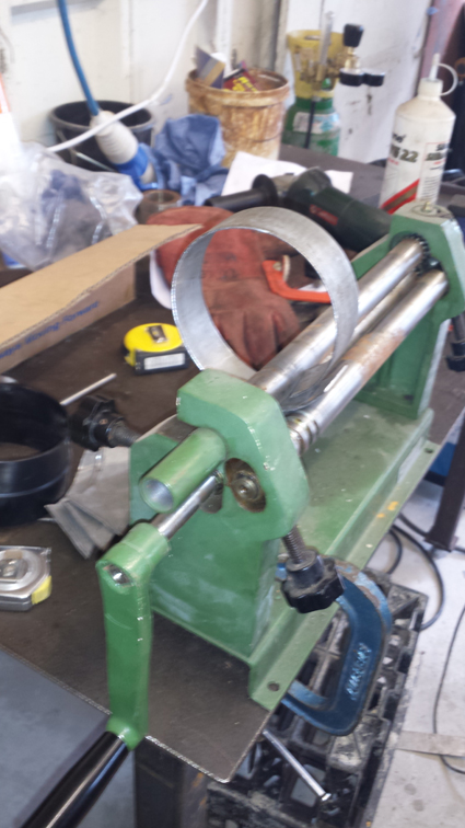

got to use my bargain Metalcraft bender for the first time on a job, so easy it was unbelieveable

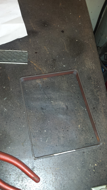

I could have added the this to the sides, but again thought keep it simple, bang on size, and square, took longer to mark and cut to length than to bend
